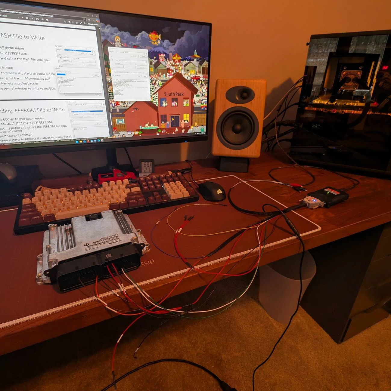

Jeep Gladiator ECU/PCM clone process & pricing PXL_20250117_220606736.NIGHT~2
Just cloned another one for a coworker, a stock unit. Start to finish, opening the hood, removing the ECM, copying, writing to the new one, testing the new one in the truck and reinstalling the original and backing down my driveway was an hour long process. Just to give an idea of the amount of time it takes if you're thinking about doing it yourself.
