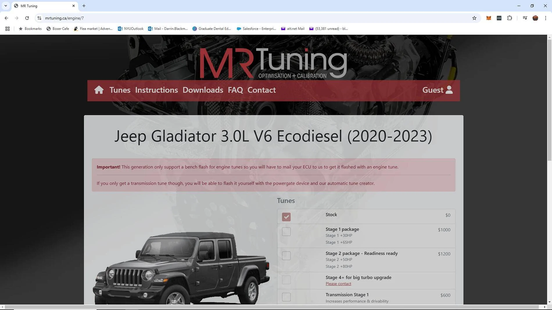

Right....but some want to keep a spare ecu with stock tune for going to dealership.....at least I do. Isn't this why we have 2 ECUs? This isn't the same as tuning a mustang with a tuner. Maybe I am not understanding this.
I understand you talked to EOC. MR Tuning still states you have to send ECM in to get flashed.....my understanding MR Tuning is EOC....am I wrong???? I guess maybe they have not updated their website.

Not sure about MR Tuning, but GDE will now allow you to switch from tuned to stock with the included device. Now, is that easier and/or quicker than switching out the ECU? Don't know, as it is a pain to reach up and unplug those cables every time you would want to do that.
BUT, seeing as how apparently now you can copy a tuned ECU (from GDE) it would be great to do that and have a spare on hand.
