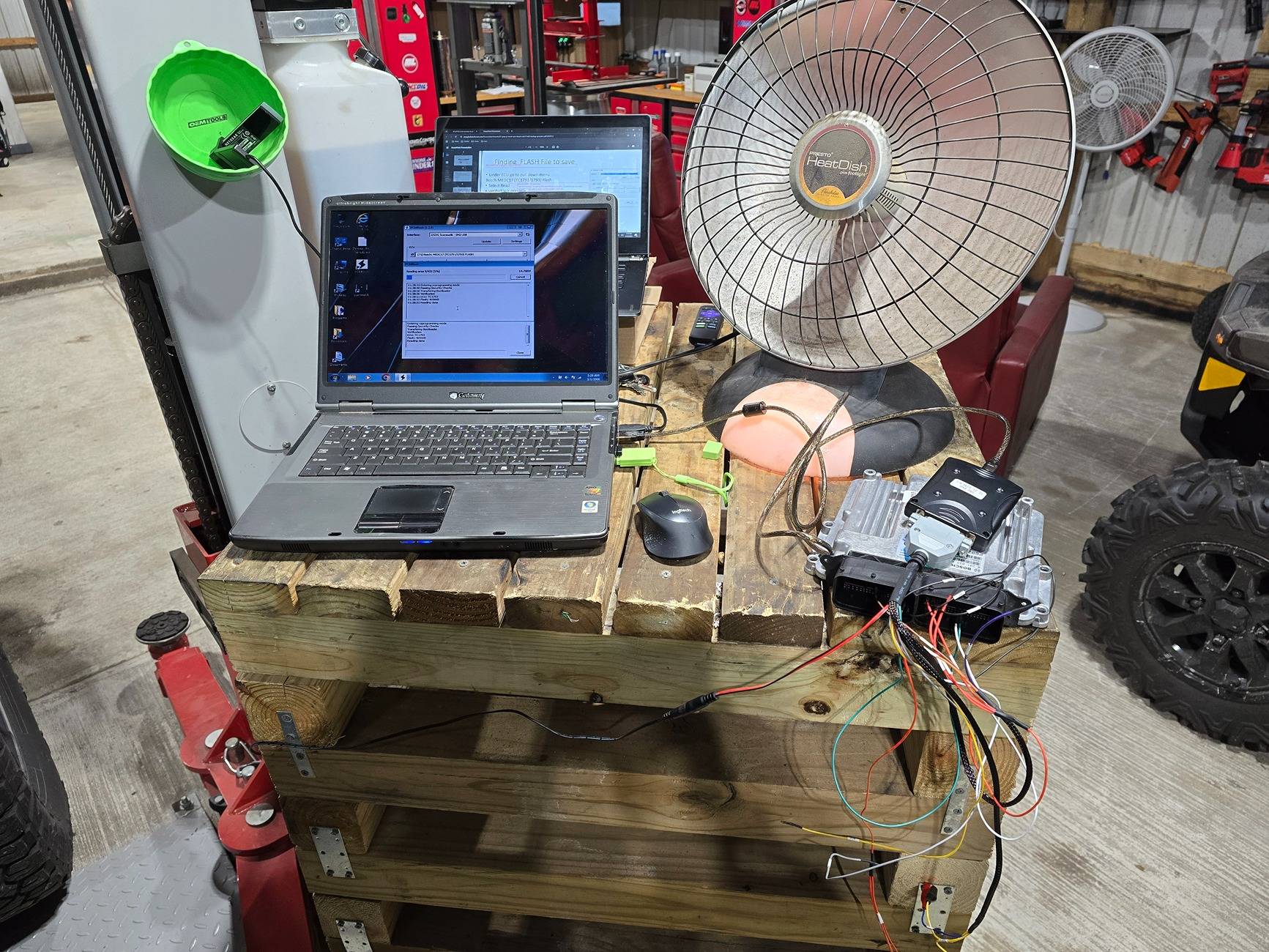

Just did it, super easy and only took maybe 25 mins. Didn't fully trust the provided software so dug up my old gateway laptop that somehow still works. Zero issues following the instructions posted a few pages back.
Truck is currently running perfectly with the cloned ecm, I'll be sending that one in for the tune and keep the factory one stock.

Alright, so... I may have been better off buying the true scanmatic tool vs this Chinese knock off. I have successfully cloned my PCM. It took paying for a second PCM from EastCoastMoparts while waiting for the debacle with UPS to be sorted out(the original is still not delivered).
To say the Chinese knock off tool is buggy would be an understatement. I used a different 12vdc supply since the one that came with it would get pulled down to 8 or 9 volts. That helped some. It took multiple attempts to read the programming and multiple multiple attempts to write to the new PCM. Has anyone else been experiencing this?
Anyways.. the new PCM is attached to my Jeep's wiring harness and a successful test drive has been completed... No codes, no weirdness.
Thinking I should probably go to the dealer and see if new firmware is available and clone that before sending this thing off to get tuned.
Also.. to answer an earlier question in the thread; if you click the "unlock ECU" button when writing a file, it returns an error that says the wrong module was selected and aborts the process.

Same here, mine worked perfectly on the first try. I did have to use another 12v charger I had in my "misc electric crap" box that every dad has since the one that came in the kit had a euro plug.
