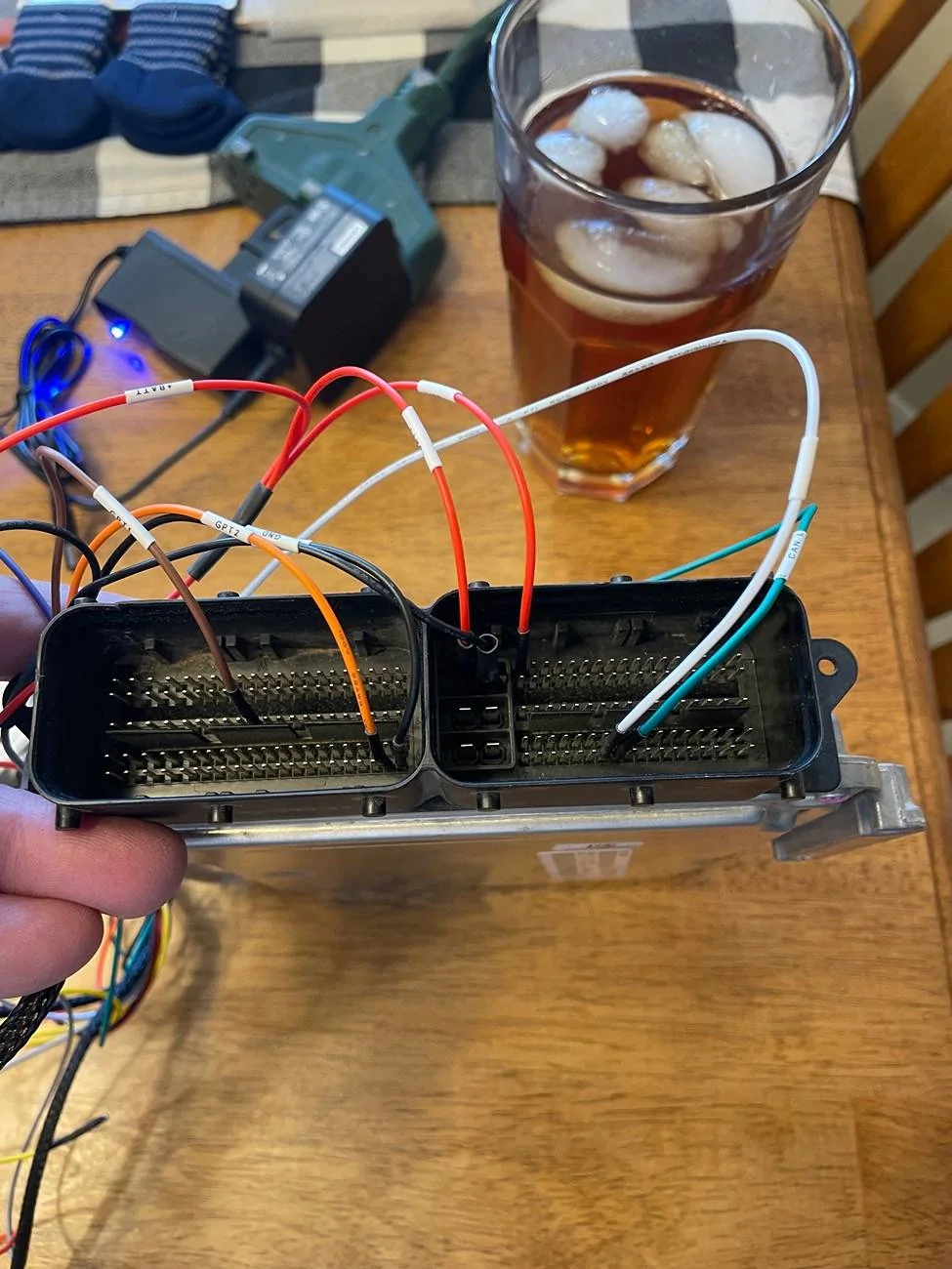

I've spent most of the weekend trying to get this to work, but despited my best efforts I keep getting unsuccessful error messages. Something I didn't see mentioned anywhere is should the jumper interface be set to on or auto? Also when it prompts you if you want to use the automatic power control (L-Line), should you choose yes or no? I wonder if I just have a bad interface box. The light on it is lit up green. Getting close to just throwing in the towel.
The edited instructions I post said to switch to auto, and to let the software control the power.
Also double check your pin out and re- review the edited instructions and verify you followed the steps.
Thank you! I tried that, but I still can't get it to read anything. I wonder if I got one with a bad harness. On mine GPT1 is a gray wire and the brown wire is marked L-Line.

Here is a pic of my working set up, I think you can see the wire labels.
Jeep Gladiator ECU/PCM clone process & pricing IMG_8963

@Mr. Glass
did you try switching them?
grey L-line should pin out on the top row 7th pin counting from left to right.
Brown GPT1 pins out bottom row 3rd pin counting from left to right.
those are my continuity results.
bust out a multi meter and do a continuity test to verify pin out, i bet the labels are wrong
