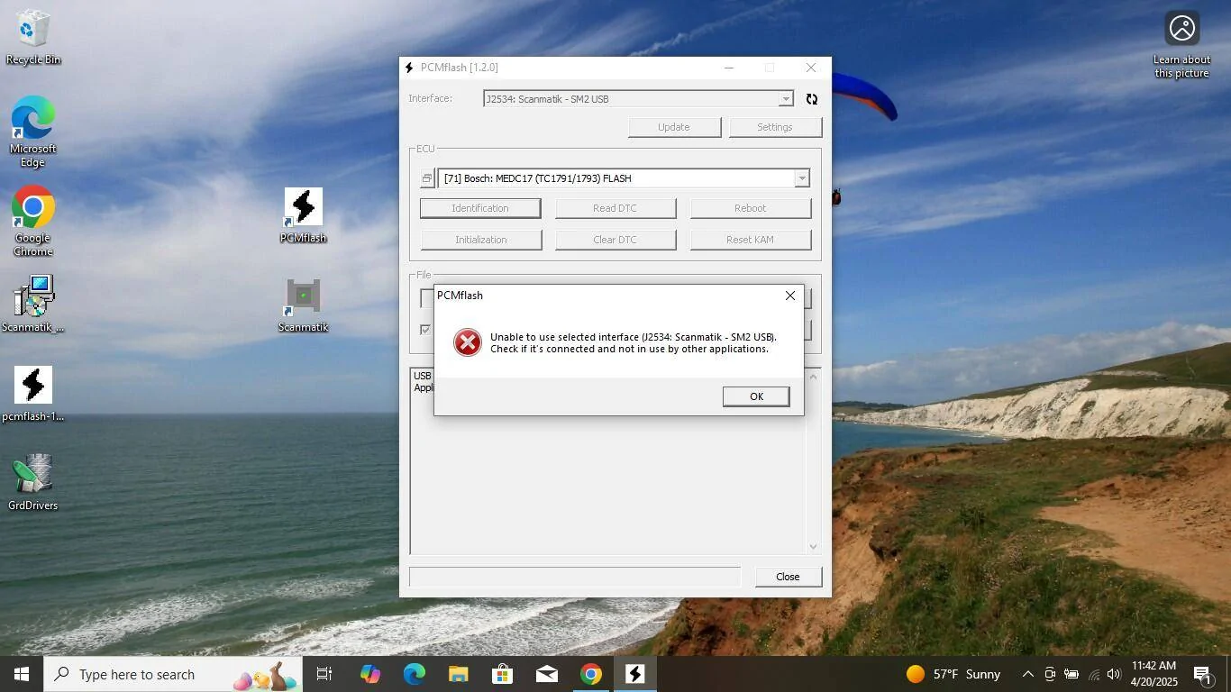

Is there anywhere safe to download the GrdDrivers, pcmflash-1.2.0, and Scanmatik_2.21.22_Setup drivers? I managed to loose the CDrom that came with the SM2 Pro I bought sometime back. I tried to download some latest drivers I randomly found out there but I continue to get this error> Guardant dongle not found: Make sure that Guardant dongle is connected to the computer and the latest Guardant driver is installed.

Downloaded the software from here. Plug everything in and keep getting this error over and over. I have tried to get the 2.21.22 version instead of the 2.21.21 version of scanmatik but cannot find it. My J2534 is very Chineseium....says SM2 Pro (22 and then chinese characters). I verified that it was 2.21.21 version when I bought it but nothing I do can get me past this error....any idea??
Does your SM2 Pro have a version sticker on it? That's the software version you want to use. Also, do you have the flash drive that came with your kit plugged into your laptop?

So as I said which would be easy to glaze over...yes the sticker is not helpful:
Yes I have the proper usb dongle and it is plugged in when I took the screenshot....you will get a different error message if the dongle is not plugged in.
I have read on other forums that when you get this message uninstall and reinstall and the message goes away....not in my case. So that's why I'm here...I just assumed that someone has had this problem.
I'm considering buying another kit as I did not get software with mine....no CD....just the dongle. I did buy mine new off eBay. The ad did say scanmatik version 2.21.21, but I cannot figure out what is wrong because I have followed all the instructions found in the powerpoint here......I went so far as to print them to have them right in front of me. Just cannot get this to move forward.

I have the disc and can pull the software off of it if you want to try the version from my disc which is 2.21.22.

Ok....even though the eBay ad said 2.21.21.....I installed Vette Moto's 2.21.22 and it worked just fine.
