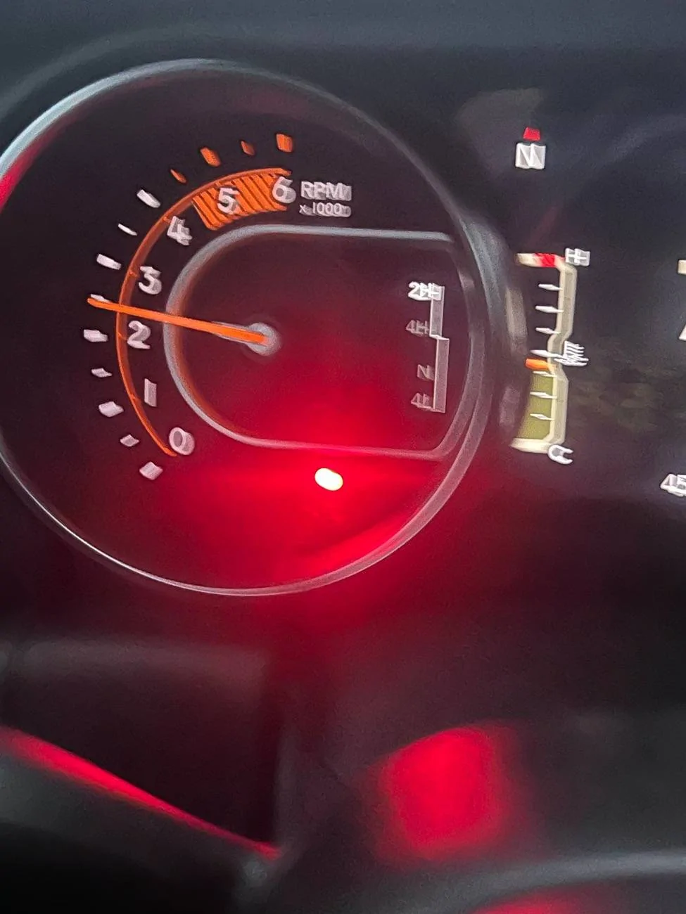

This is the weird light, I don’t even notice it anymore after two weeks
Jeep Gladiator ECU/PCM clone process & pricing IMG_6766

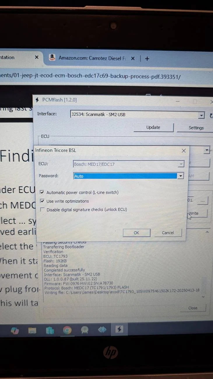

I received 2 prompts that weren't in the instructions. I clicked OK and yes, respectively in the following photos.

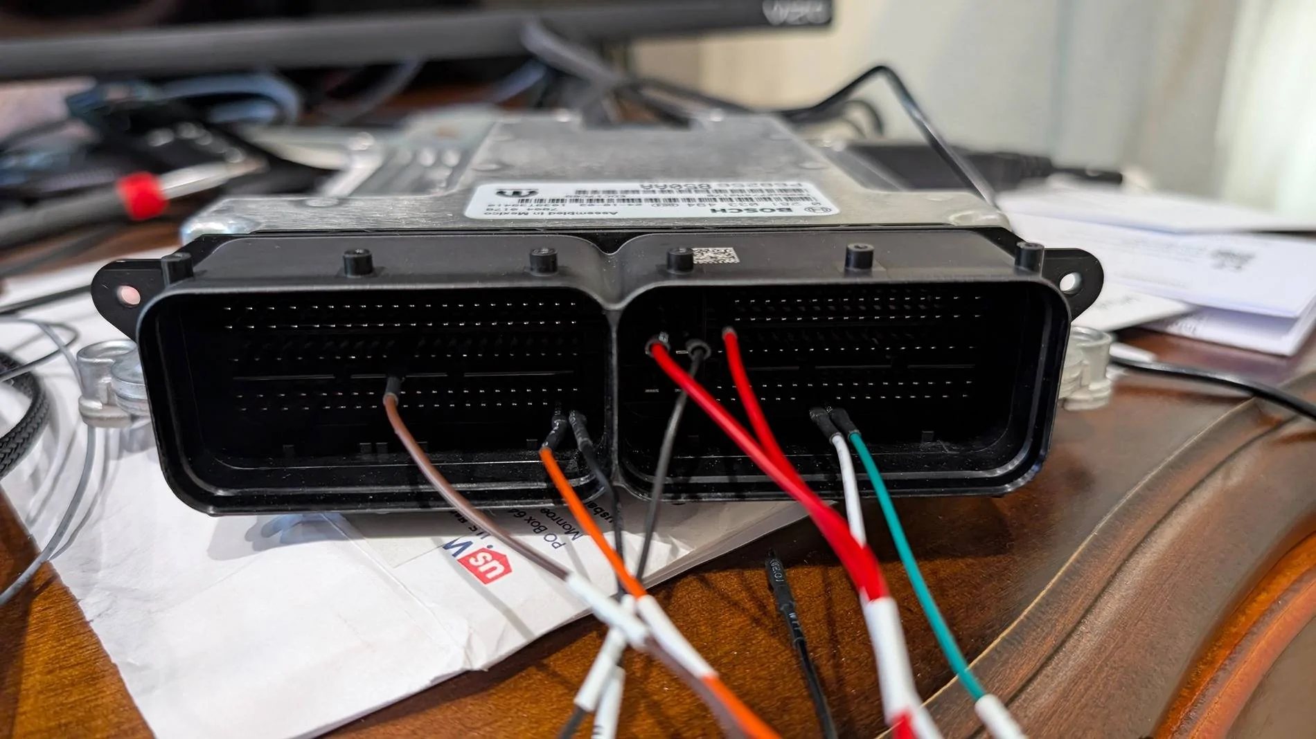

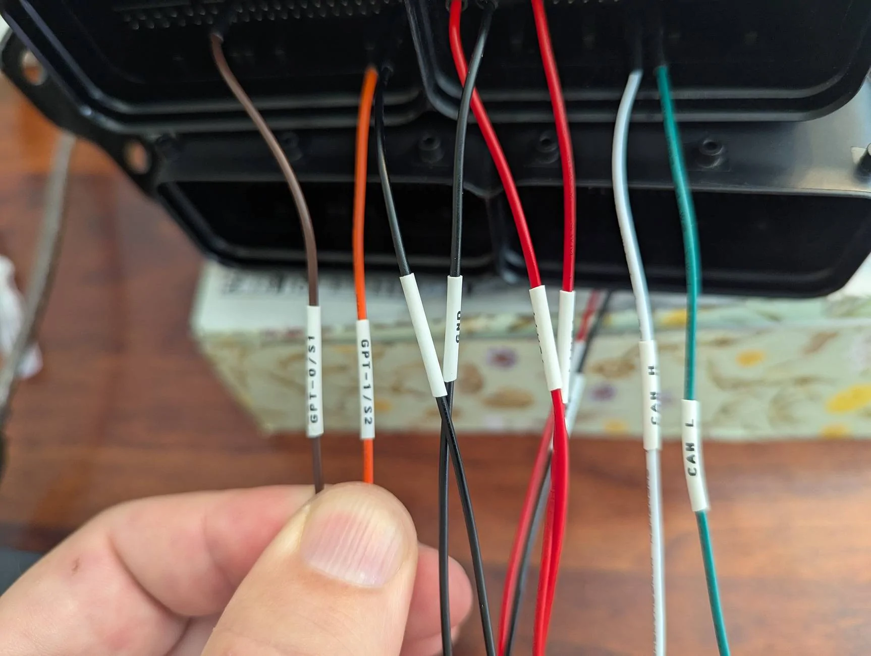

Here's a photo of the labels on the pins while functioning. You need the first two serial/GPT pins on the left (mine were brown and orange) and the CAN pins on the right (CAN High was white. CAN Low was green). All red and black power/ground are self explanatory, but make sure you don't use the red VCC pins. Those are a different voltage.
Jeep Gladiator ECU/PCM clone process & pricing 2025-05-21 11.42.01

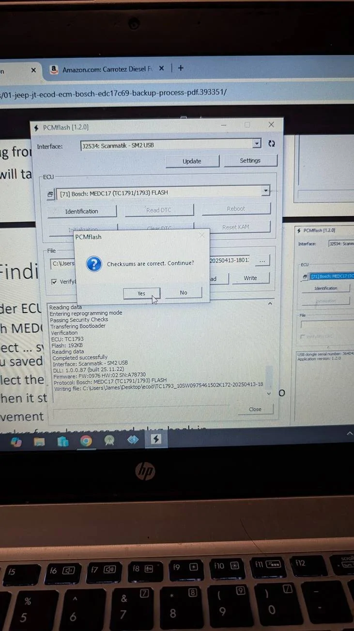

I am practicing on the new ECU and when I read and save the file at the end I get the following pop up.
Once the binary is saved it pops up check sum error. Any thoughts?
