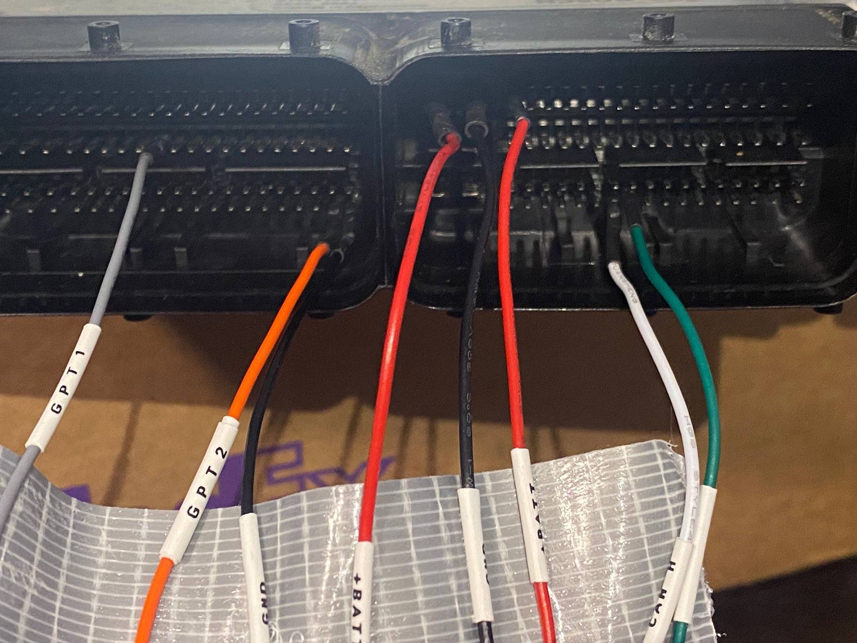

This is how mine is setup. I did try switching them, but it didn’t seem to make a difference. I can grab my multimeter. What do you recommend I test?
trace where the 2 wires in question pin out on the serial cable plug. Use this info.
grey L-line should pin out on the top row 7th pin counting from left to right.
Brown GPT1 pins out bottom row 3rd pin counting from left to right.
those are my continuity results.
if your gpt-1 grey wire pins out at bottom row 3rd pin counting from left to right, then it's it labeled right. If it pins to top row 7th pin counting from left to right, then it's wrong.
Same goes for the other wire

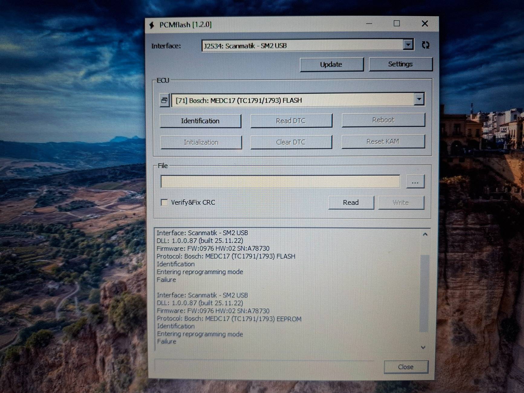

Trying to read it with the knock off clone device you get a “completed unsuccessfully” message. Device works fine on the factory ECU.
Gregj
Can confirm.
This is unfortunate as I was hoping to be able to backup my tuned ECU.

Gregj
I found out that the PCM I bought from someone had already been tuned by Martin (MrTuning). That would explain why we couldn’t read it, but I wonder if that is also why we couldn’t write over it as well. 🤔🤷‍♂️
rharr
May 6, 2021
2,155
2,951
Tucson, AZ
Yes it is likely locked. When locked it changes the access code from the default code to a unique code to prevent EEPROM read/write functions. AKA protecting the tuners work from easily being copied.
If you want that ECU you will need to have mr tune do a bench unlock for you, but he will need the original vin so he can look up the account.
So basically that ecu is a desk ornament.
if you are froggy, you could open the ECU up find the EEPROM chip remove it, and over write it with a EEPROM writer/reader using a copy of what you pull from your stock stock ecu using the same method......
