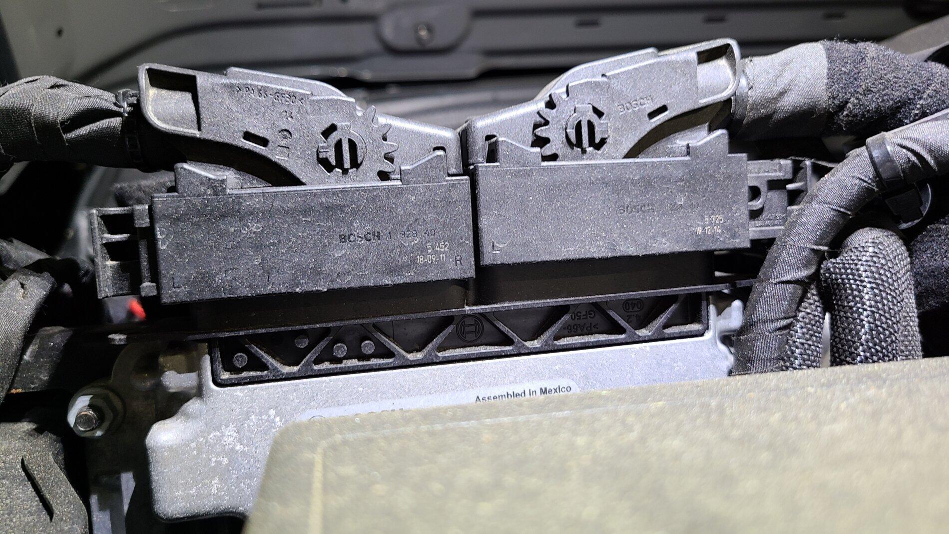

I've had random CELs over the 10,000miles ive owned the jeep such as P0118 and "service electronic throttle control" and "service DEF".. engine coolant temps all over the place.. i thought it was bad sensors on the jeep or the tazer JL messing with the electronics. Dealer could not diagnose because CELs would go away before my dealer appointments.. TURNS OUT, my damn PCM has been partially unplugged! I reset it and everything is back to normal.

Sucker is trying to escape!!

Glad you found the culprit. Mine only throws that code when I am towing and it gets warm. :(

Nice find.
Lets me know with all of these electronics and sensors the plugs should be the fist place I'll check

Definitely... My 2 brothers had JLs (3.6L) built same time as mine (sept/oct/nov of 2020) all 3 of our jeeps had loose fuses. Plus I had a the loose PCM and one of the JLs had to have a PCM replaced due to miss fires issues.. looking back I'm sure his PCM was not properly hooked up either... crazy..
