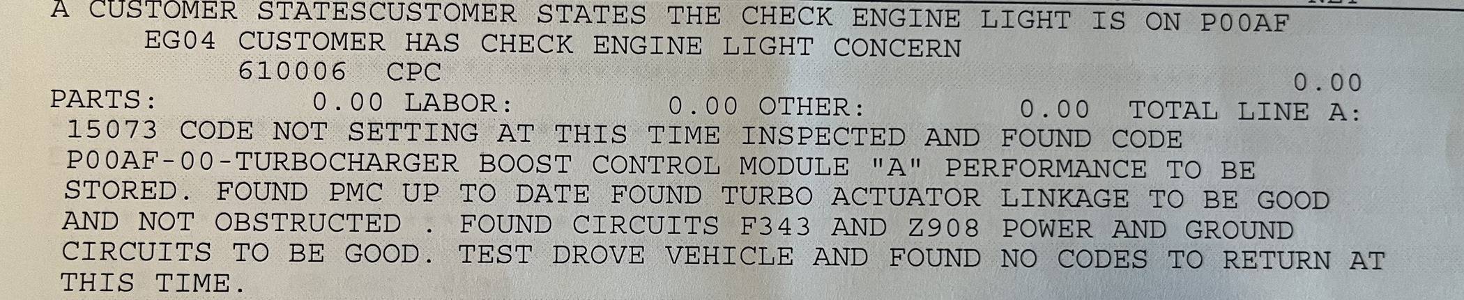

This has happened to me three times on my 2022. Twice not towing and under moderate load and again this weekend towing uphill. This service report is when I took it in the second time a few months ago:
