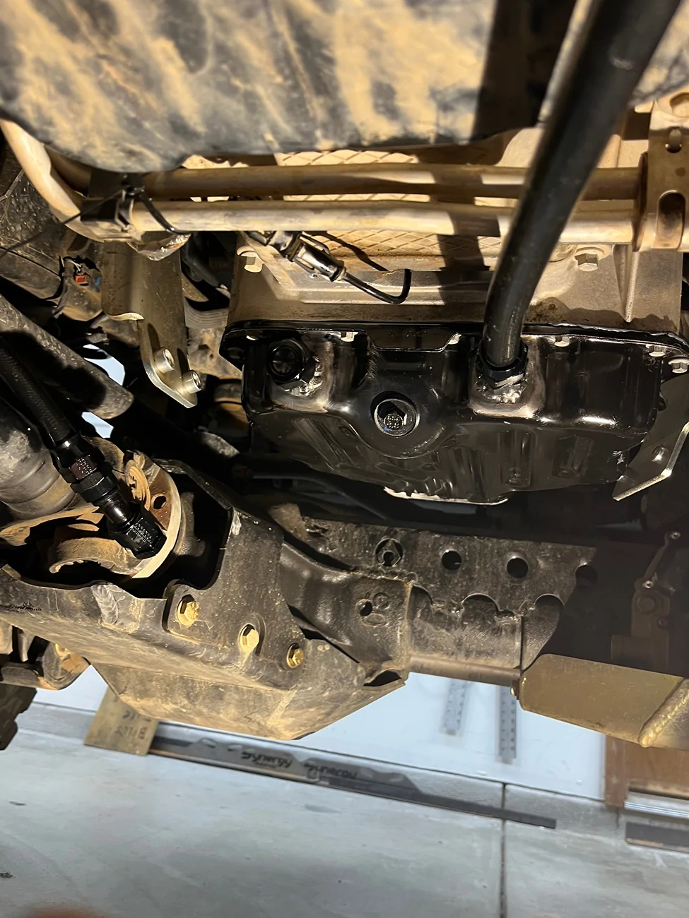

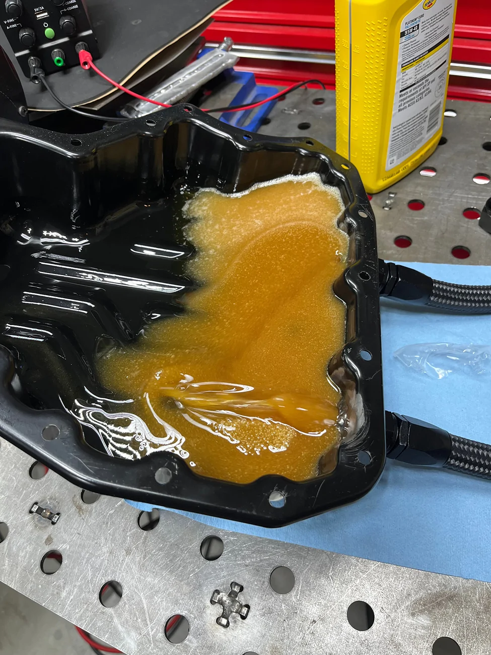

How did you tap into the oil system? I've considered going straight into the oil pan with -10AN fittings and using a Tilton oil pump to circulate oil through a cooler completely separately from the engine's oil circuit.
Welded 10AN bungs into the back side of the pan. Did flow testing on the bench. Ignore the frothy oil air was introduced during cavitation testing. The pump is TurboWerx however based on various conversation with folks who use oil transfer pumps I will switch to a Marco M164-320-12 when the TurboWerx dies. I used Fragola 6000 Series PTFE due to the temps and reliability needed. Pump is mounted on the cross member for the Artec skid plate.

I built a completely separate/closed oil cooling loop that pulls oil from the pan, runs it through an external CBR cooler/fan setup mounted in the bed area, and then returns it back to the oil pan. Flow is roughly 2–3 GPM. This is not tied into the factory coolant/oil cooler circuit. It is a separate oil loop and added about 3 quarts of total oil capacity.
The tank on the right is not related to the cooling system. It is a 1-gallon tank that feeds my heater for camping when I am not pulling the trailer.
Before doing this, I would see oil temps climb to 275°F+ towing my roughly 3,000 lb trailer up long grades. With this setup running, the highest I’ve seen is about 235°F under the same kind of towing conditions. It knocked roughly 40°F off my worst-case oil temps while towing.
I wanted a setup that lets me tow at a reasonable speed without watching oil temps run away. The truck is used for rock crawling and pulling an off-road trailer only.
