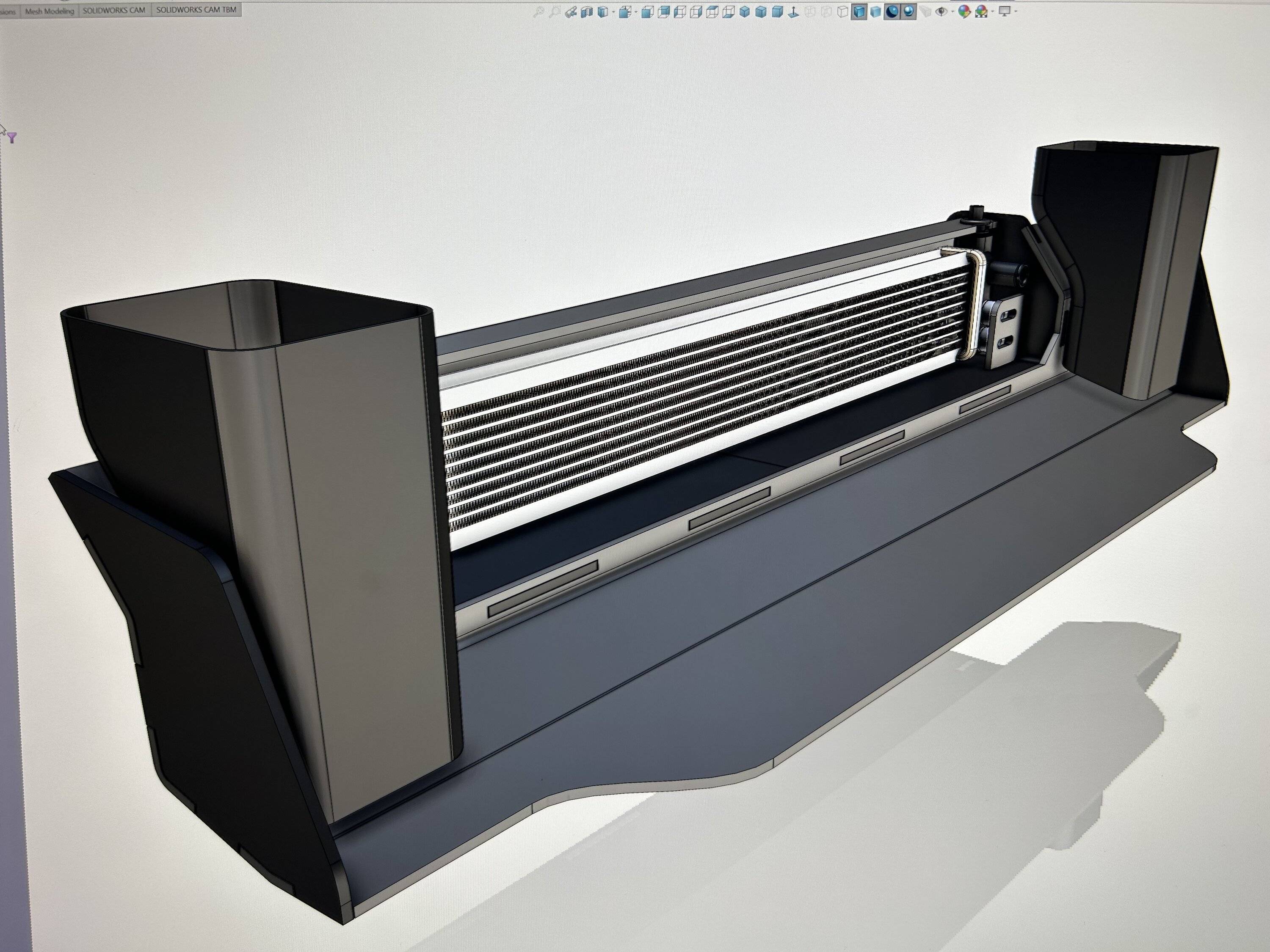

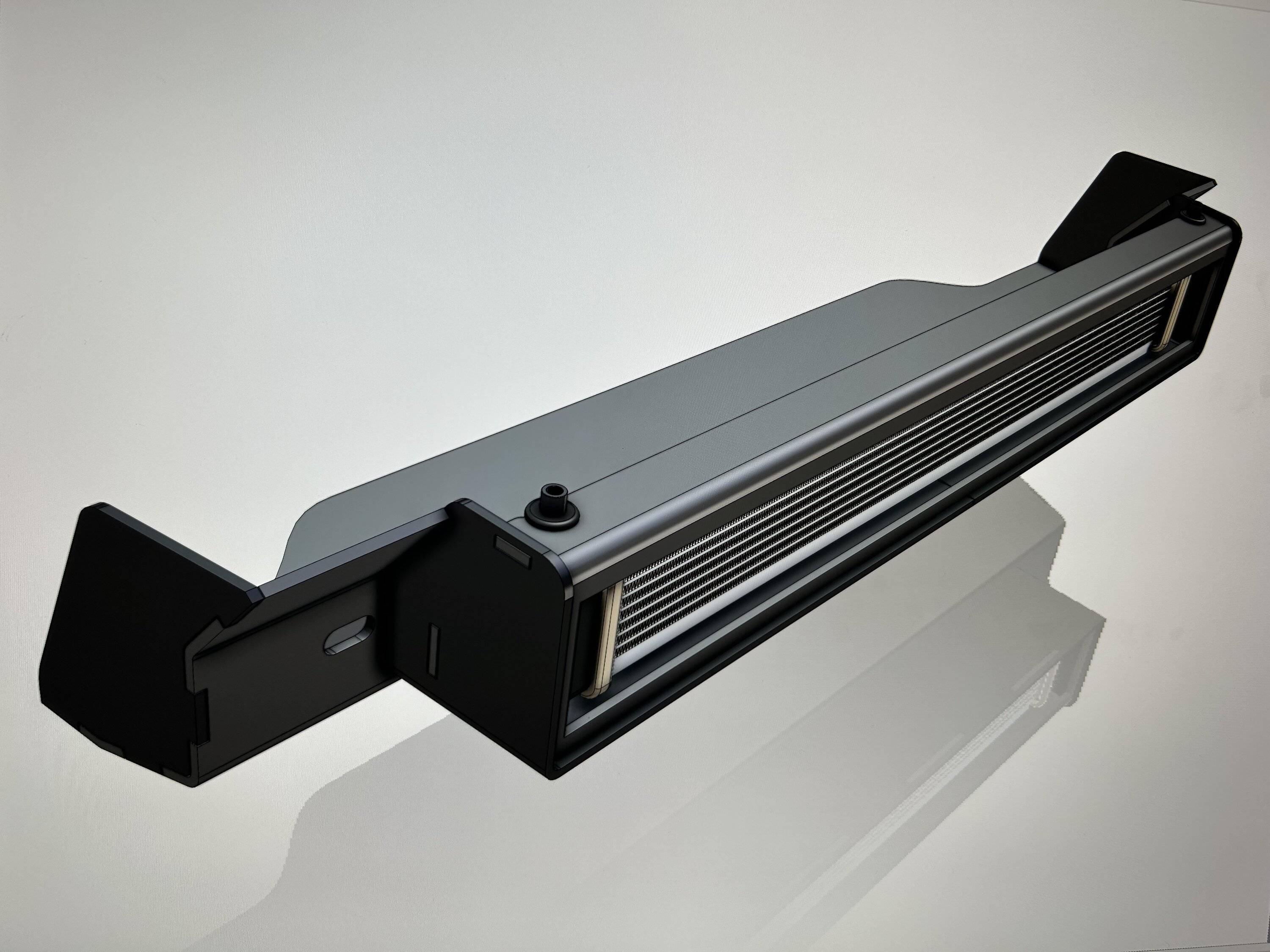

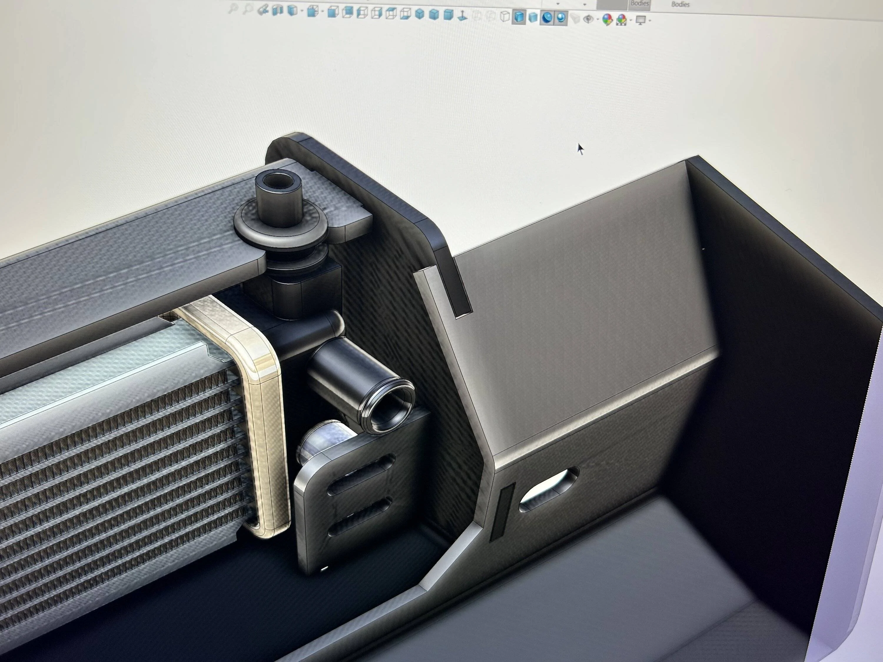

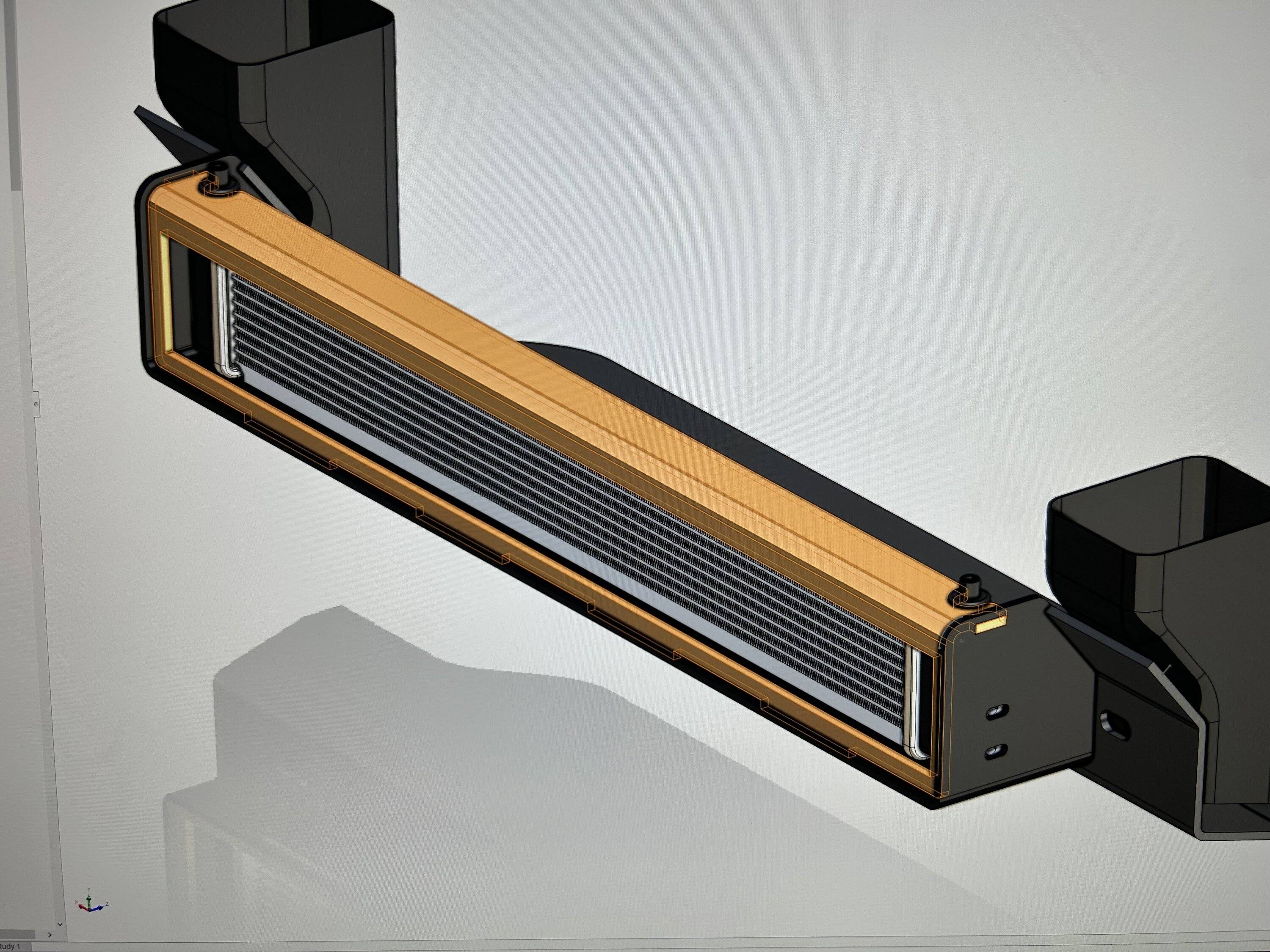

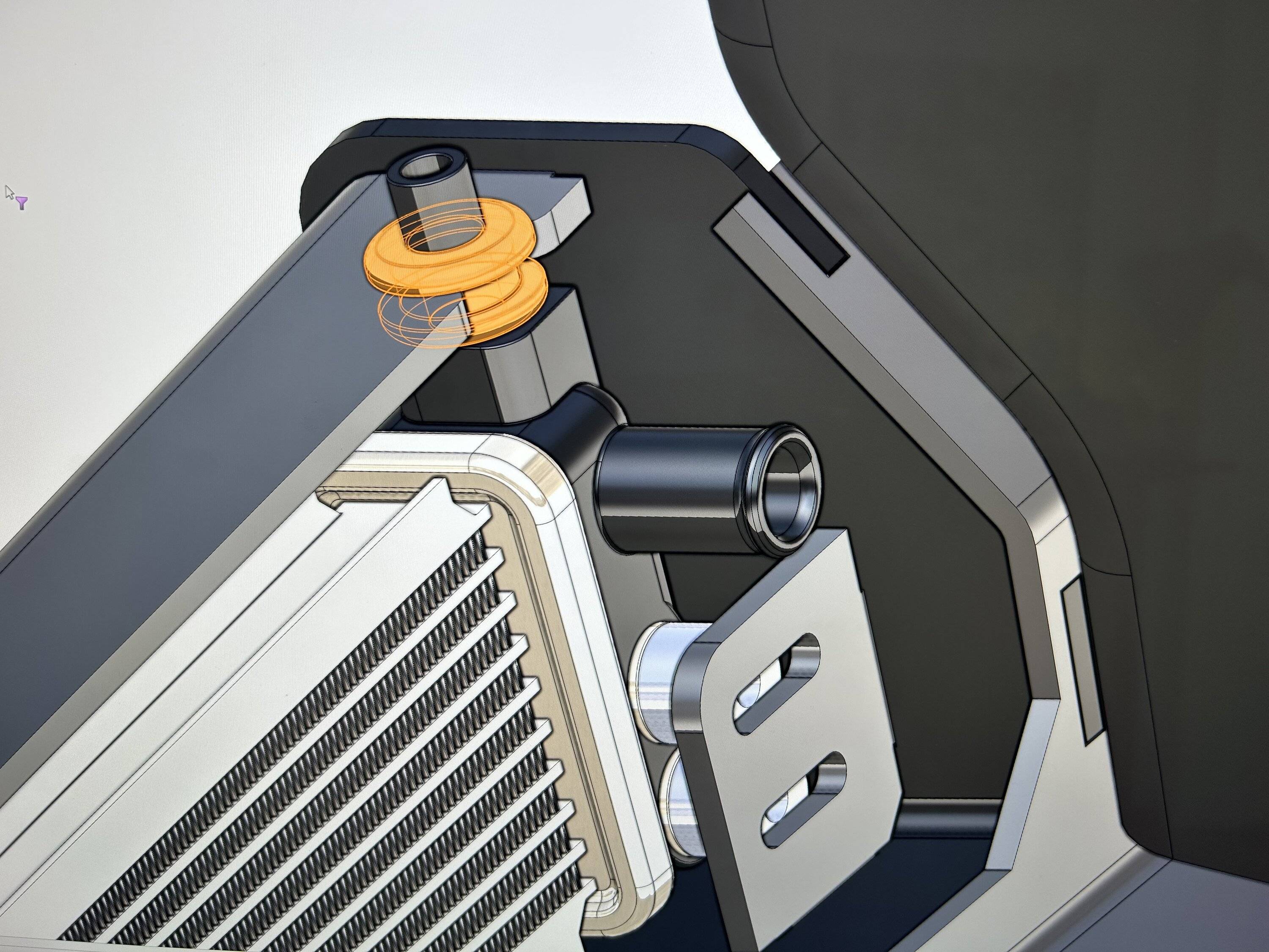

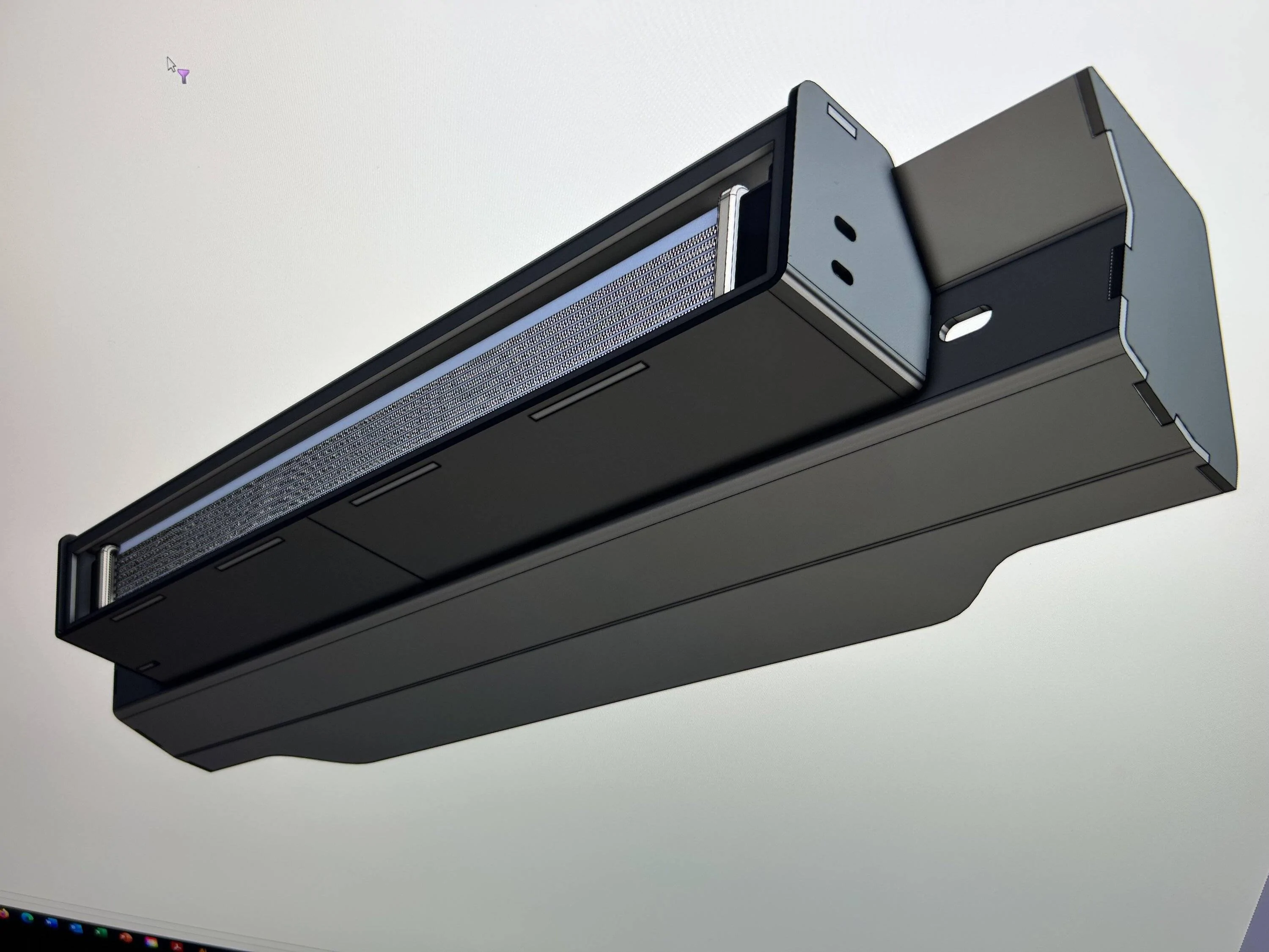

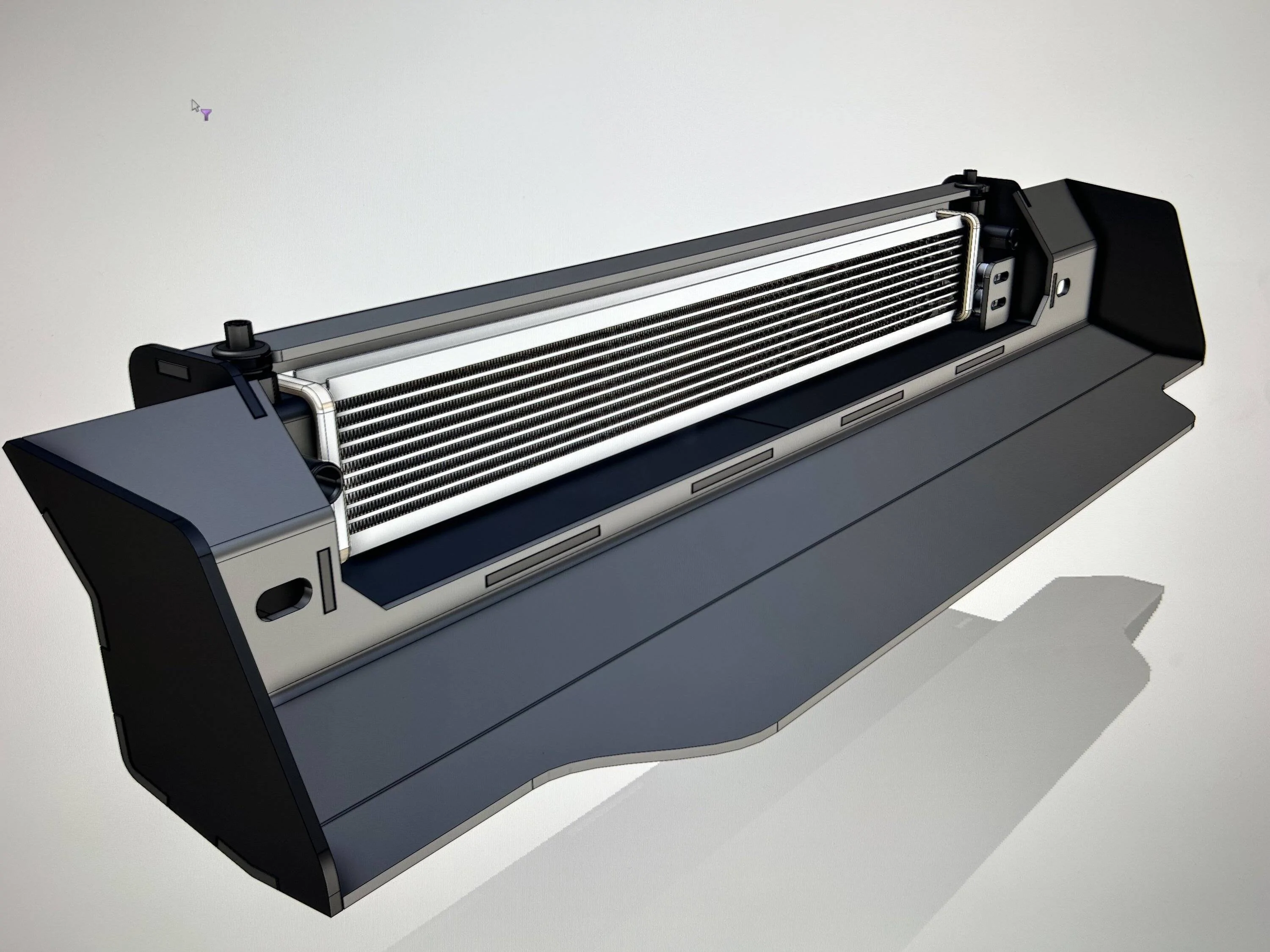

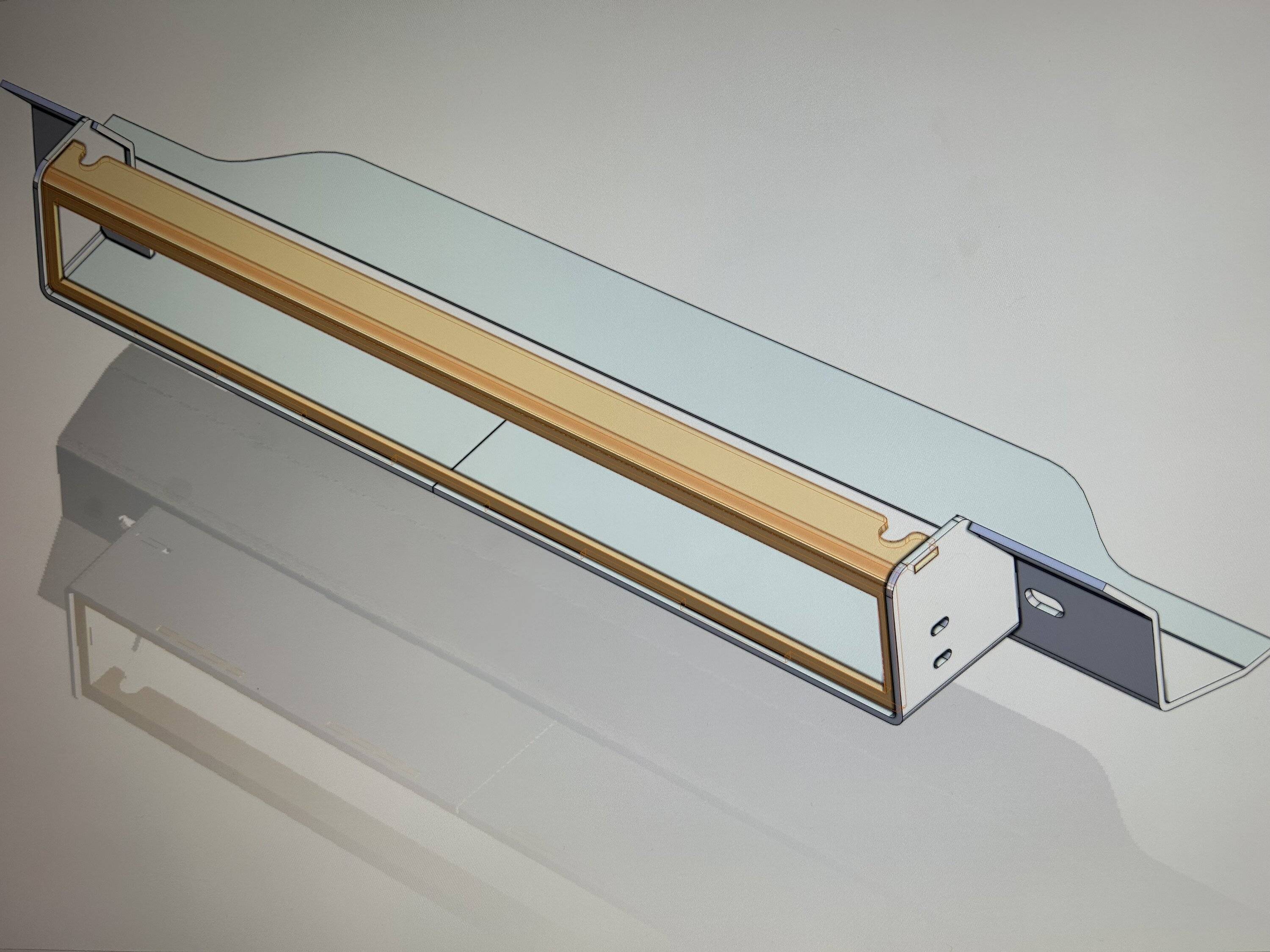

It would be around $550.00 if seven can commit.
This would be the skid plate housing fully welded and assembled, sandblasted, and powder coated in lightly textured black.
You would need to byo cooler core, hoses, hardware, etc.
Primer,
Count me in if you get enough to do this I will definitely pony up $550........ if it doesn't happen before Christmas I'm probably gonna bite the bullet and have one fabbed up out of 304SS. Will definitely cost me more than 550.

There may also be a new skid plate available soon for the new cooler that will work with the electric sway bar and steel bumpers — first prototypes are expected to be ready soon.
you’ve provided some great information here Sean (@Primer Gray). Any chance you have a parts list, looks, and/or where you got the parts? Thanks in advance!

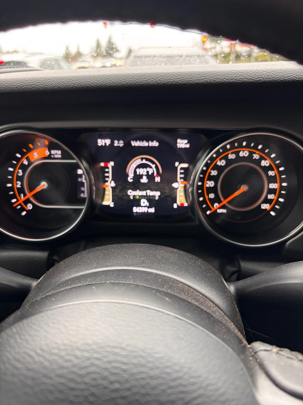

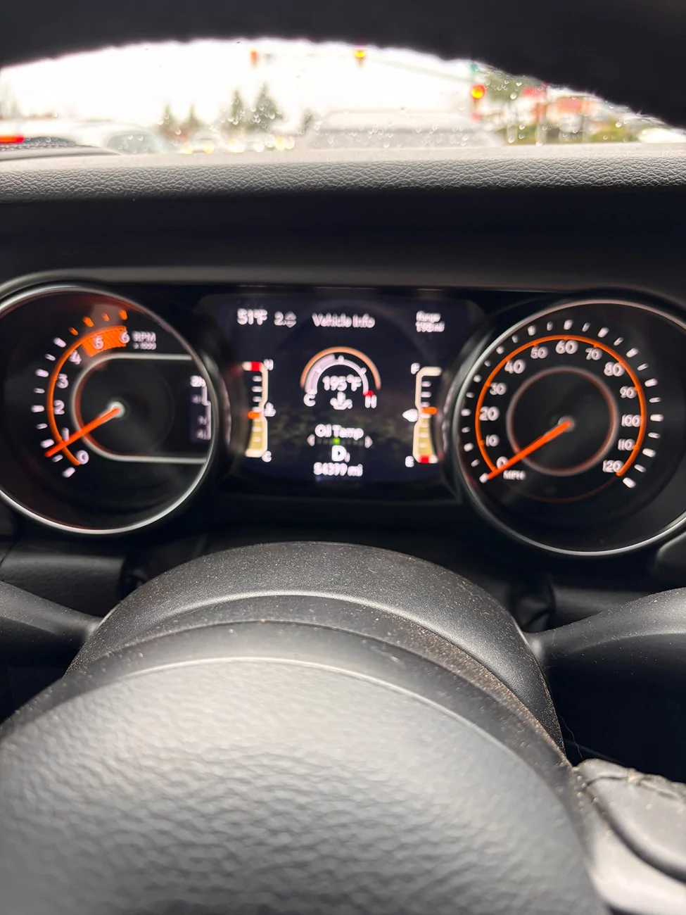

I have some miles on the new csf radiator trans cooler and low temp thermostat.
the limiting factor is airflow through the coolant stack which can be overcome by using the taxers fan feature even on the highway.
I have everything else done to this Jeep no insulation, no inner fenders, on and on trying to get my uphill temps under control with 40s in hot weather.
I will say the highest oil temps I see now in cool winter weather are 230ish with the fan off. This is trying to spike temps.
if you turn the fan on with a tazer the oil temps drop down to 200-220 oil.
Waiting for 100 degree weather to see but in race mode I could mat it and peak 255 oil temps on a mountain pass but I don’t believe any further coolings neccesary.
This is idling for 20 minutes after a one hour highway drive everything sits at 190 now. Stock it would creep up to 220+ and run the fan.
