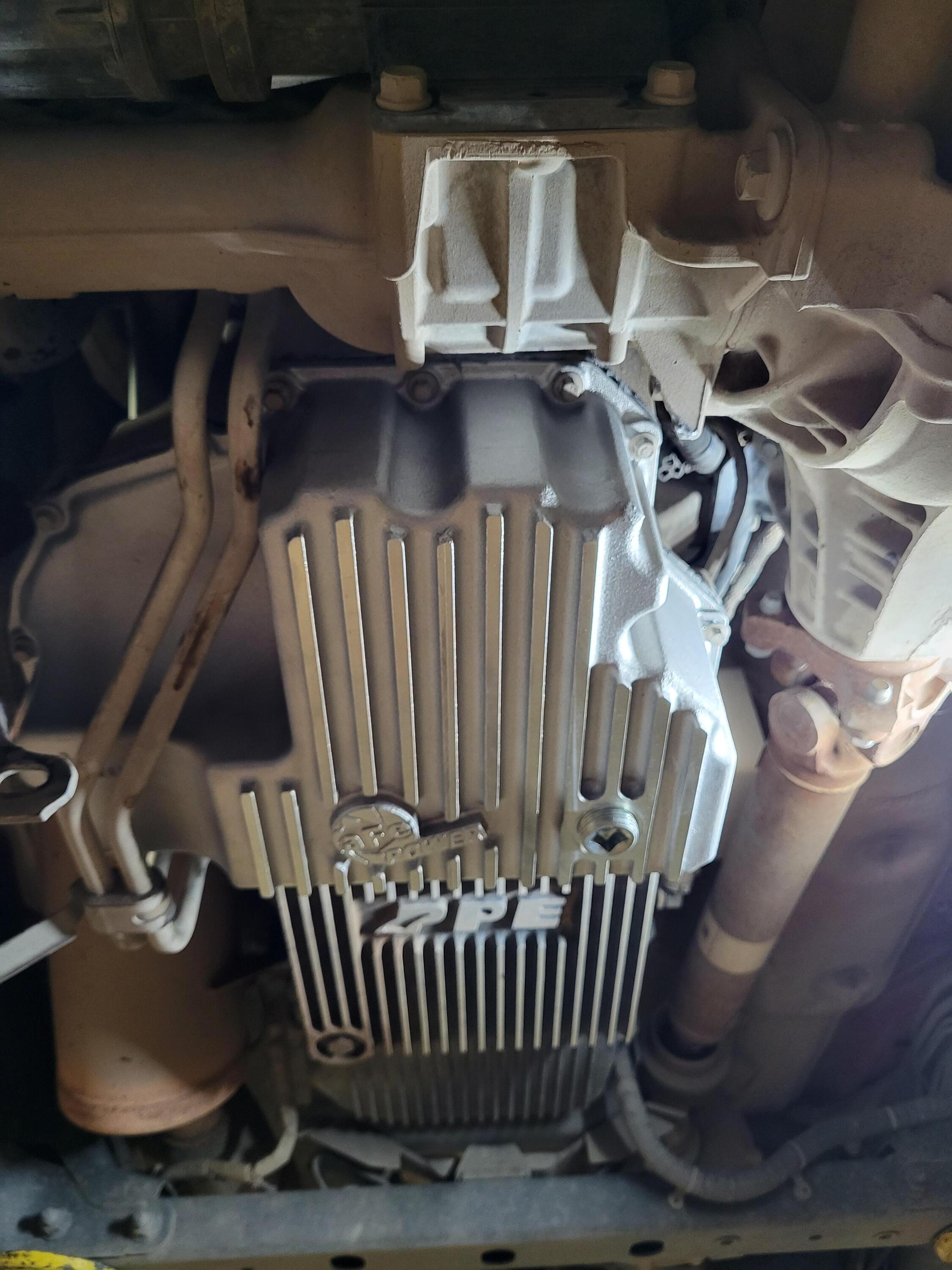

An additional cooler will get the 3.0 up into the big boy diesel class, probably from 9qt up close to 12qt of oil. I get crap from some of the big truck guys for only needing 9qt, like that's some kind of bragging right.

I'm running a 12-quart capacity on my 2015 Ram EcoDiesel.
