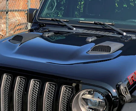

Folks reported taking the hood and grill off and nothing changed. The consensus is there isn't sufficient oil cooling hence why people are trying to find decent ways to cool the oil
So does that mean there is no gain to be had from hood vents such as the S&B scoops?
Photo for ref
Yes sir... No additional cooling is provided with air vents/scoops. Only cooling gains are found from aluminum rads, external oil coolers and/or oil bypass.
Photo for ref
Even if these scoops managed to force air into the engine compartment, they would be counter-productive. The vast majority of the engine's cooling comes from airflow through the grille-mounted heat exchangers (radiators). To promote airflow through the grille, you need to reduce air pressure in the engine compartment. You want to give the air being rammed through the radiators somewhere to evacuate - air that goes in needs somewhere to go out. If these scoops performed as their styling suggests, they would increase underhood air pressure and reduce the amount of cool air that can flow through the radiator. These more than likely are merely acting as poorly-designed vents.
I believe more testing needs to be done to verify the claim that removing the hood altogether does nothing to reduce engine temps. I for one do not believe that claim, as it goes against everything I know about fluid dynamics. However, I do not claim to be an aerodynamicist. All I know is that a sealed-up engine bay traps more heat than one that is well ventilated. I have removed my engine cover, the foam blocks, and the faux hood vents from my Jeep, and there is a constant rush of heat rising through the vents and cowl when stopped. I have no doubts that there is a huge amount of heat released through these points when a 60mph blast of air is flowing through the grille. The engine bay is sealed up from the factory for NVH reasons; I for one enjoy the diesel clatter and whistling turbo, so the heat- and noise-trapping foam blocks are counter-productive.
While that makes sense, the airflow moving through the radiator evacuates below the engine, where there is much more capacity for air flow volume than what is being brought through the radiator.
Without some sort of wind tunnel, a clear hood, and smoke test, it's hard to validate any of this. As far as I can tell, nobody has actually provided data on any of the claims.
One reviewer on the hood scoops claims a 10 degree drop for eco diesel, however there's no supporting data citation with anyone's theory.
The air will flow from a high pressure area to a low pressure area, wherever that may be. Obviously the open bottom of the engine bay is where the majority of air ramming through the radiator will wind up exhausting, but opening up passages (vents, cowl line) to the low pressure area above the hood will give another route for the hot air to flow and further reduce underhood pressure, promoting additional airflow through the radiator.
Agreed 100%. I would really love to see what affects our various mods have on the airflow through and around the front-end of our Jeeps.
As they say, don't believe everything you read on the Internet. :LOL:
