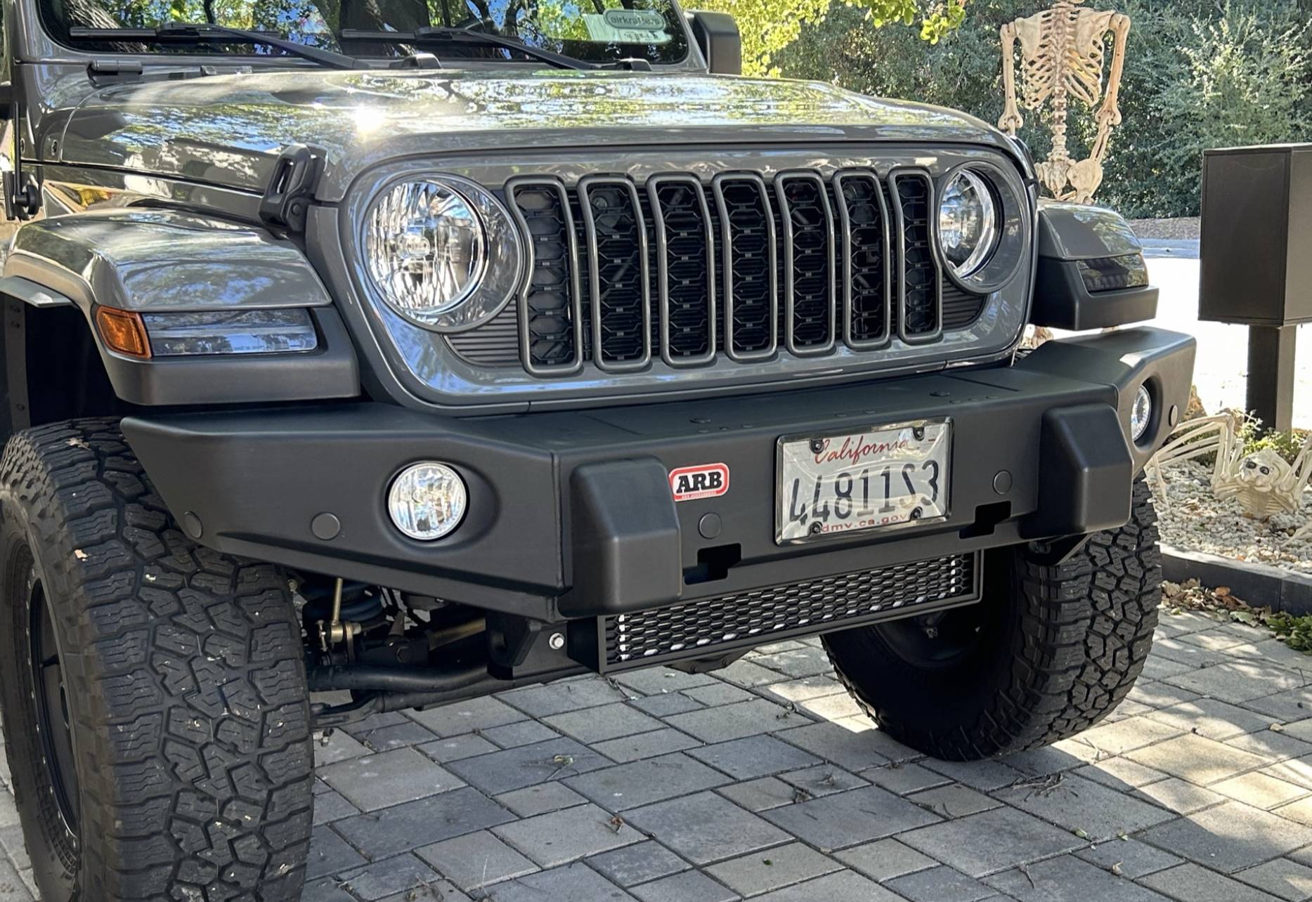

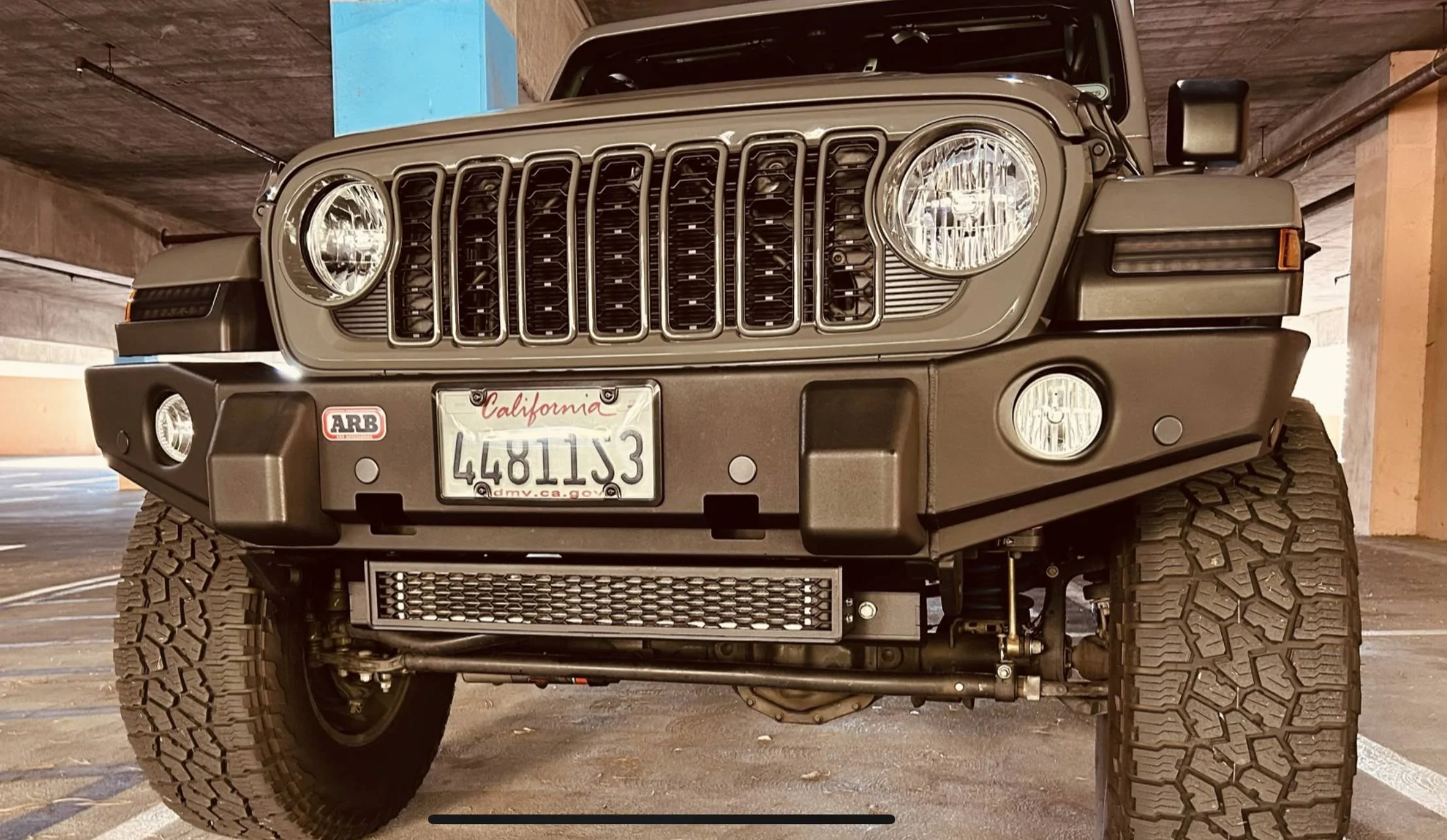

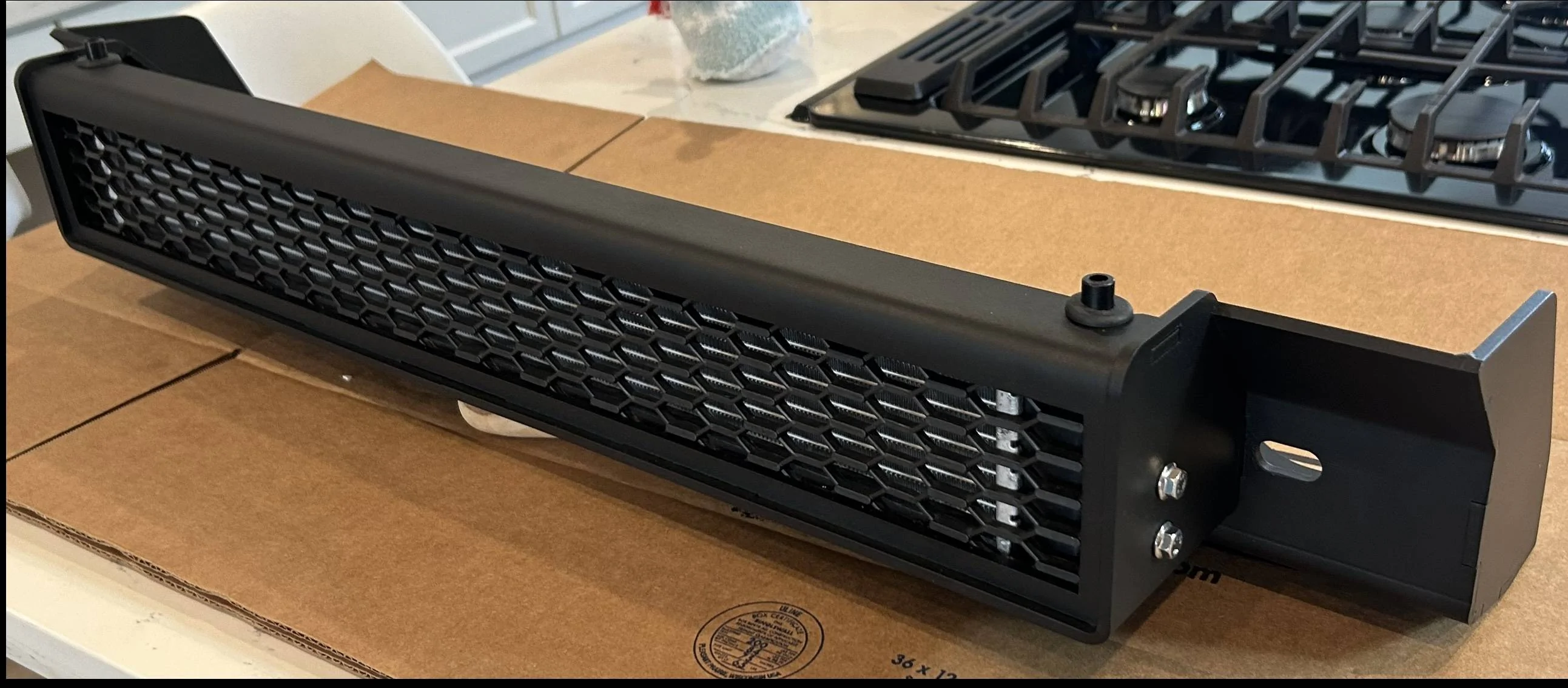

is this a one of design or are you prototyping/beta testing for insane diesel?
The mesh is a nice touch.

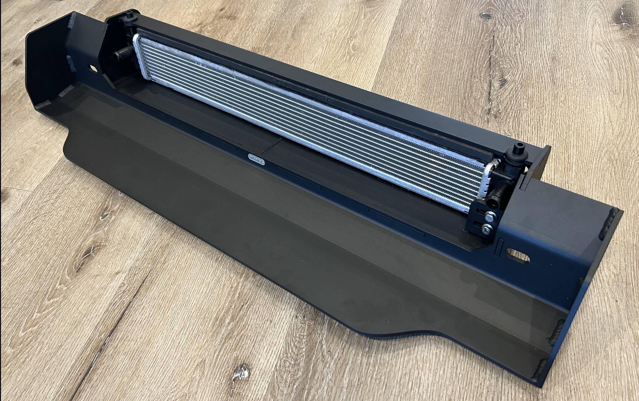

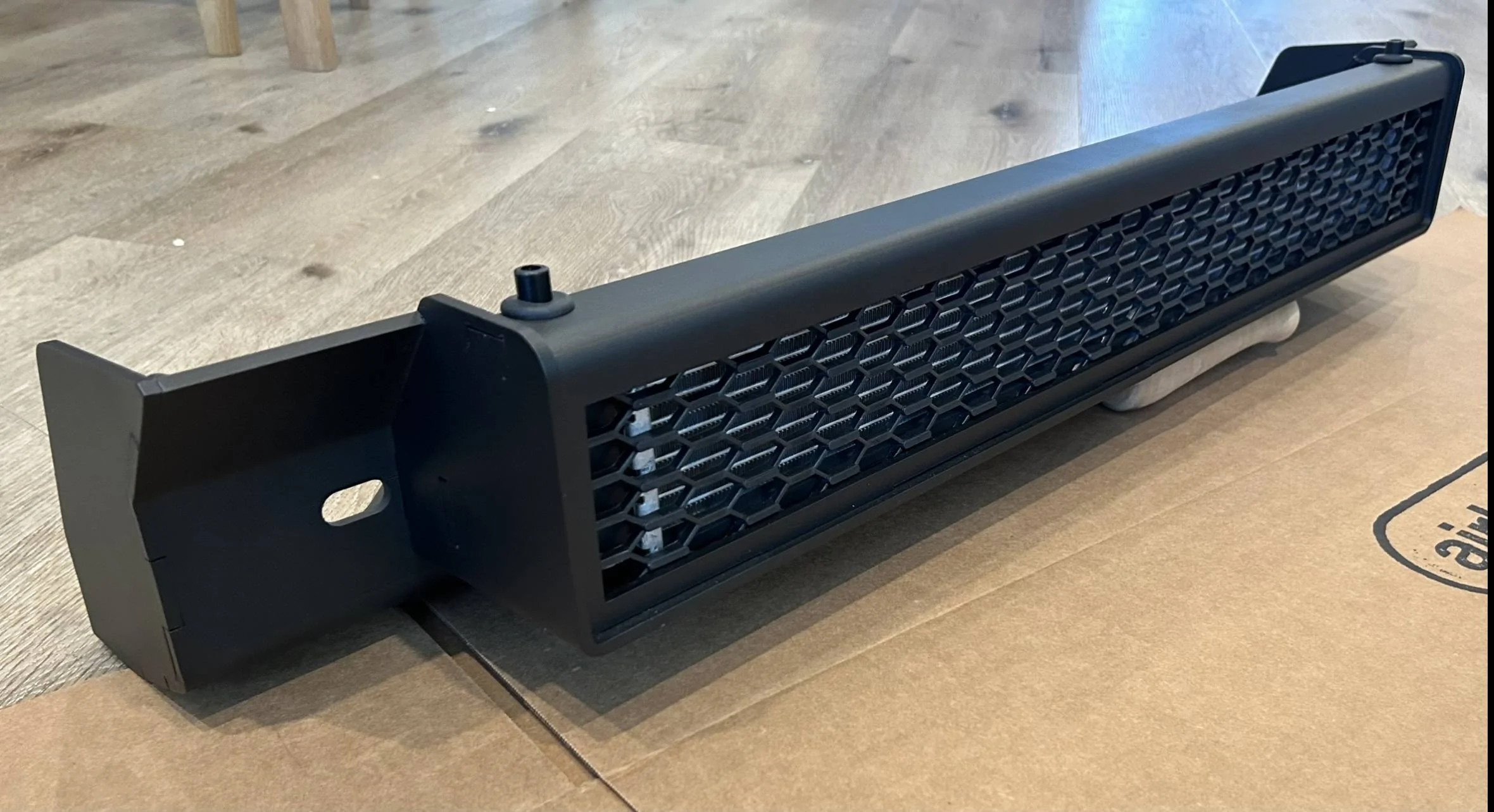

I was doing some testing with them but had fitment issues due to my ARB bumper — so down the rabbit hole I went…
I’ve only prototyped 2 of these with the purpose of handing the cad off to BPD — you’d probably get some response if you ask them about it… I have no intention of doing production runs of these myself but BPD can..
Primer Gray
Sean
Apr 10, 2023
80
217
Thousand Oaks
2021 Jeep Gladiator
Industrial Designer

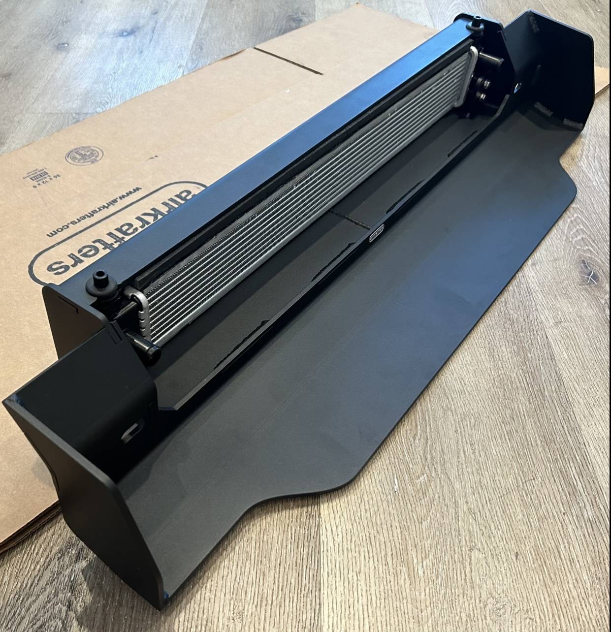

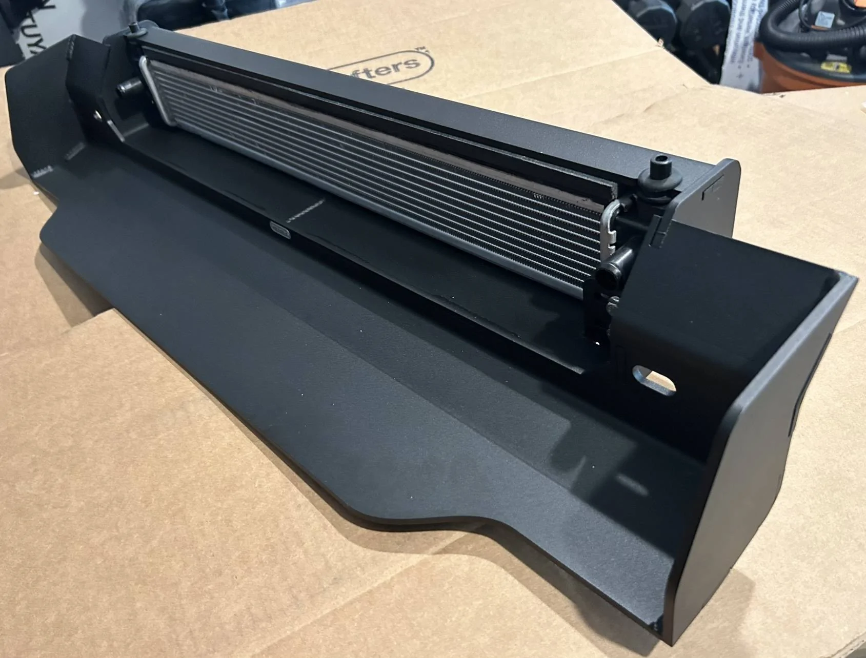

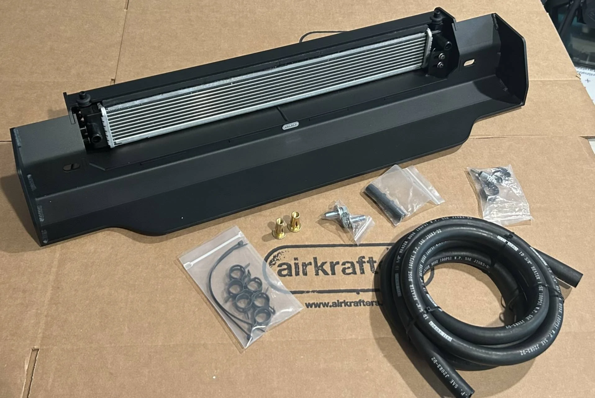

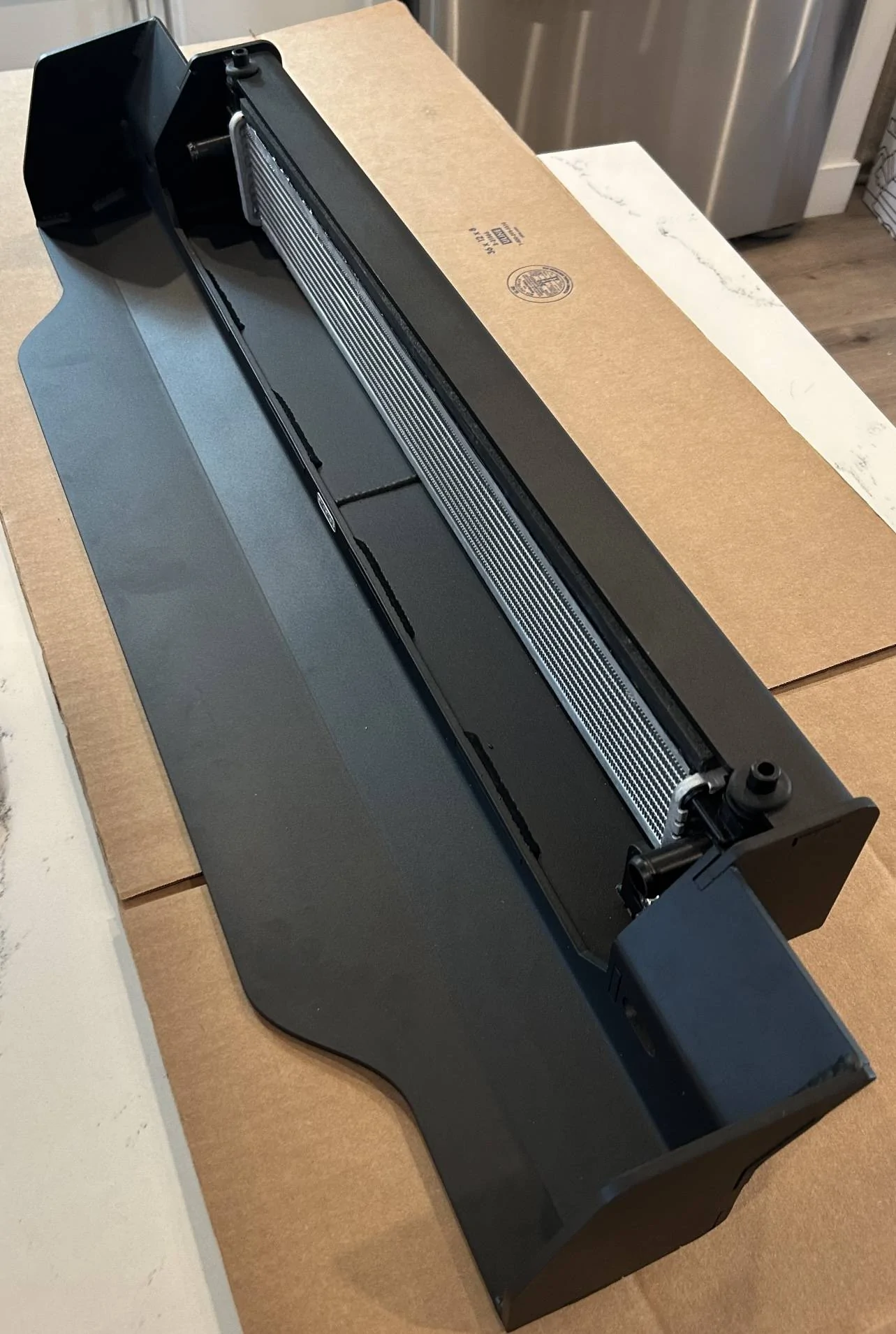

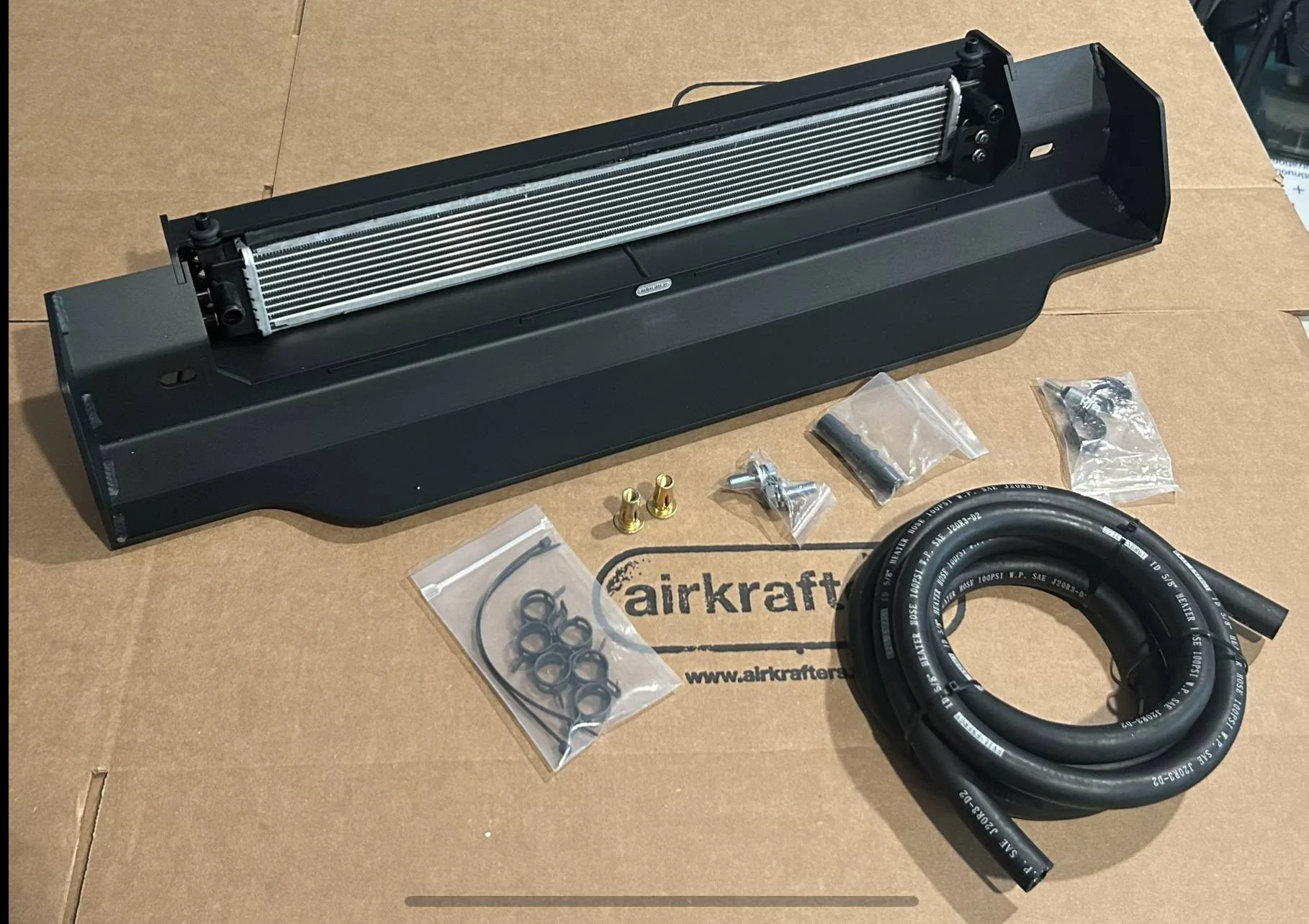

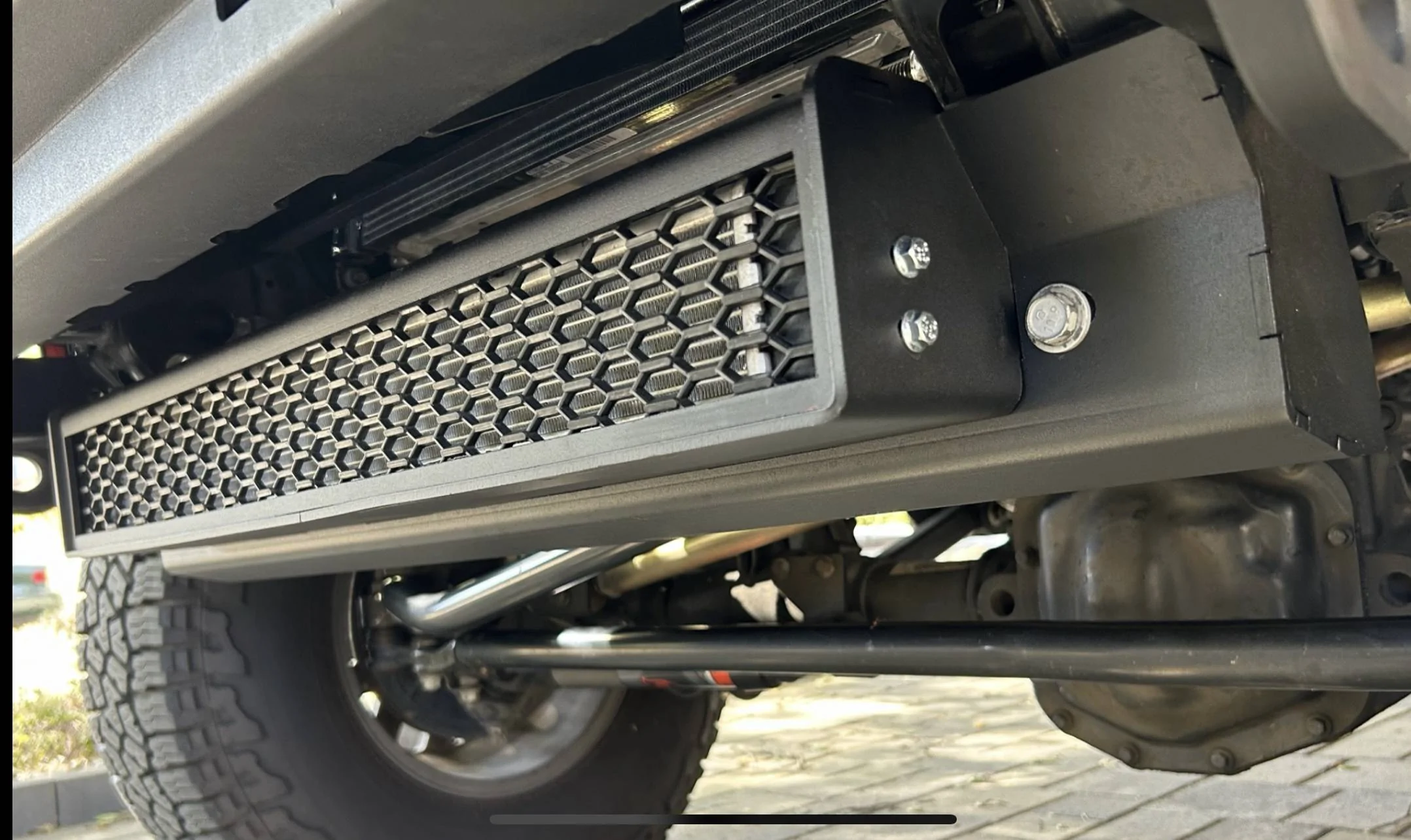

FYI,

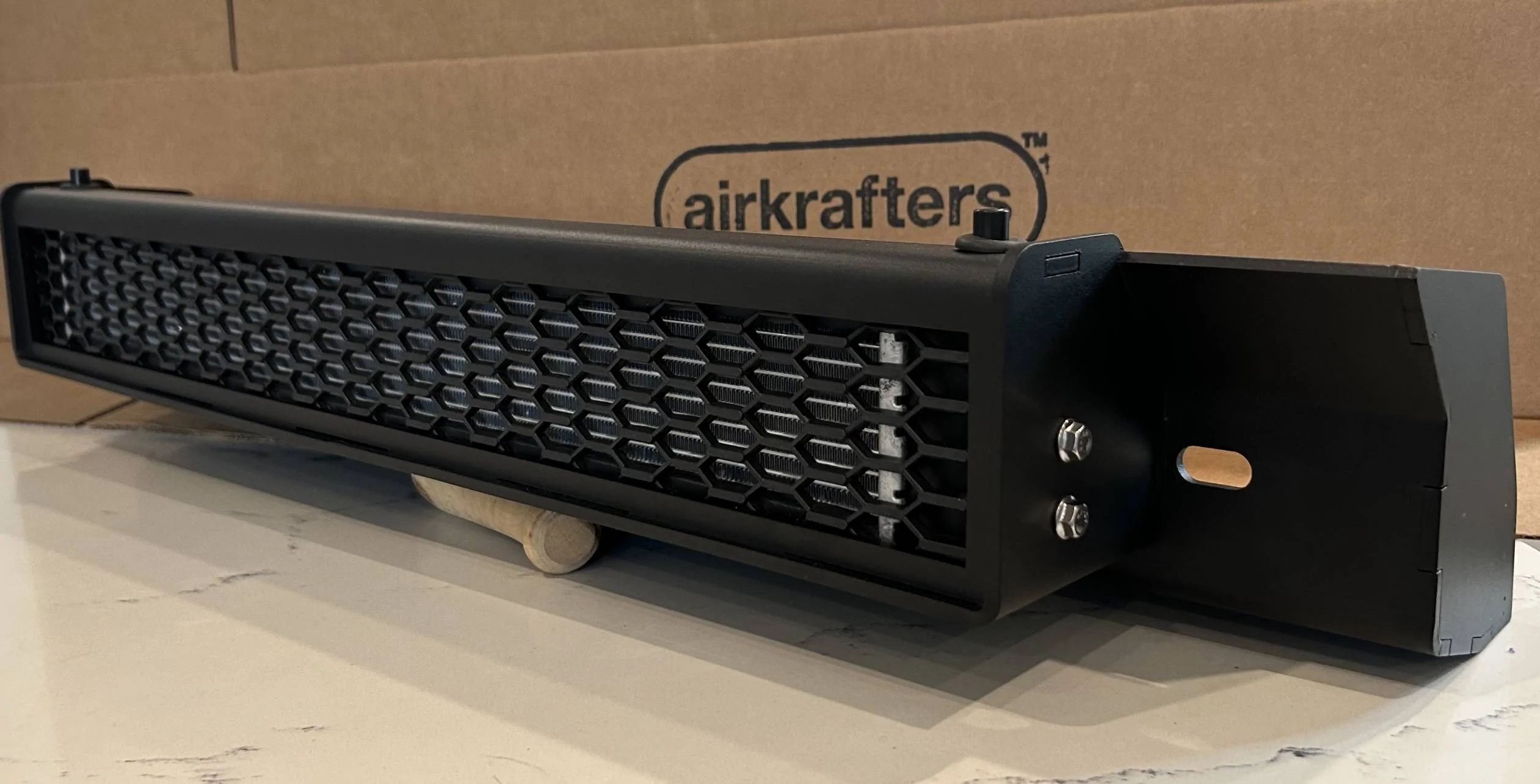

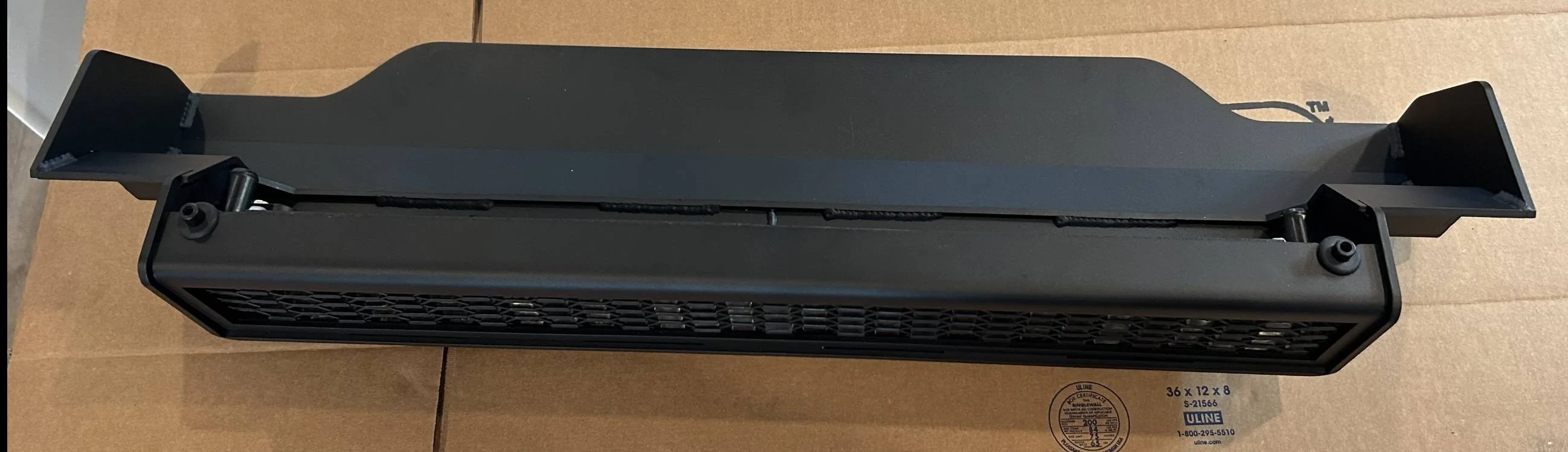

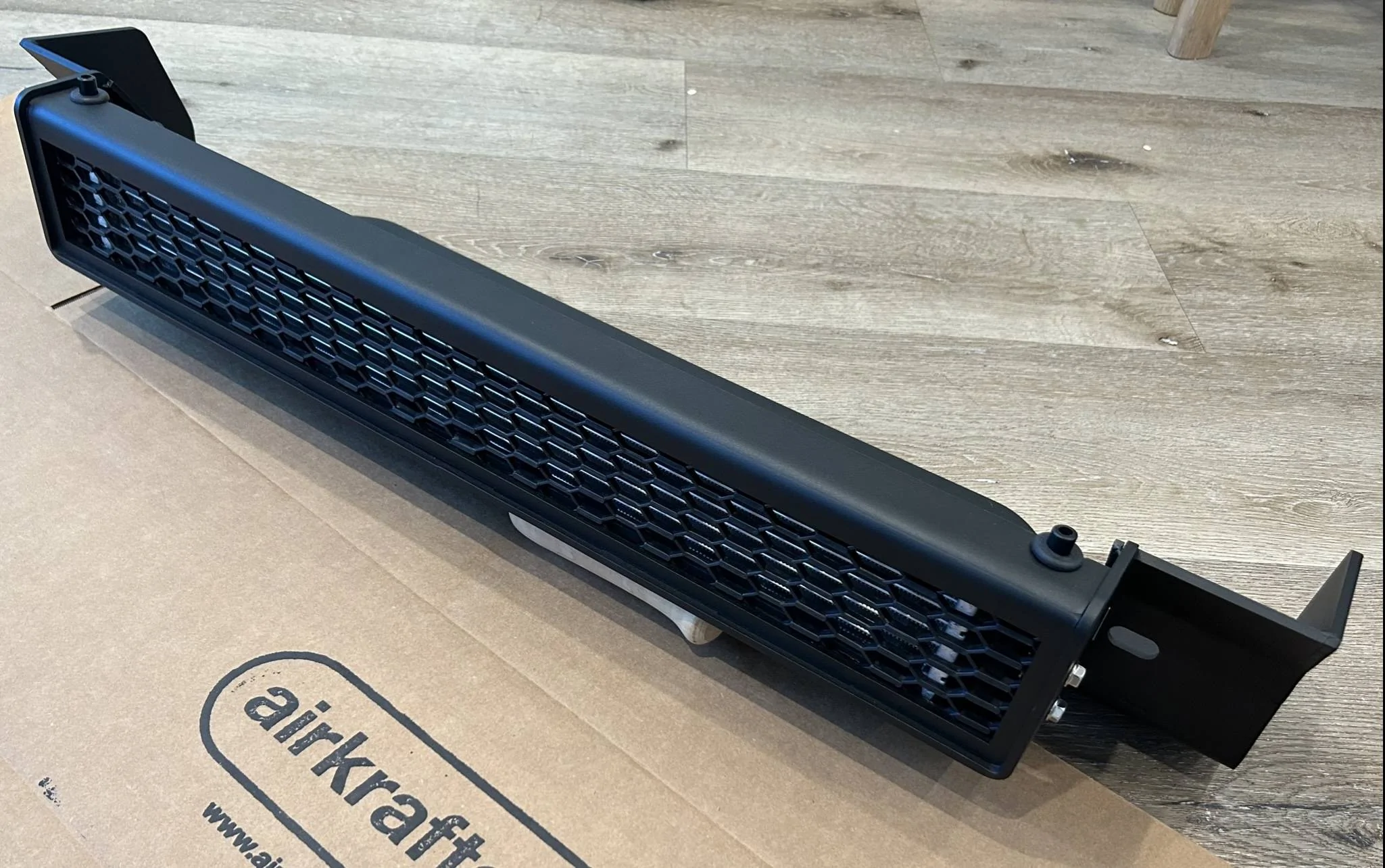

I am trying to find a home for the second prototype assembly we fabricated — only one kit is available and I will not be producing more…. I am essentially liquidating it at cost of parts/development.
This is a complete system/kit with all necessary components required for installation (BPD aux. cooler radiator, abs hex grille mesh, 3/16 HRPO skid plate — surface sandblast preparation with galvanic solution preconditioning, textured black powder coat ARB equivalent finish, 10ft. of 5/8 ID heater hose, 5/8 hose barb circuit connector, tension hose clamps, looped hose restraints with 1/2” m6 aluminum mounting spacers, etc…)
The entire assembly attaches to the frame pylons with 2 forward facing bolts — so the cooler is easily removable in about 5 minutes if rock crawling is on the agenda (you’d just need to complete the cooling loop with a barb fitting). So in that sense, the whole assembly can be rapidly deployed when your driving circumstances require additional cooling capacity.
PM if interested —
note to moderator: this is not intended to be a commercial post and is not sanctioned or approved by BPD. and company.

Here’s the available assembly — just back from powder….
That looks amazing!
I sure would like to get my hands on one that fits the OEM steel bumper before next spring.

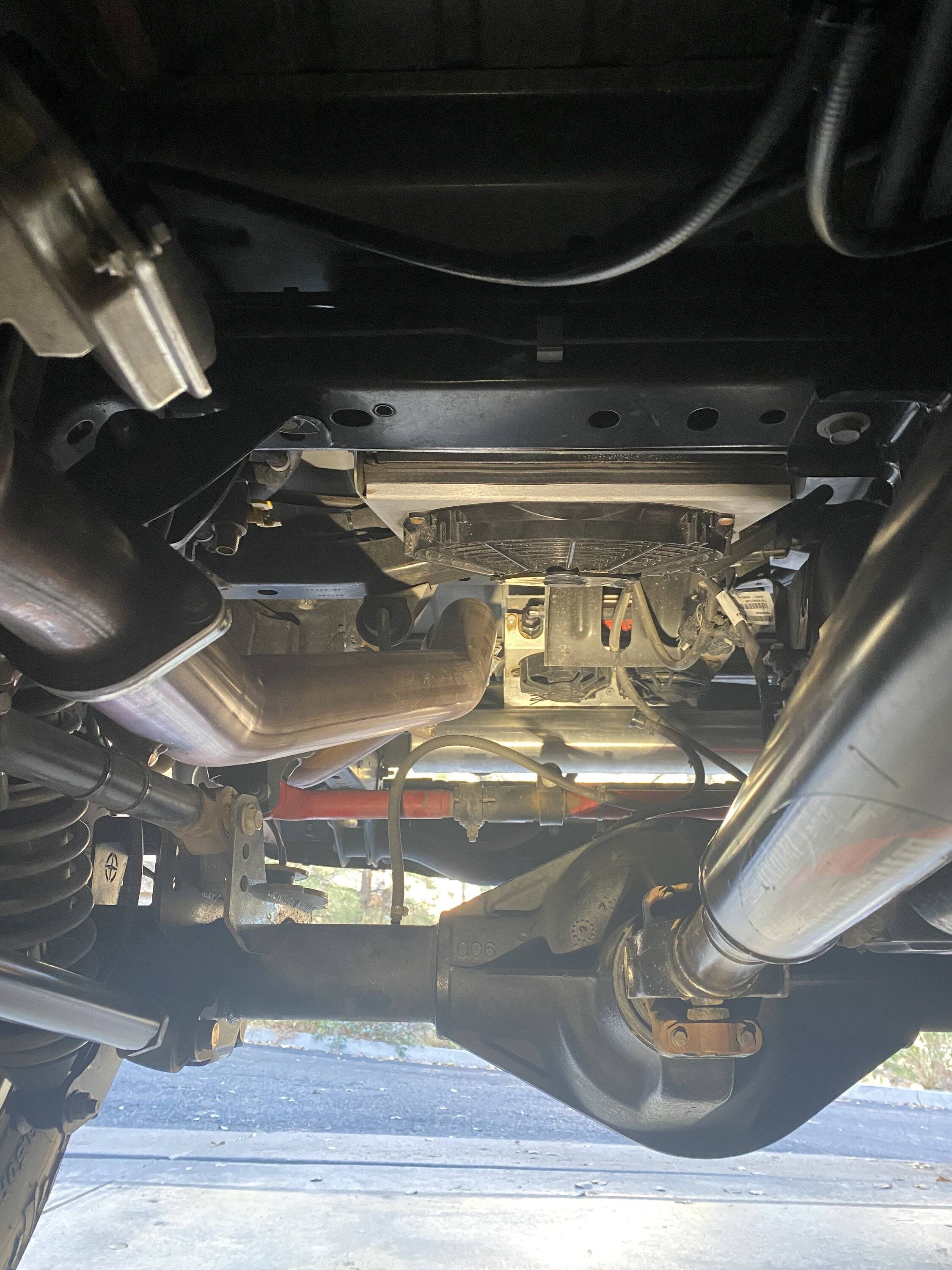

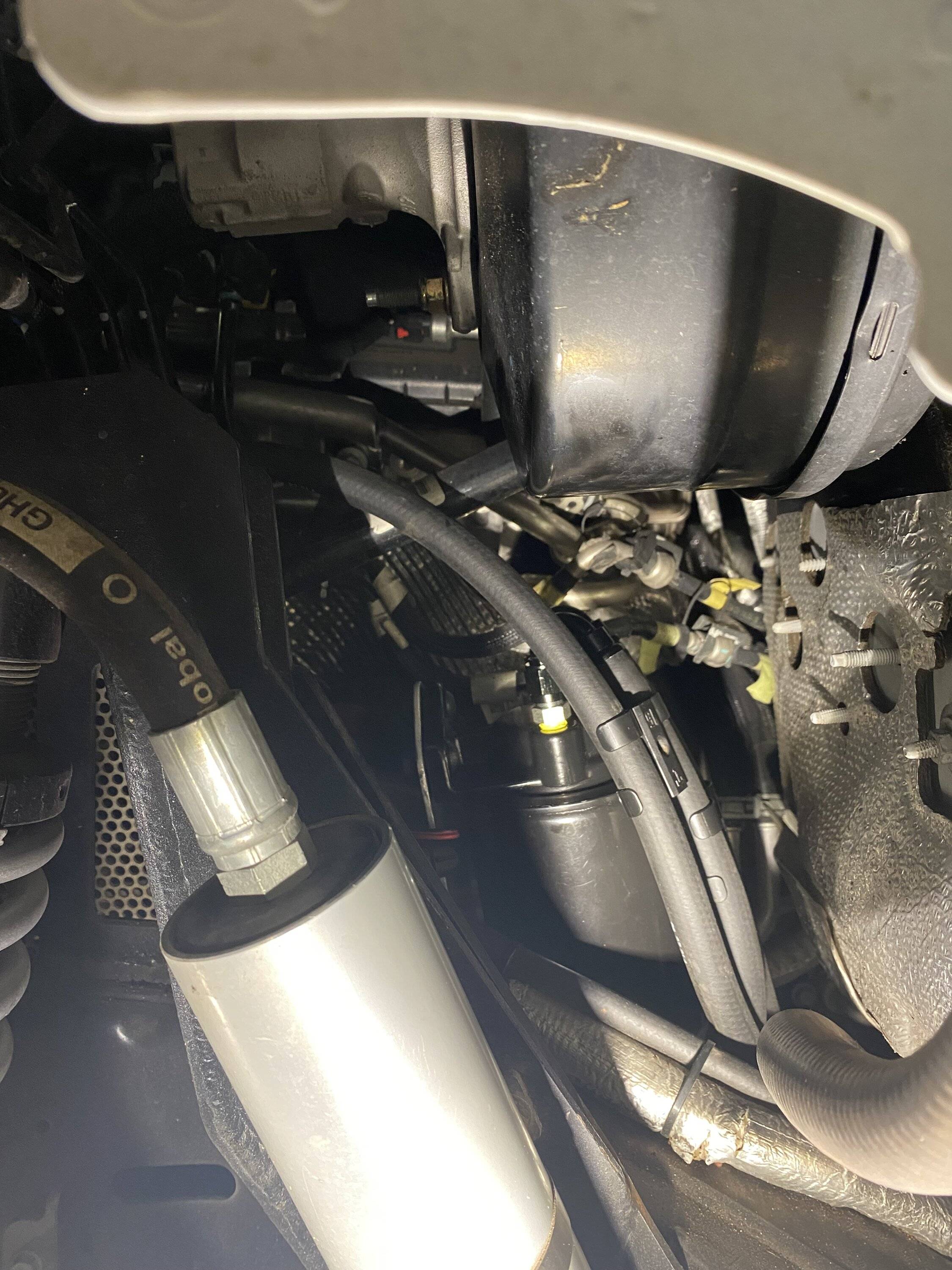

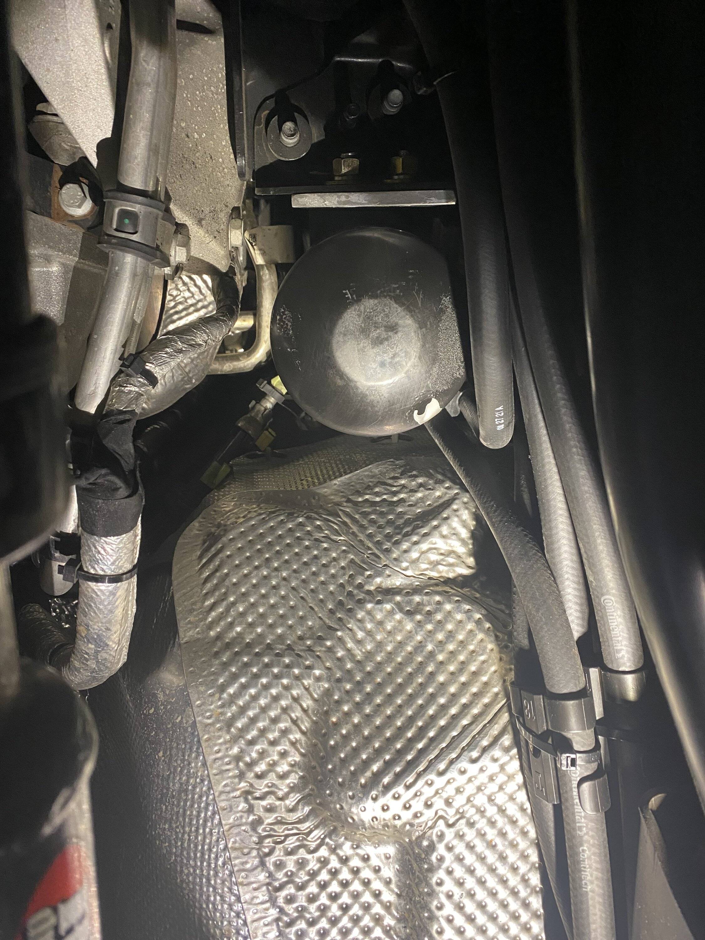

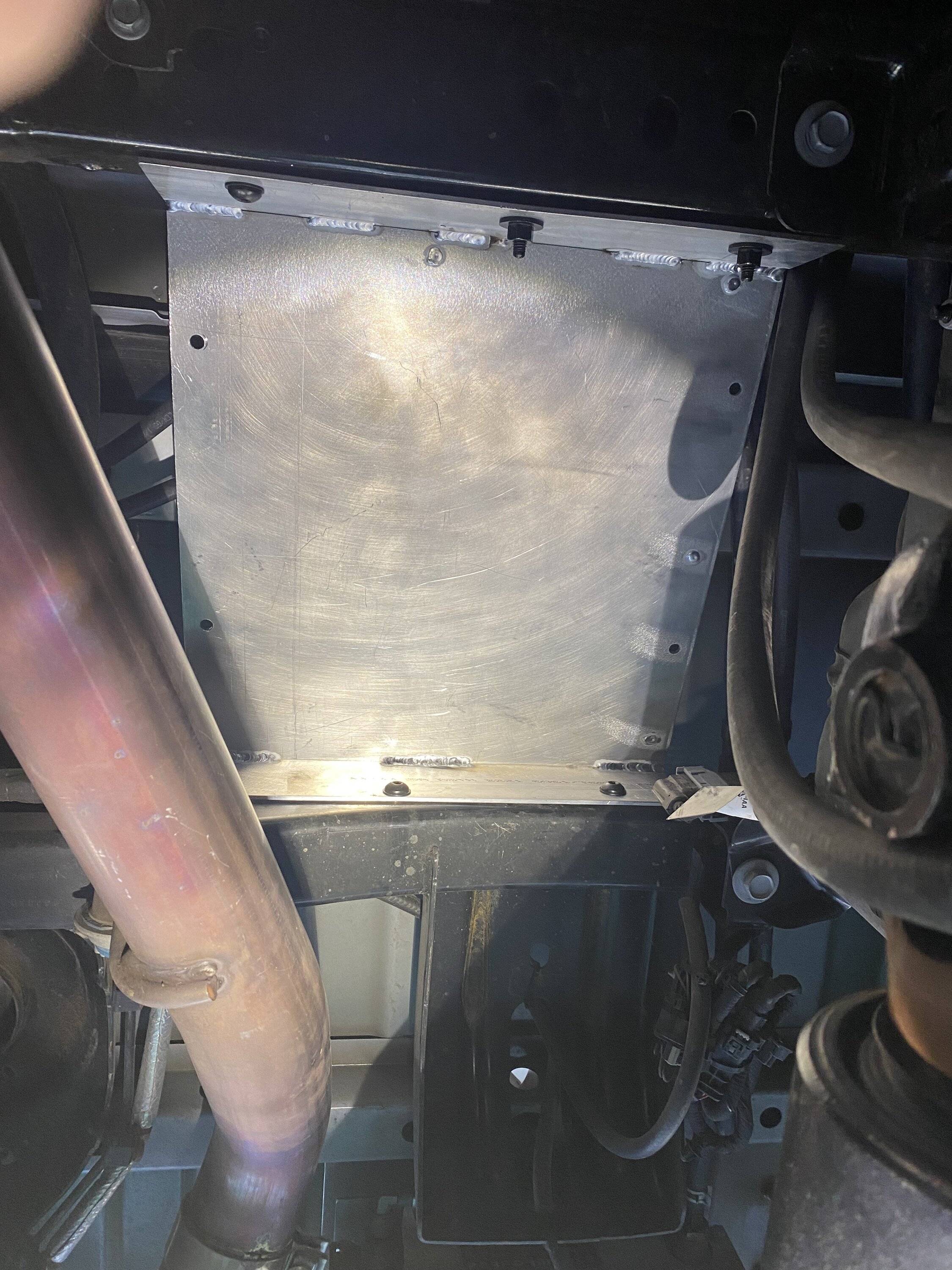

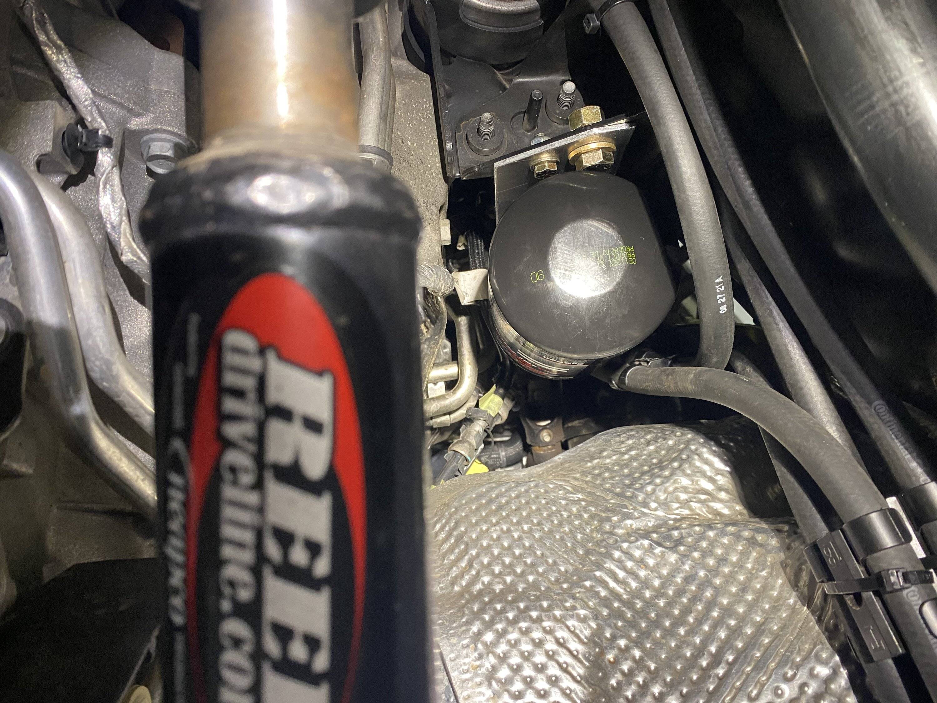

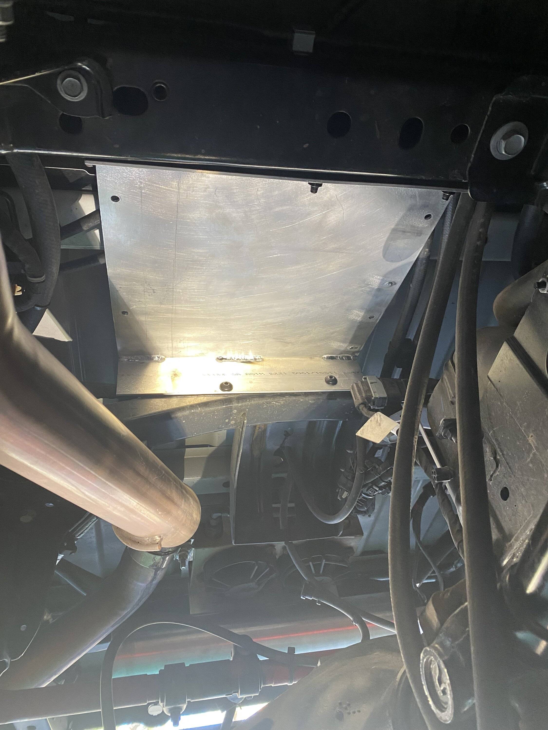

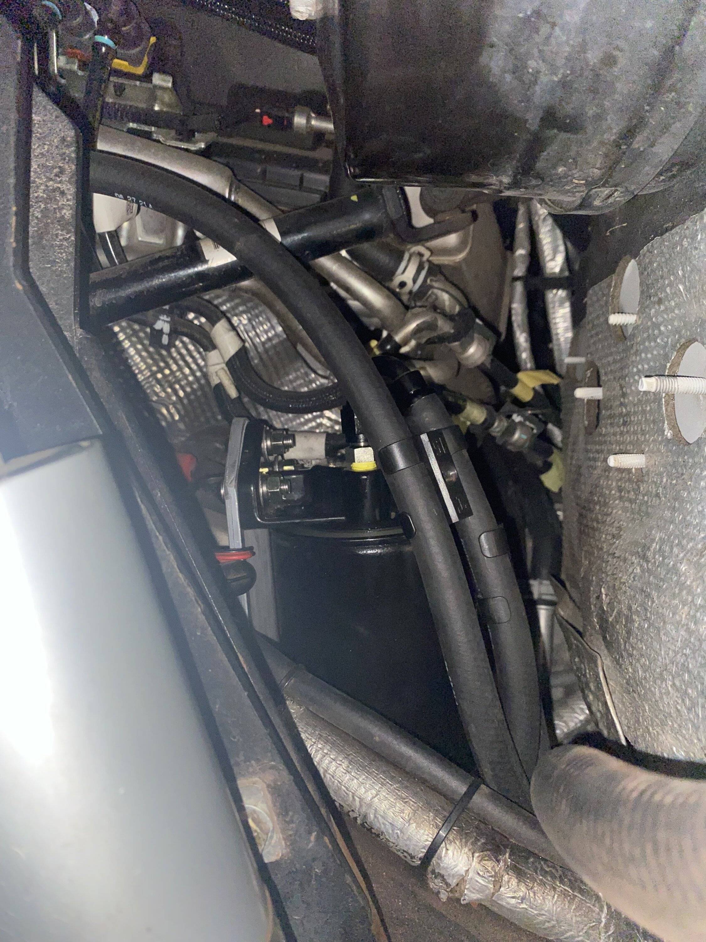

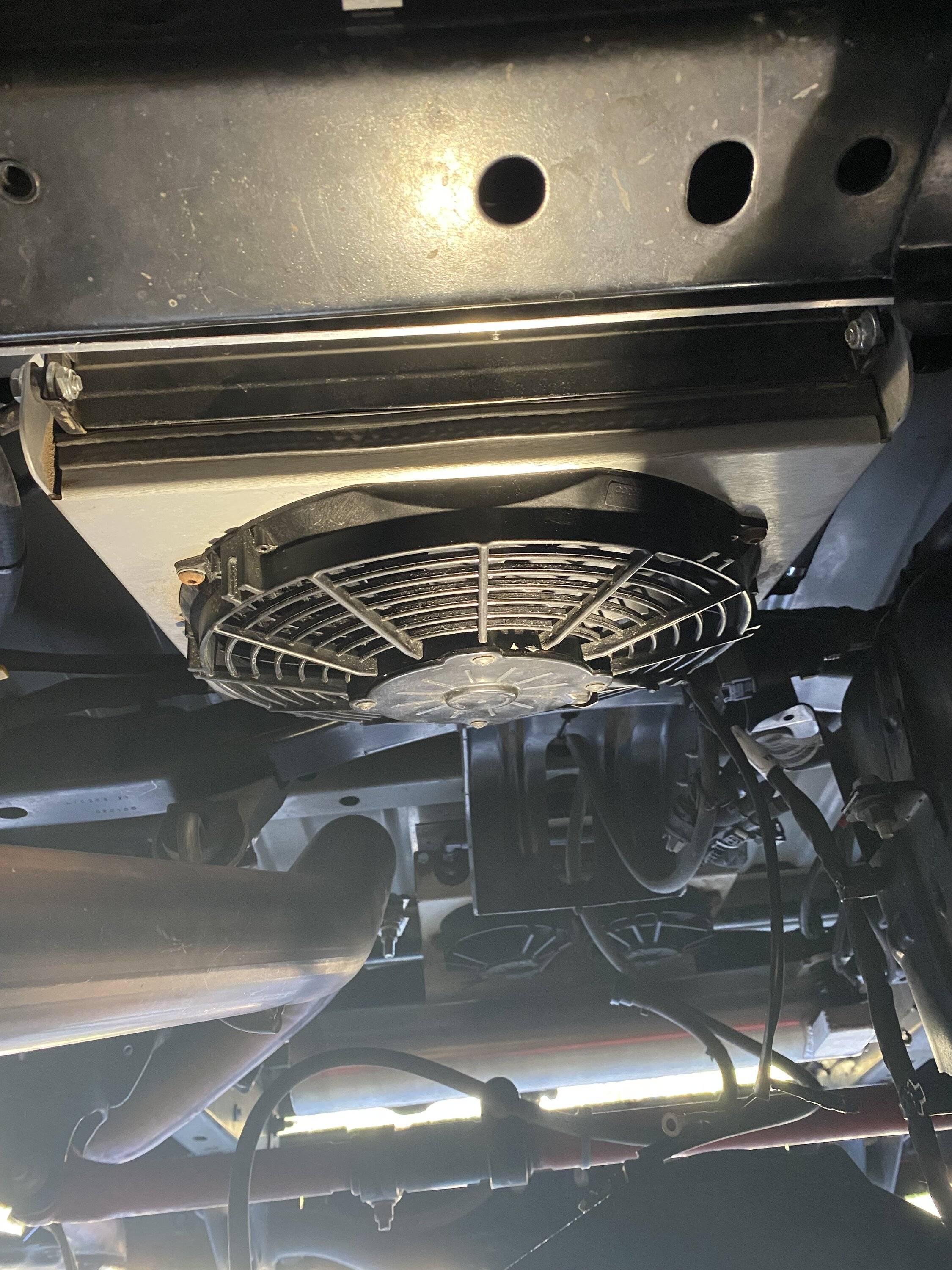

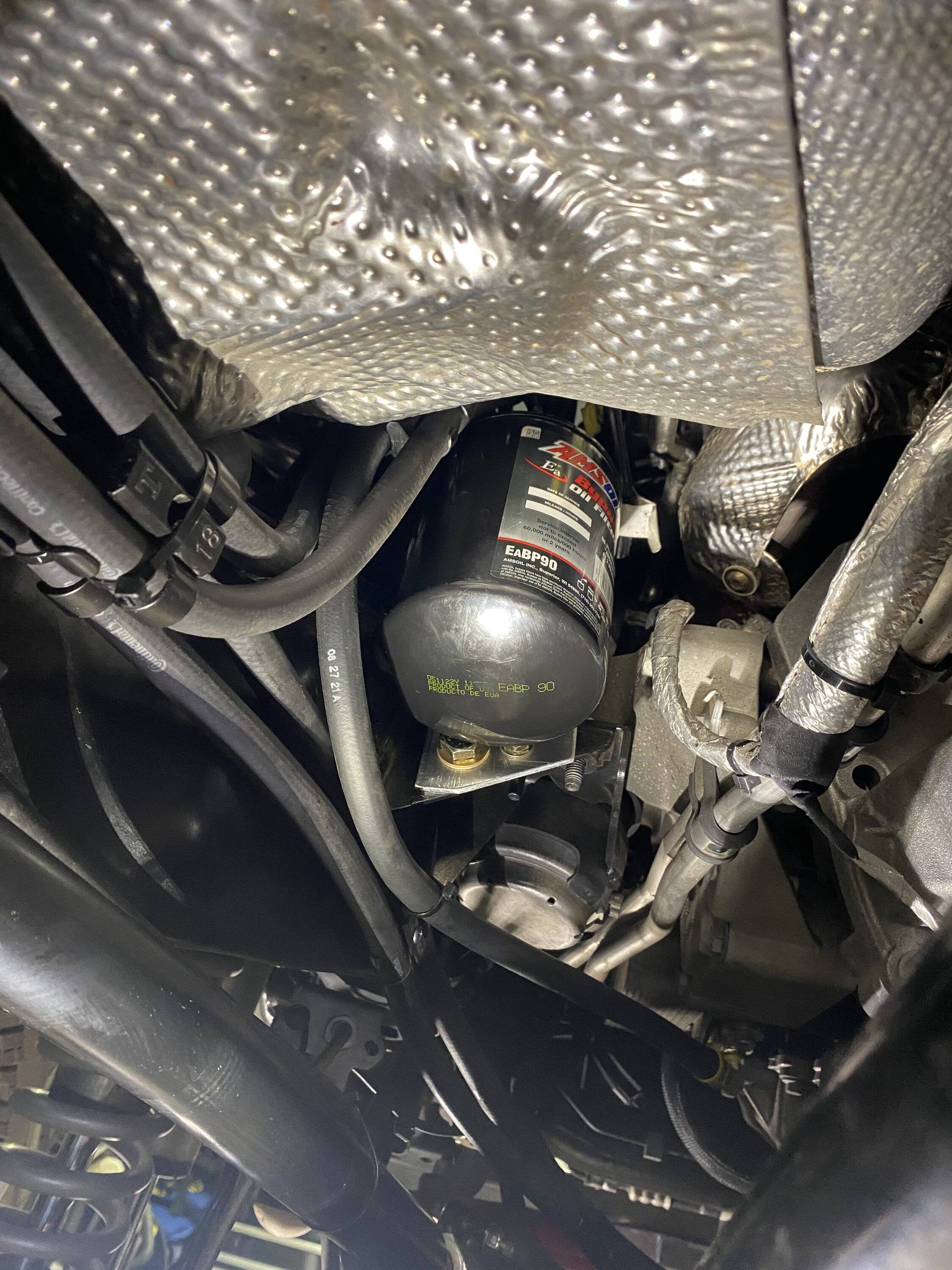

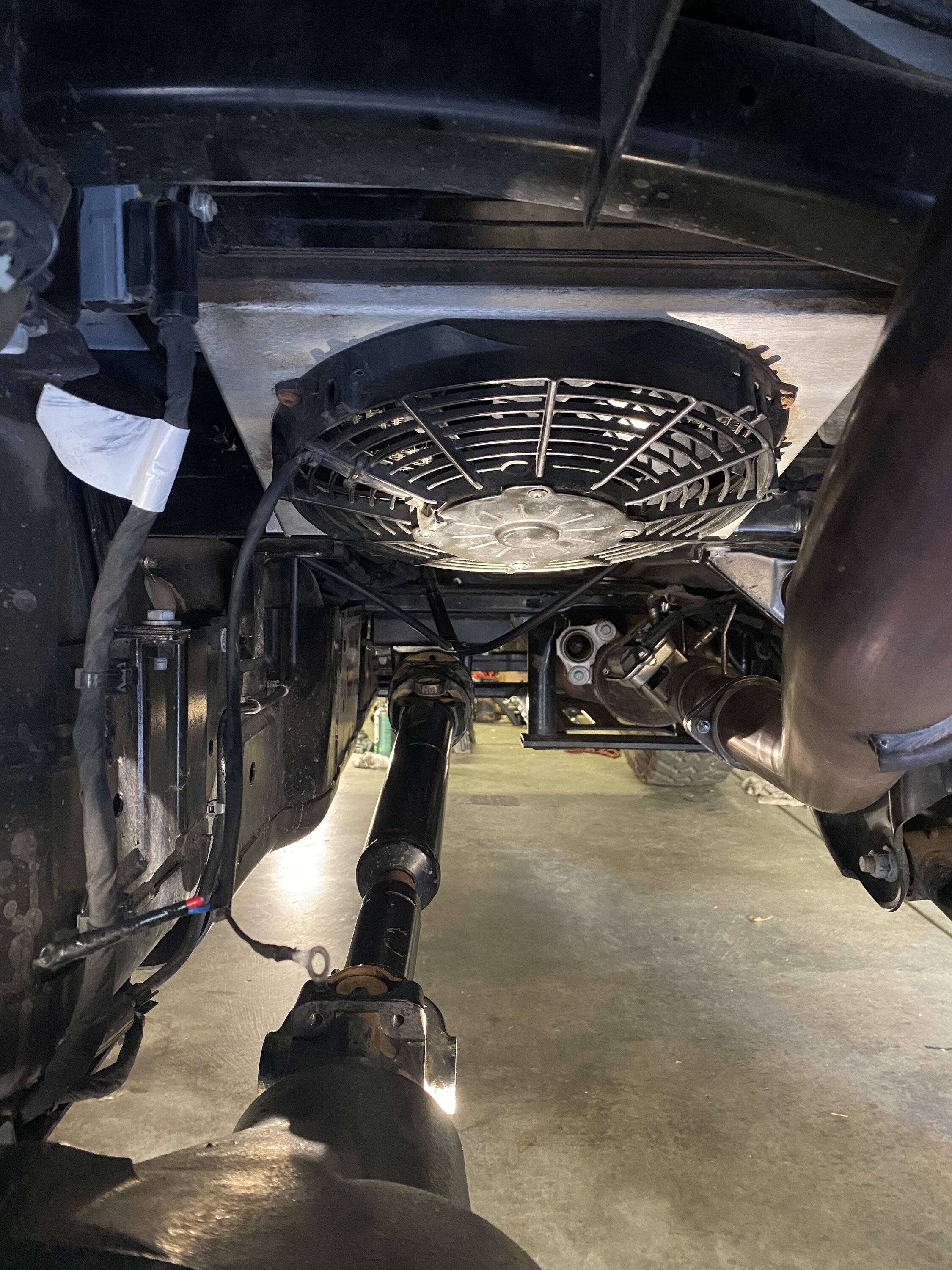

It’s been awhile. I need to update my ID bypass oil filter plus oil cooler experience posted earlier in this thread.
The short Version….the ID part of the system has been removed and replaced with a universal Amsoil oil bypass system.
The ID bypass oil filter housing would leak at the first freeze of winter. My only complaint.
The ID system is up for sale in the marketplace with full disclosure.
The Amsoil bypass oil filter system has been installed for 6 weeks plus and several thousand miles. This is not an engine specific kit. It took several install/uninstall to get the proper output size hole in the new bypass housing. This is needed to maintain factory oil pressure as delivered from the factory. The hole size is 1/16.

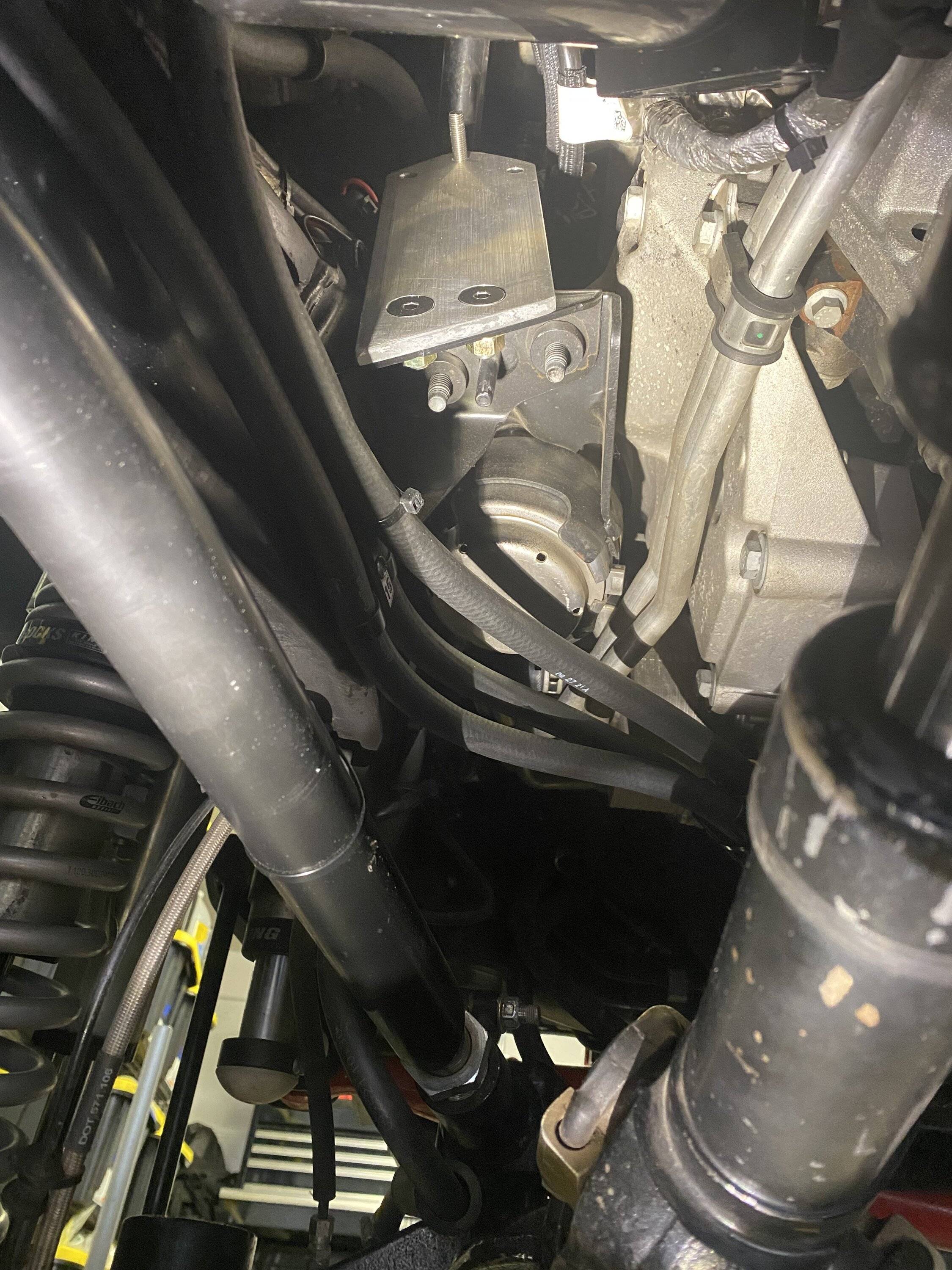

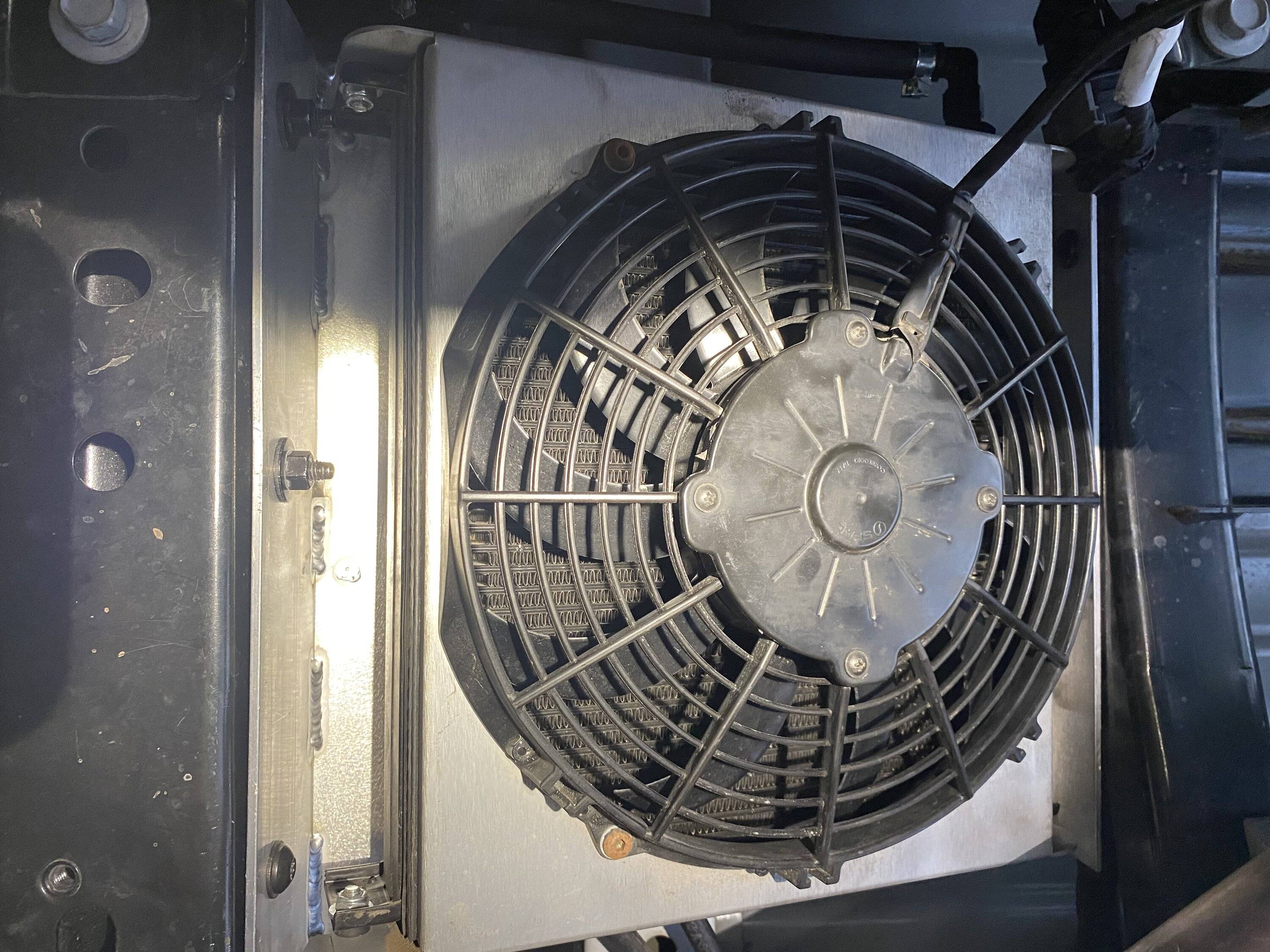

During this upgrade I relocated the oil cooler from the spare tire area , forward over the driveshaft, at the front of truck bed. Also, installing the cooler at an angle. I plumbed the cooler so that it fills completely before pushing oil back to the engine. This cooler change made a huge difference in oil temperatures. 20 plus degrees with fan on. Without fan on I can cruise up grades at 75 mph with 230 degree oil temps. Before oil cooler I would hit 248* below 70 mph. Same grades. At 75mph I’m at 2100 RPM.
