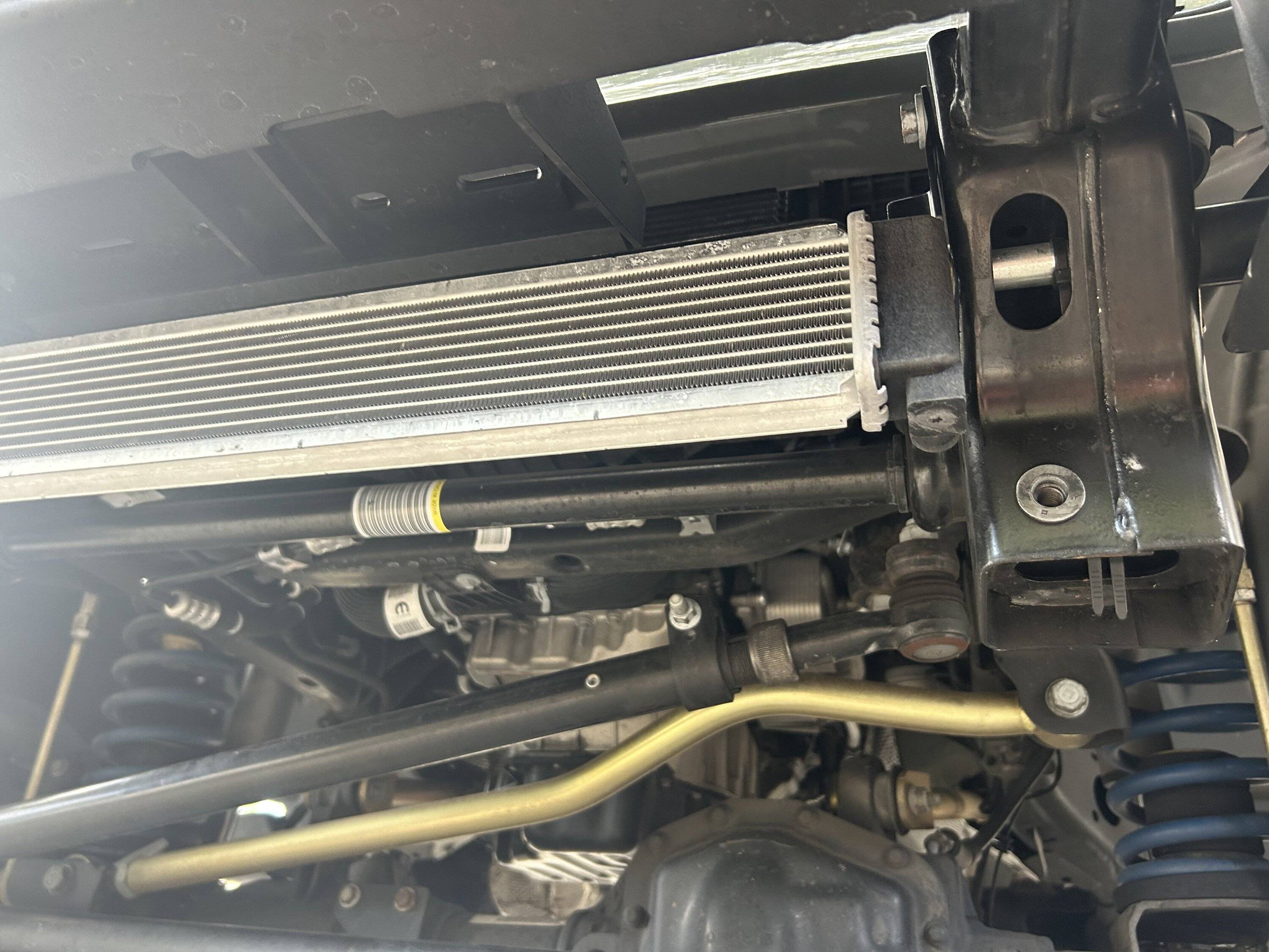

With the bulletproof cooler in hand along with an aftermarket bumper,my best spot for myself personally is where the rubicon sway bar disconnect is. Since the plan is already the antirock sway bar I think personally that is my best option for me. Pics tomorrow when I get time.

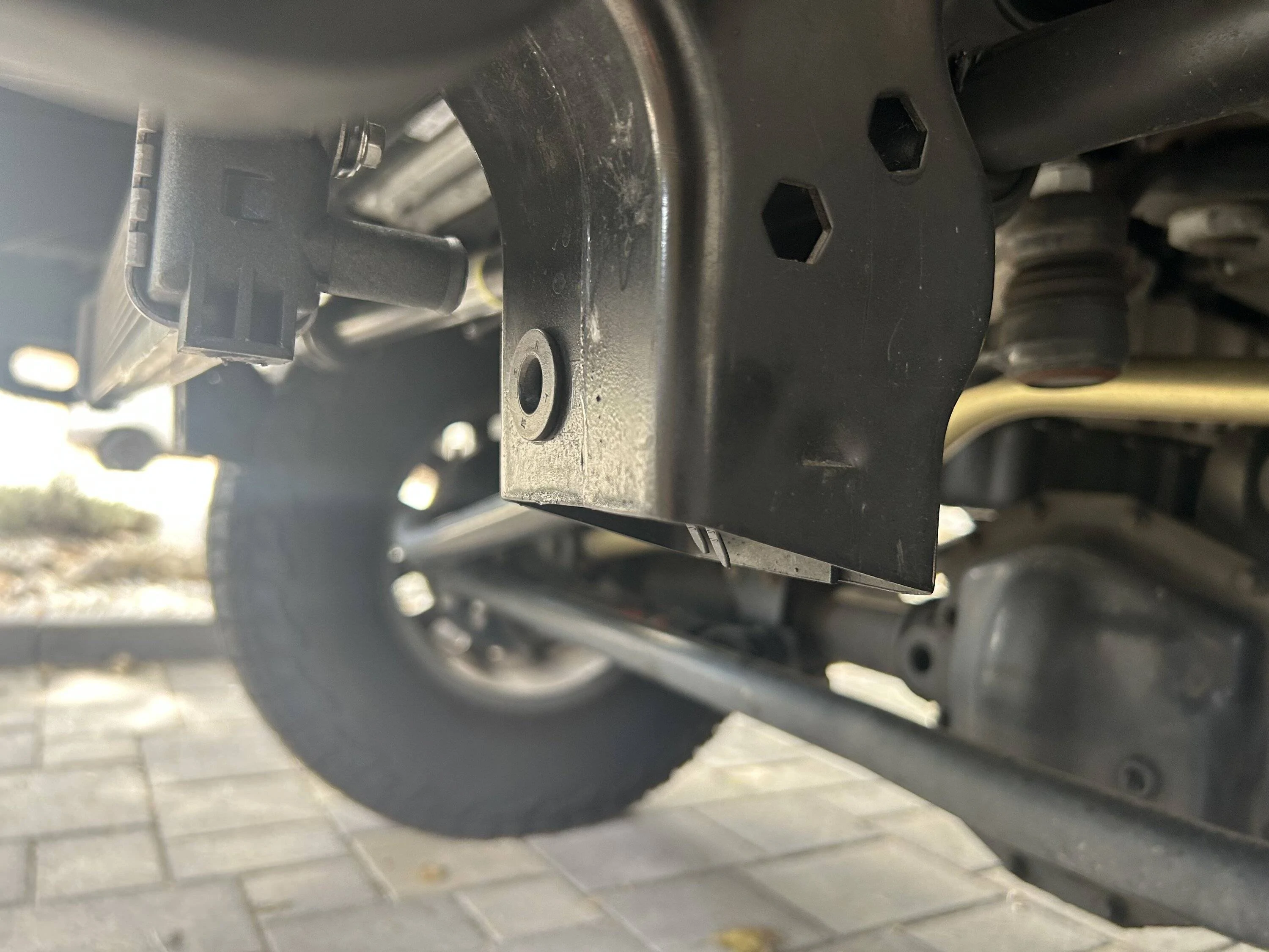

Forgot to mention about the disconnect flip. But the radiator is 26.5" wide which is about the inside distance of the frame rails so it should fit with no major issues. Main concern is the not great airflow to that part but should still be better than nothing.
