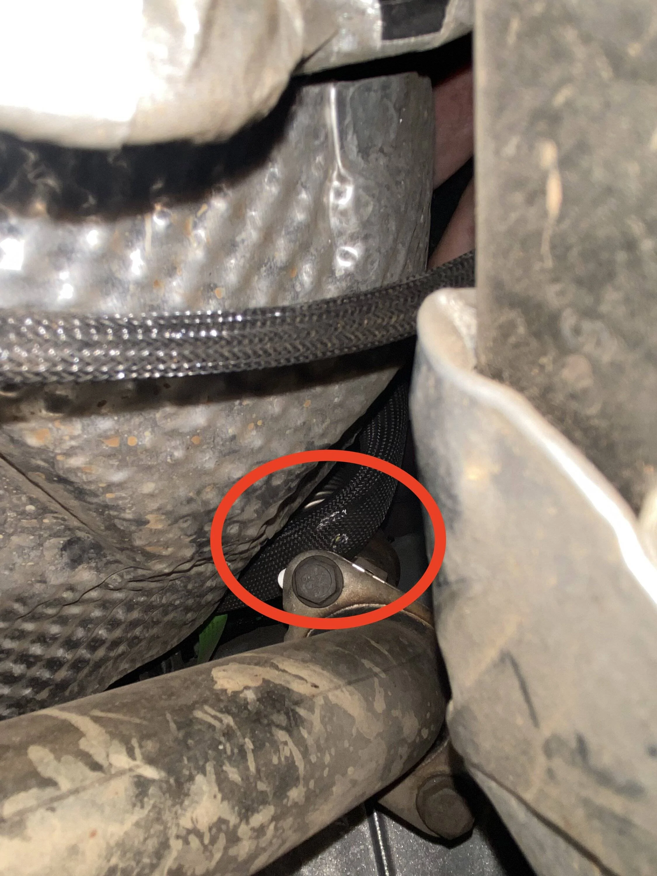

I guess you must be talking about this harness with the melty spots on it ?
Not trying to threadjack but it is interesting how these problems manifest themselves.
Yep there she is. If you're under warranty I'd have them deal with it and resleave and or repin the harness if it's damaged.

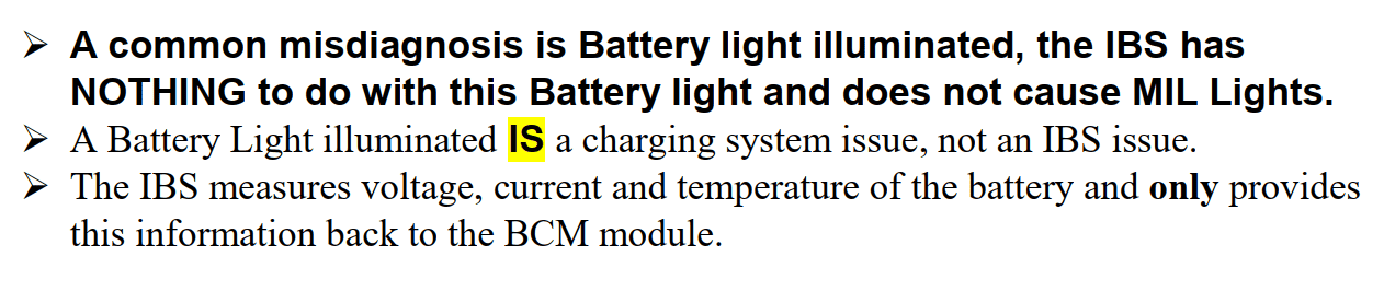

Found my notes... Here are the codes I wrote down
BCM - 61514-87
ABS - C121C-00
DASM - 40100-00
DASM - P2227-00
PTS - 40415 - 00
I also remember seeing the battery lit up as well... I thought that was strange because my dealership supposedly replaced both batteries less than a year ago.
That's charging system malfunction indicator.

The wiring in these Jeeps is soft. Multiple people having issues with broken wiring around the doors and door pins. Imagine if the heat wrapping is melting what’s going on inside this harness. I bet alot of issues people have with derates are from that stupid wiring.

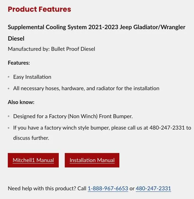

I spoke with the guys at Bulletproof Diesel this afternoon about the aux cooling current kit and for those of us with the OEM steel bumper. They were not aware of that option at the time of purchasing their test truck or at the time of production. They are however working on a solution for the rest of us starting next week.
I wanted to post this info up so that they don't get bombed with a bunch of calls asking the same questions. I also thanked them for investing the time and money to acquire a test truck and actually produce a kit for us. It sucks that production is ending and they may not even see a good return on that investment.

I ordered the bulletproof diesel cooler today. It's going in mid September. Normally it goes on the bumper horns on the stock bumper, which I have cut off. There is a place to put it further up, which is probably a better location anyways. I'm assuming the brackets will need a little work or I'll have to get custom brackets made but it should fit either way. I'll update once I get it installed.

http://www.bulletproofdiesel.tv/Files/Documents/Jeep Supplemental Kit.pdf
I suppose at this point we are going to be waiting until next year to see if this worked. I am just surprised that a suplimental coolant cooler, will be enough to help drop oil temps.
I run hot oil temps when it’s cool, it just takes longer to get there. I should know on my drive home. Talking with bullet proof it’s not the end all fix but it does help a significant amount. For the price, that’s all you can expect
