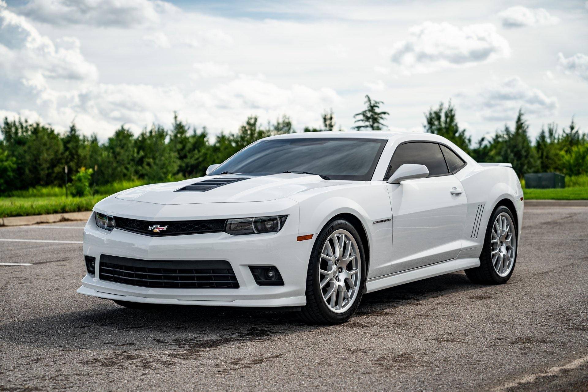

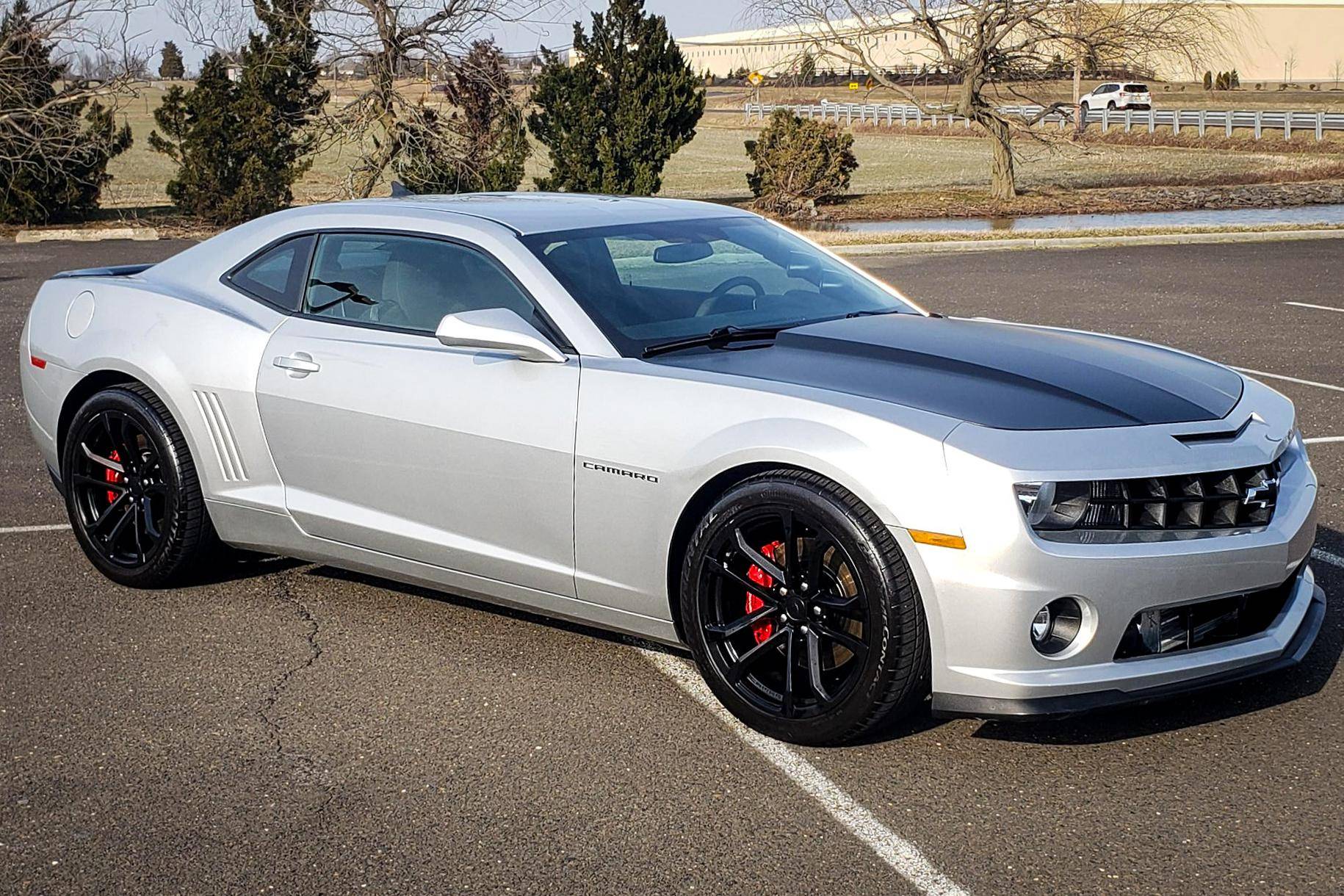

I haven't read the complete thread, so this is my 2 cents worth.
Chevrolet had some heat issues creaping into their 2010 through 2013 Chevrolet Camaros. Of course, this was an issue with hard track driving, not pulling a trailer. The major part of the solution was to add hood ventiation. The first photo is the 2013 Camaro SS, the Second the 2014 Camaro SS.
I actually own a 2014, and took it to the track 3 times, one day track driver training in which you supplied your own vehicle, and a couple of track days. Early June in North Texas, so temperatures never really got over 90 degrees F. I didn't experience any extreme temperatures, but on one outing, my friend that had a 2011 Camaro SS, his car was experiencing high temps and probably stayed parked half of the track day.
Anyway, as you can see, the 2013 has no hood ventilation while the 2014 does. Even during the summer parked at a traffic light, I can see the heat waves rising out of the hood.
I'm wondering if some sort of ventilation like the 2014 Camaro SS hood would work?

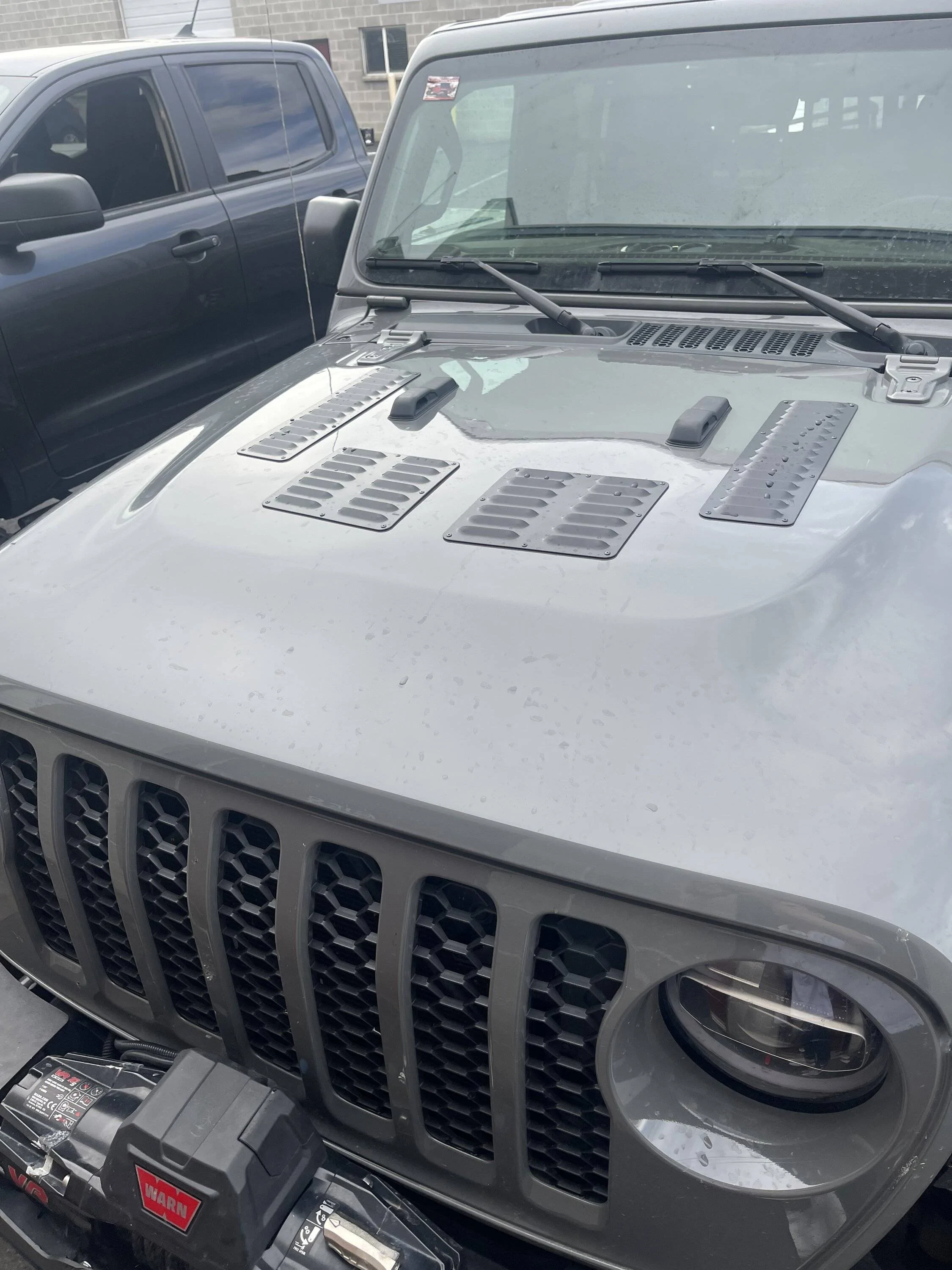

I have the poison spyder hood vent which gives you a 18" wide 12" deep square hole x2. It wont stop oil temp overheat. It does make it cool down drastically better once you crest a tall pass.
I still saw 250 regularly uphill at 70-75mph. Never got higher. With a freedom ECU and a freedom pipe ive seen some jeeps run 230-235 oil temp uphill without going higher where a stock one would be 250 plus.

unfortunately, it does not help much. At low speeds, on the trails and crawling it keeps temps lower but I wasn’t running hot in those conditions. I still see high temps going up uphill, without towing.
