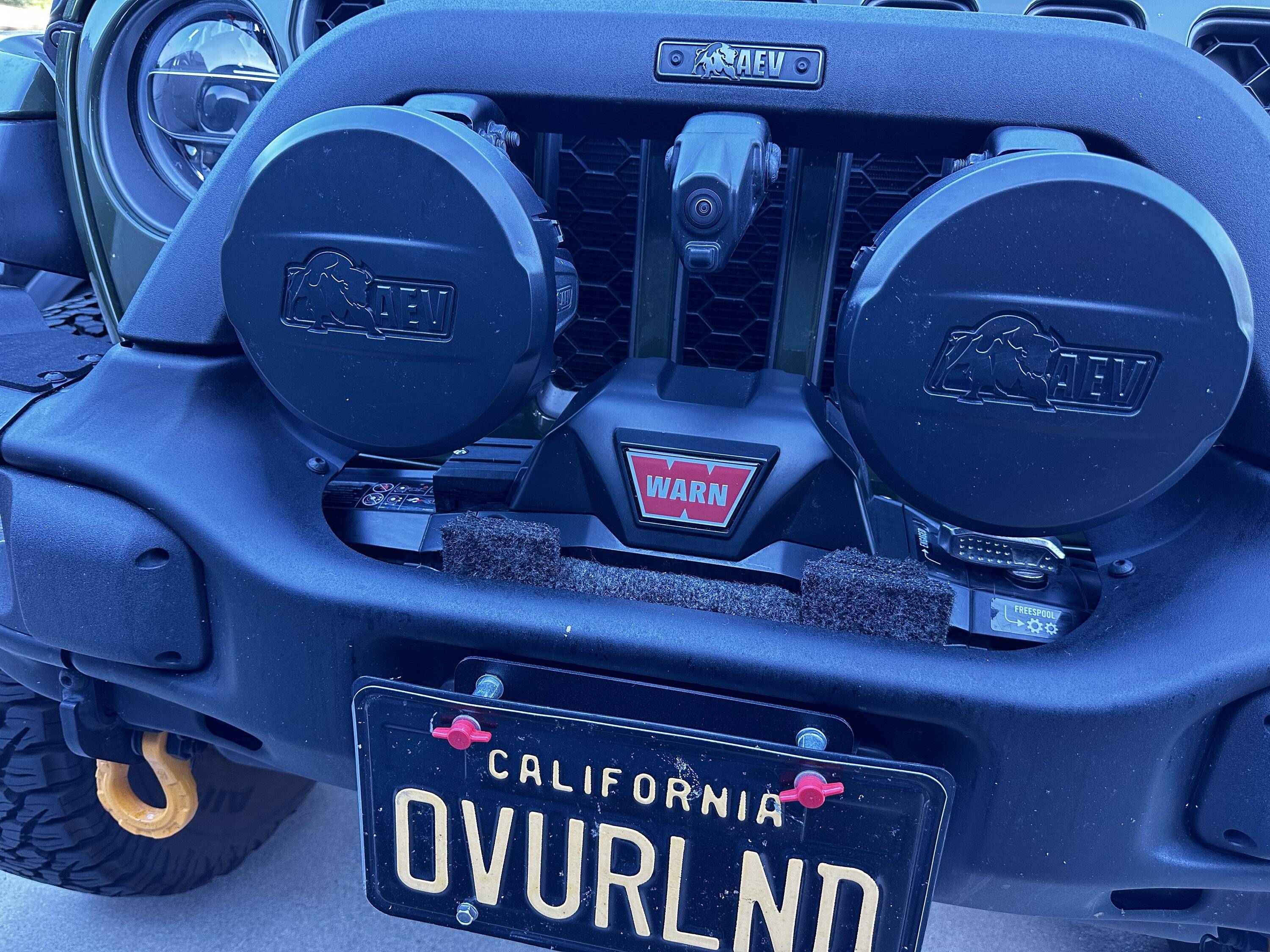

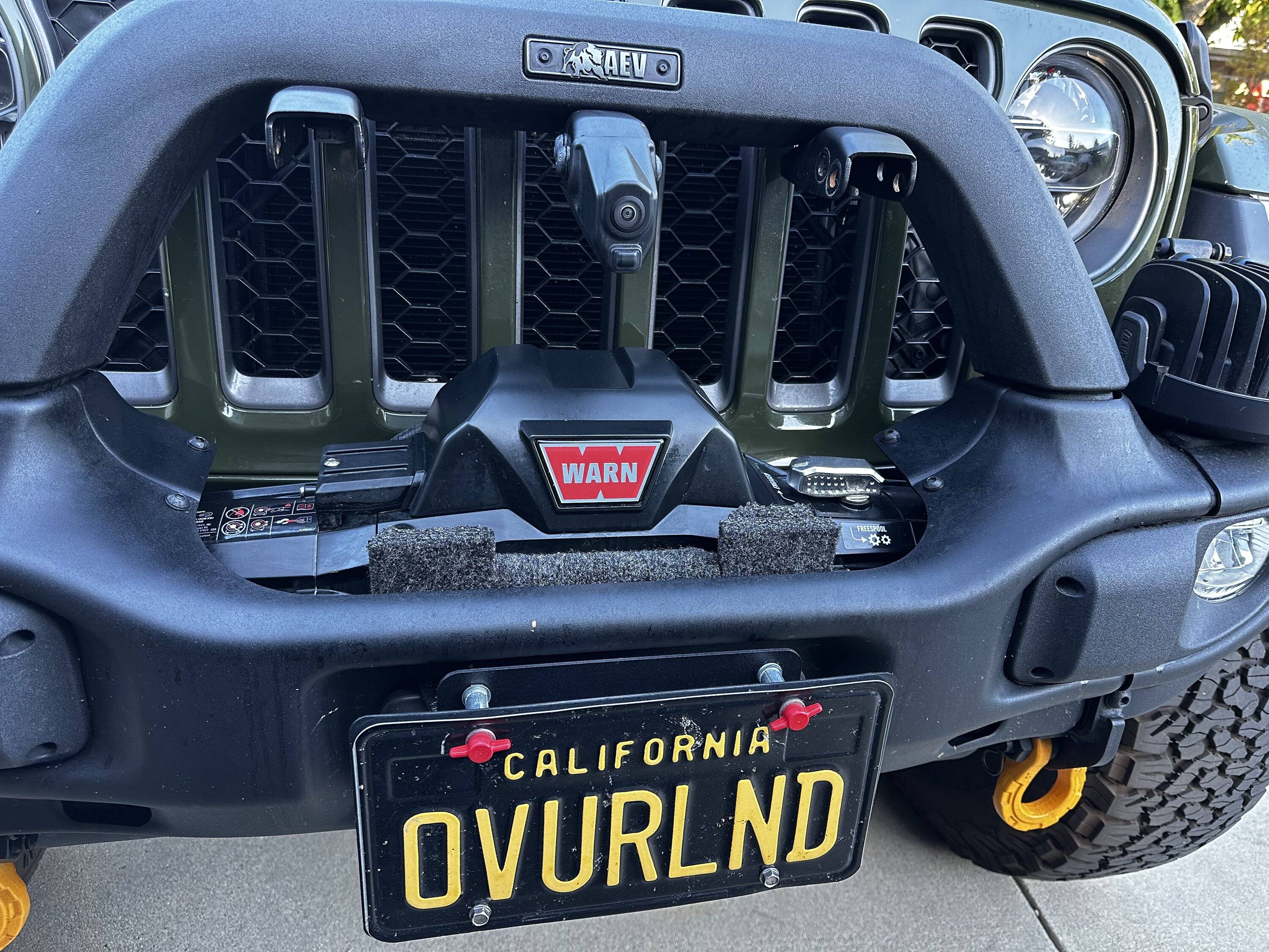

Maybe I should put the foam back on the engine and see if things run cooler![]()
