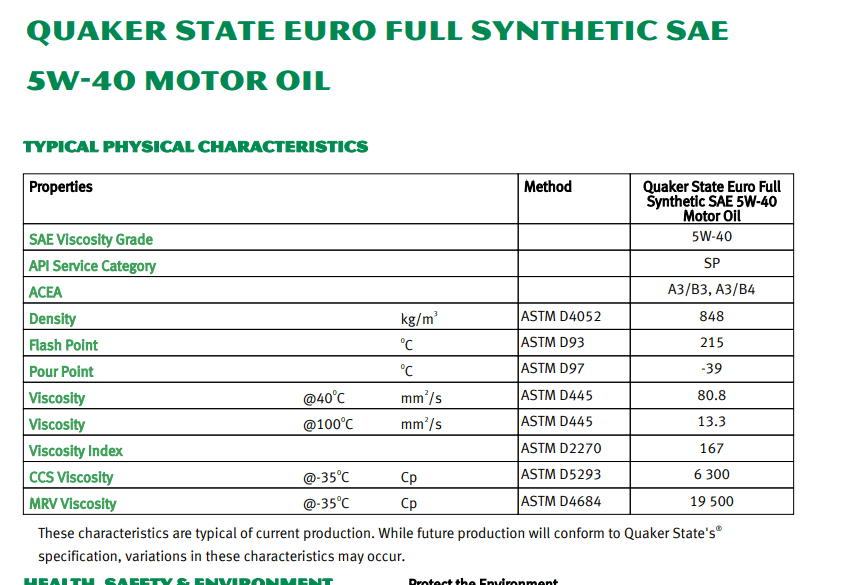

The full syth 5w-40 they recommend that meets MS-12991 has a flash point of 419 degrees Fahrenheit. Not trying to say flash is the same as thermal breakdown, just state a value at which absolute failure of oil occurs. Seems most good diesel oils all float around 419 to 450 in temps. Rotella T4 for instance flashes at 451F.

Yes, that's flash point, a different animal, but the threshold of thermal breakdown is when the light parts, often some of the protective chemistry of the oils, begin to vaporize, reducing the oil's lifespan and eventually its ability to protect.
Doesn't mean it stops protecting just that it's been weakened and the more time it spends at that temperature or above, the less effective it is compared to when it was new.
It's something I watch even on gas engines -if the oil gets hot for a length of time, I won't go as long between changes.

Is there a ASTM # for breakdown temp? Seems like it would be a important value needed in the design of a motor that is intended to run hot. (seems the trend these days, hello turbo everything)
Seems as though most oil MFRs just focus on Flash Point ASTM. Us lay folk are left with crossing our fingers and crudely drawing a parallel to oils with high flash also can hold up better to prolonged high heat. But we don't have any empirical data to back that up.

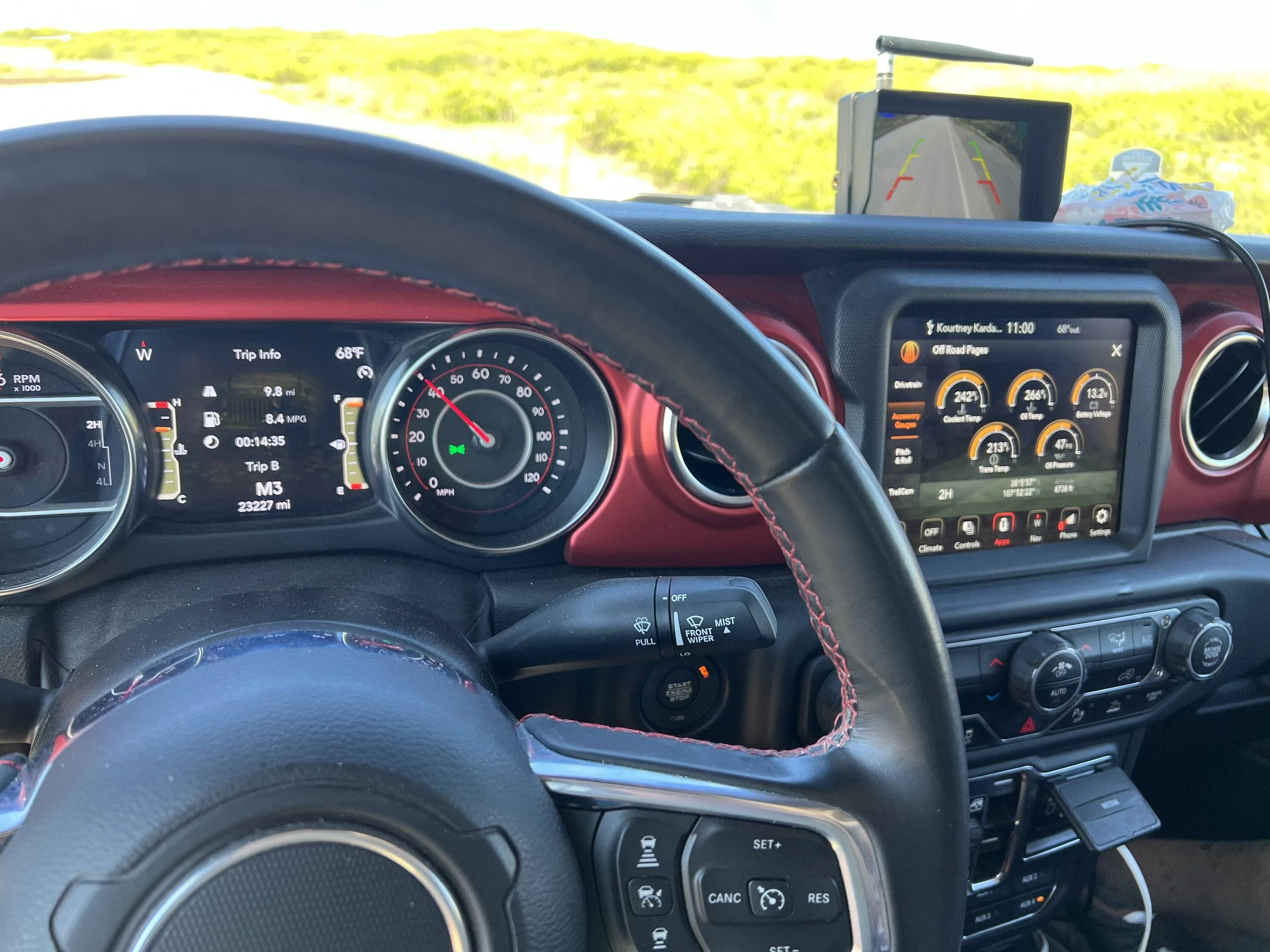

This photo was taken this morning going up Lizard Head Pass between Ouray and Rigdeway. Oil temp was 266, 3rd gear, 40mph. It went to 267 shortly after this was taken. Please ignore the Kardashian thing on the screen. My partner was charging the iPhone and it somehow came up. The low speed really wasn’t a problem because much of that road has a 45 mph limit. In spite of the climb from around 8,000 feet to over 10,000, I averaged 15.6 mpg between Ridgeway and Cortez. Not bad pulling a 5,000lb trailer. Worst was Twin Falls to Nampa, ID, 10.1 mpg.
Jeep Gladiator Diesel cooling options and ideas IMG_8778
