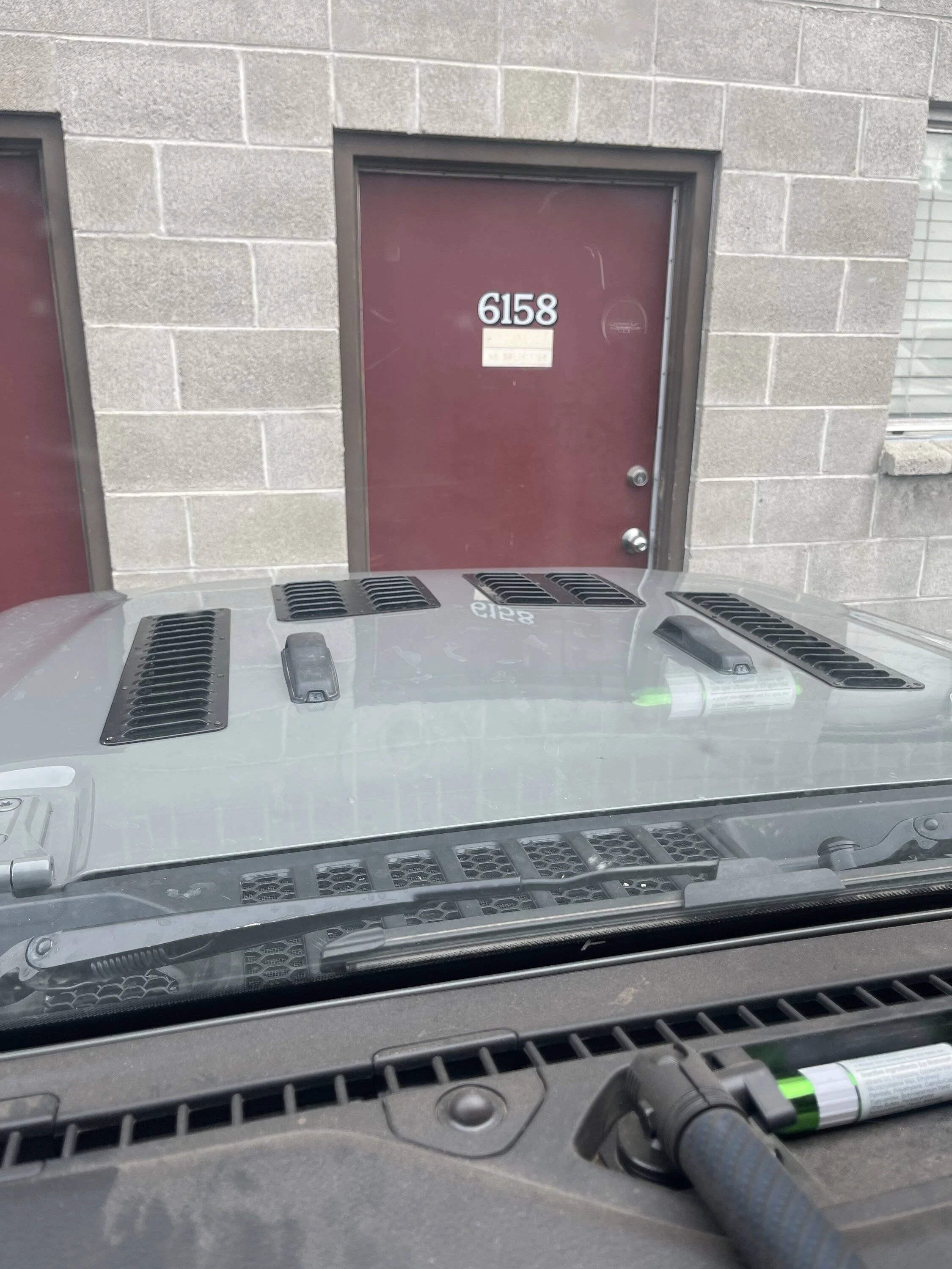

installed hood louvers and took off the engine cover and foam pieces that @Rusty PW recommend.

Those look like TrackSpec hood vents.
https://trackspecmotorsports.com/universal
i got them from genright. But they do look very similar.
Unfortunately it didn’t seem to help that much. I still saw 250 oil temps on my drive home up the steep grade. It’s about 3000ft over 10 miles. It seemed to take longer to heat up but it’s definitely not the solution.

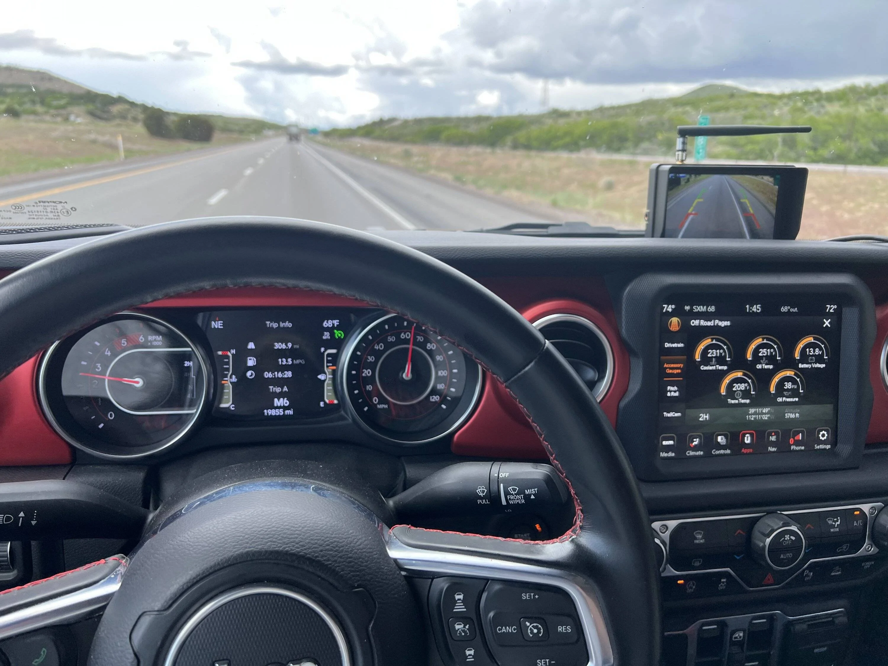

I promised to post some pictures on our trip. This one was taken between Provo Utah and Snowville on a moderate hill. Ambient temps were low today until we got into Idaho. Winds were very bad and were mostly against us. Some really big hills forced me to drop to 55mph a couple of times. Highest observed oil temp was 258, briefly, on a long. hill. My DEF consumption was extremely high in my opinion. 2+ gallons in less than 1,000 miles. I’ll try to post some more. Wind made it difficult today.

I meant to mention that this is pulling our 22 foot Rockwood Mini-Lite trailer. Best mileage on trip so far was Flagstaff to Page (18.7@ 55-60mph) worst was Snowville to Twin Falls (11 mpg, 60-65mph).
Has anyone installed a cold case radiator and if so did it actually help.
It helps if you ever stop in the heat. If you turn the truck off then get back in in 10-15 the temps are crazy high from the factory. It heat soaks everything and gets hotter then will derate when mergin on the highway. Now with all the venting it actually cools down when engine is off. Realllyyyy helps off-road when starting stopping ona. Trail.
I haven’t seen high oil temps off roading yet. The only time I saw increased temps was going fast on dirt roads for an extended period. Crawling the temps stay low. It probably helps that I use the tazr to turn the radiator fan on high.

No heat under the steering wheel that I could feel. The AC in our rig works very well. Lots of wind and hills from Nampa to Hood River today. Worst fuel mileage I have gotten, even on the flat or descent. Had to slow to just under 50mph a couple of times to control the oil temp. Highest temp today was 262. Wanted to take pictures but just too much wind and big diesels passing to risk it. Temps dropped immediately on the downhill, load reduction and/or shifting down when I could.
