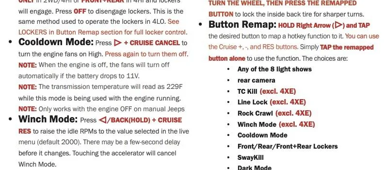

How did you get your tazer to do that? I'm not seeing this as an option or maybe I'm just missing it.
Can you do this while driving or only while you are parked?
Jeep Gladiator Diesel cooling options and ideas Tazer
Cooldown Mode...I use it when climbing hills... anytime we are on a long drive (Two Thumb Salute ™)

Just chiming in to say was quite surprised in how the Tazer’s max radiator fan speed has helped in high oil temp conditions. Haven’t had a chance to try it in warm weather yet obviously, but when snow wheeling through deep powder I saw oil temps at 240ish. Kicked on that max fan mode and temps dropped 20 degrees within minutes.
I wouldnt expect that same level of results during the summer, but I’m curious to hear if anyone has tried it?
It works well in the summer heat also. If it is hot and I know I have a steep grade ahead of me, I will kick on the high speed fan. It really slows down how quickly the oil temperature rises. It will also help drop the engine temps if it's already hot. I have never had my JTRD go into limp mode due to oil temperatures.
