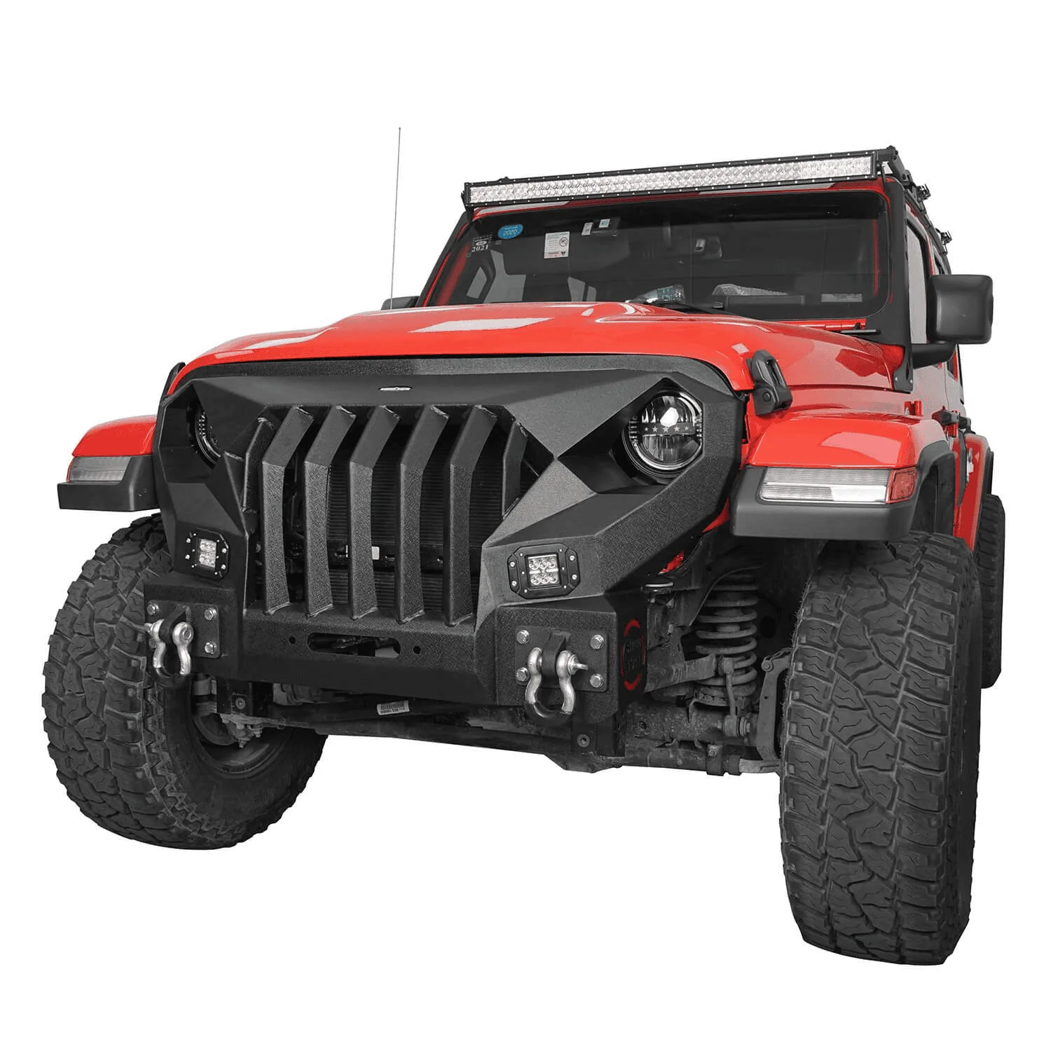

lol what crap up front? My bumper and winch don’t block my grille. Also, I don’t tow. I drive a lot of steep grades and don’t see oil temps over mid 220s. They could be lower but that’s not overheating.
Ah apologies, I thought yours was the one with the bullbar and huge fog lights.

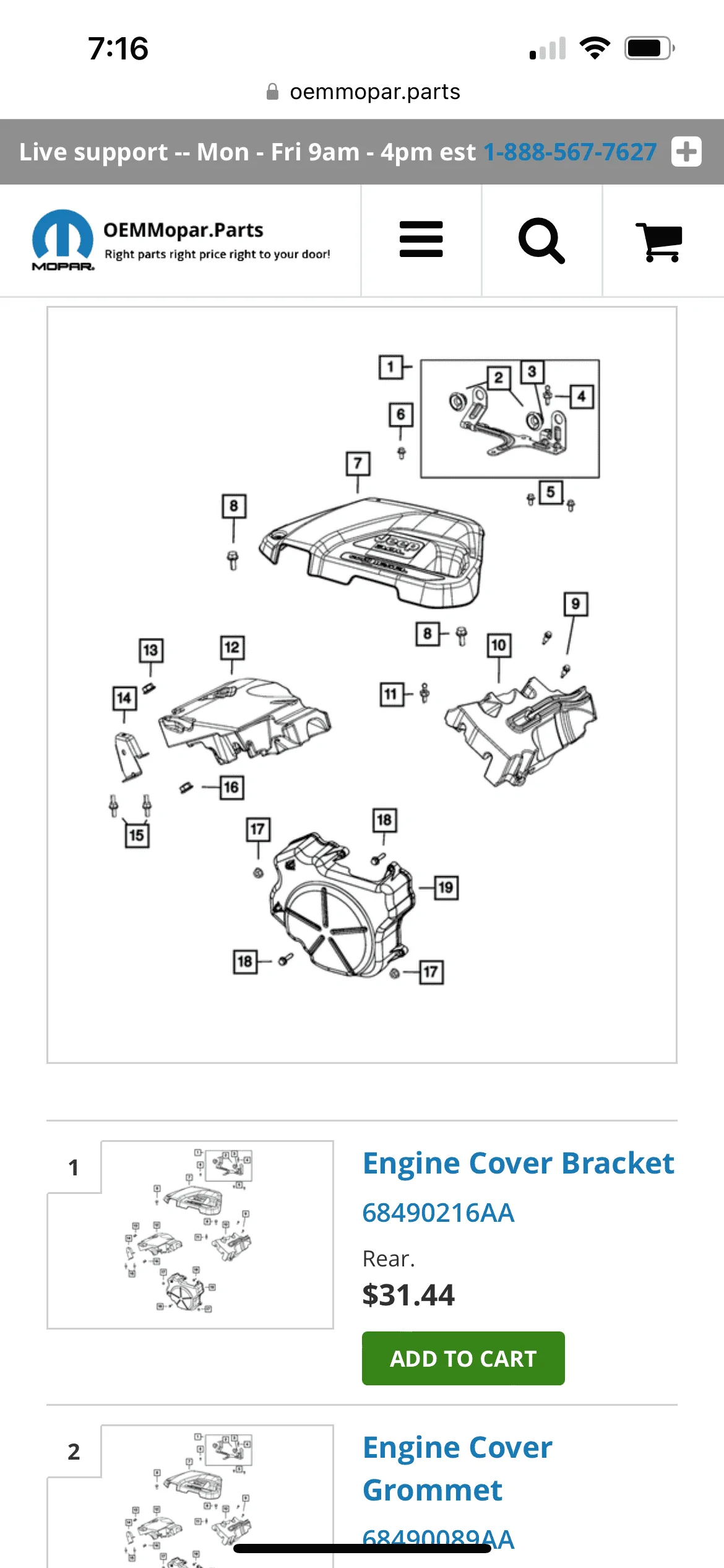

Remove these covers and install a hood vent. This will almost eliminate heat soak. Atleast in California I’m 100+ summer weather.
Jeep Gladiator Diesel cooling options and ideas 83CB255D-789F-4727-91BB-43B30EDC8178

Returning to this thread with a grill I came across. Looks like it might have better air flow..
HookeRoad Jeep JL Front Bumper for 2018-2023 Jeep Wrangler JL

Even if it did, I'd have a realllllly hard time doing that! :puke:
That's a nope....nope...and double nope. There is an angry grill and a ugly grill. This one is fugly.
