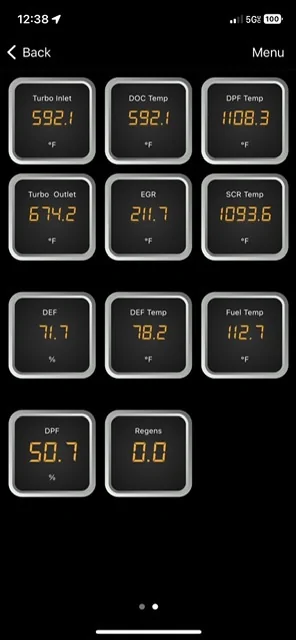

Air temps around 12-130 when oil temps are 250…. That’s not very high. I’ve seen up to 270 but in a cold ambient I can have 100 degree intake temps and oil will be 240+ when it’s 44 degrees outside.
air temps not doing it it’s the turbo heating the oil up.

Where are you taking the intake temps at? Before or after the turbo?

Both…. This was taken during a regen. Note the DPF and SCR temps.

I'm using a Banks iDash gauge. I have it set up for after the turbo inlet. Before and after the turbo exhaust.

Sorry this is monitoring IAT1 on the banks which should be AFTER the intercooler going into the intake manifold. I see as high as 170 on a 100 degree day. Even when it’s at 80-90 IAT on a mid 40s day I saw nearly 250 degree oil temps climbing priest grade toward Yosemite. I’ve done everything short of an external cooler. KN intake with an open filter hood vent removed all the seals and foam under hood and have AFE intercooler pipes. It all helps the engine shed temp once you stop or idle but hasn’t stopped the rampant heat soak.
