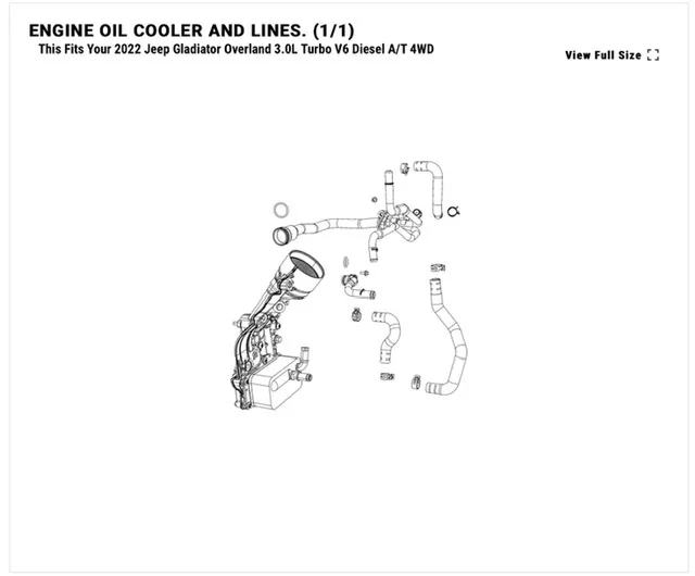

It does have an external cooler... It sometimes fails and you and end up with coolant in the oil system because of the failure.

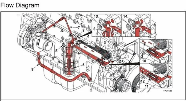

This may be called a cooler but it’s a heat exchanger at best. Running engine oil through a coolant water jacket is prone to fail over time with expansion and contraction. This cooler is buried and doesn’t receive much air flow with the engine cover in place.
Jeep Gladiator Diesel cooling options and ideas 12A54B89-1113-4716-A983-F9C49049E226
This is the flow diagram of the Cummins X15 engine oil cooler.
Jeep Gladiator Diesel cooling options and ideas 74D030A9-F927-4189-A08D-C097D5BB1B56
A proper cooler routes lines up front and on top in the air current and implements a proper air to water exchanger.
I've never worked on an ISX with an independent radiator for the oil cooler... And they're pretty well buried behind the alternator so not exactly in the path of air flow unless it's in a long nose KW.
The exchangers on our lil 3.0l are about proportionate to the 30 less quarts of oil it's cooling.
I agree though, the only improvement to be made over factory is an air exchanger with a thermostat. Problem being plumbing and space.
