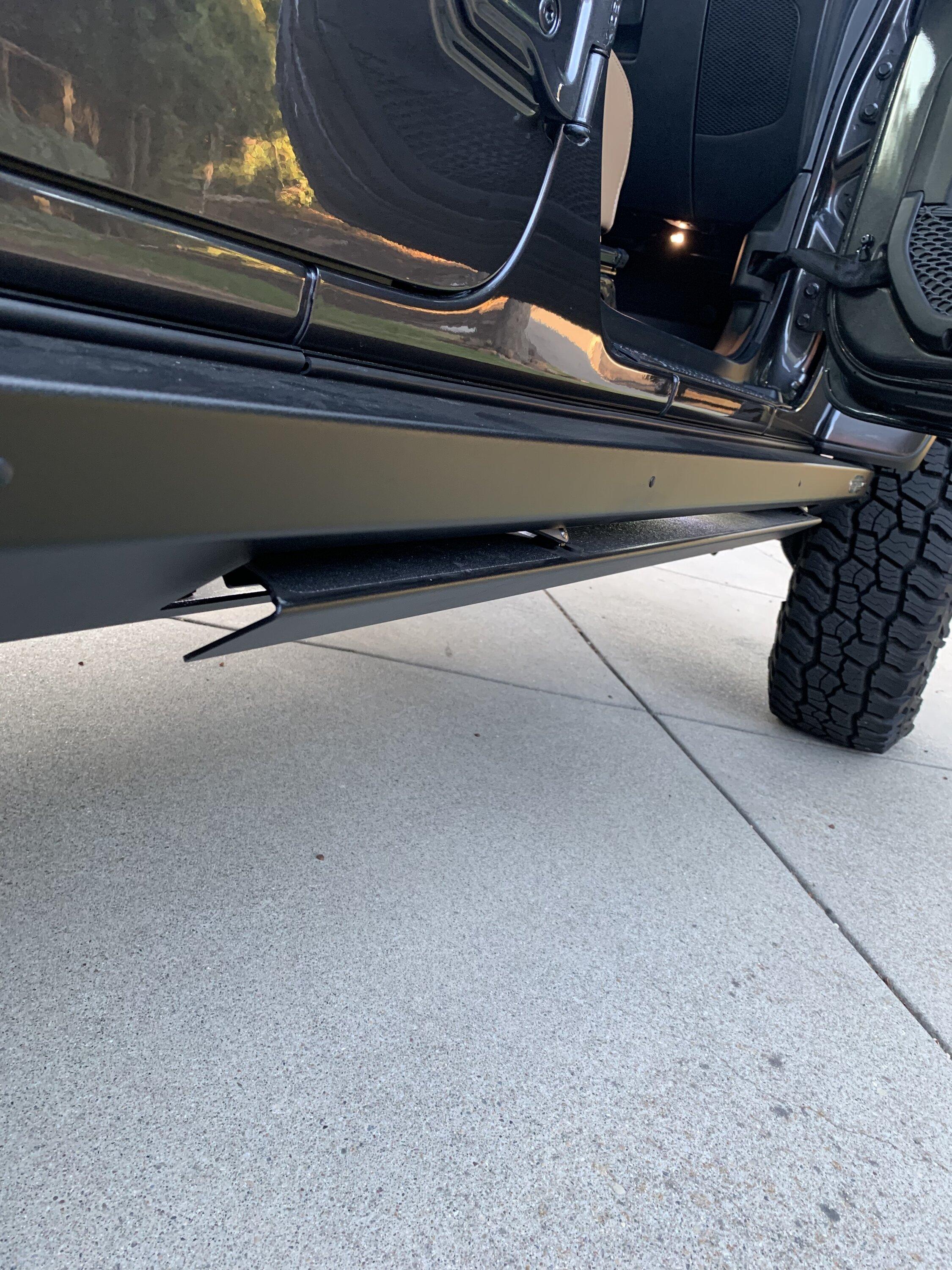

I had replaced the controller about 9 months ago and I started having the same issues again. It's always the left side. Not sure why. I called them and got a new controller again. Hoping this will be it for a while.

Reviving thread. My steps have been going up and down intermittently like they have a mind of their own. I would open drivers door, and I can hear the one on the passenger said move. Sometimes they go up and down, sometimes they don't. Now passenger side won't even move and driver side is stuck down.
I called RSE and they said it was probably the controller so I ordered a new one. Hoping that's all it is.
Figured out the steps, the wire that connects to the switch on dash had wiggled off.
