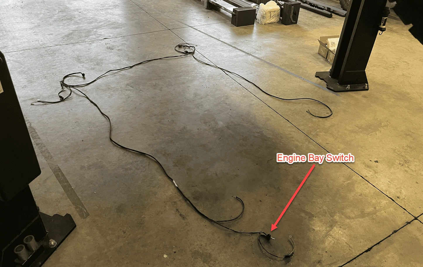

Does yours have the engine bay mounted kill switch in addition to the one in the cab? Mine have randomly cycled several times and I found the connections on the engine bay switch were bad; I could simply wiggle the switch in the little bracket RSE provided and the steps would cycle. Kind of a bummer because it's a completely waterproofed switch setup that looked like a nicely done piece...

The steps will cycle down/up when first powered up. Since this is happening as you describe it I would suspect a loose connection somewhere. Pull the fuse in the power harness and check the harness to step plugs at the rear of the step-slider. One/both may be loose causing an intermittent connection. When you re-install the fuse both steps should cycle down/up. DO pull the main power fuse - checking the connections with power will likely get you a mouthful of step. Good luck!
They no longer do the switch in the engine bay - it's "pull the fuse" now (saves 2 cents and some shipping weight)
