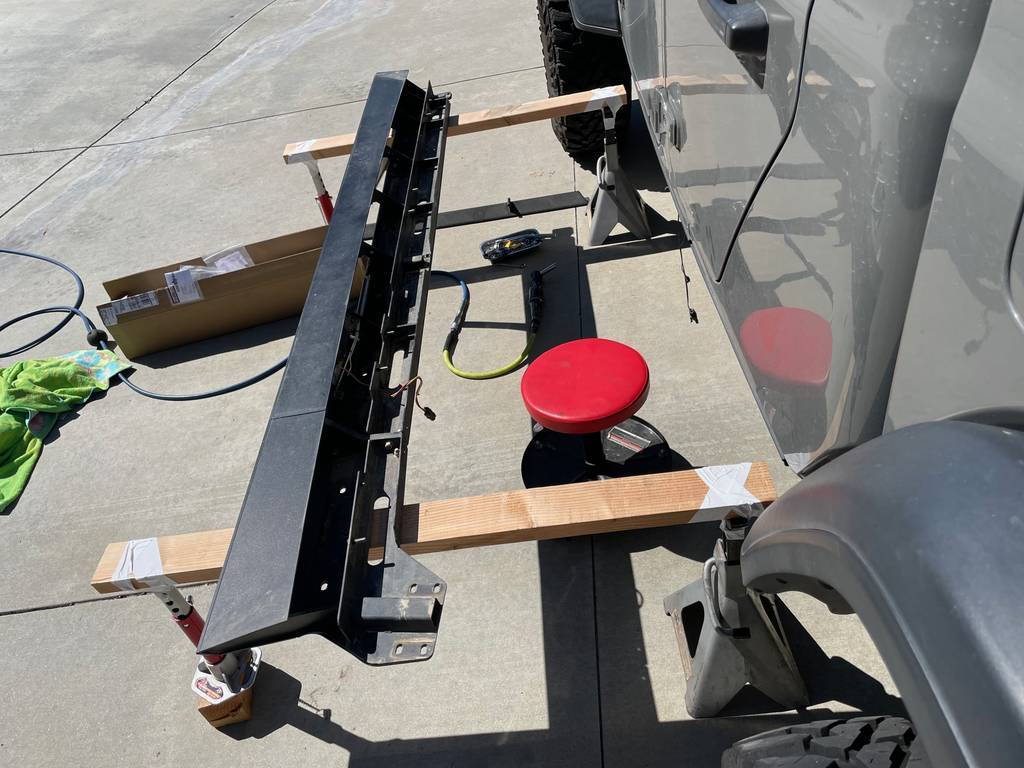

With the armor being so heavy, I just fabricate some scaffolding with floor jack stands, gorrilla tape and 2x4s. You can slide them off by yourself and work on them by yourself, test them with your electrical hookup close by, then, slide them back on by yourself.
Pretty much what I did with milk crates and wood blocks. Small jack stands work great and take up less room.

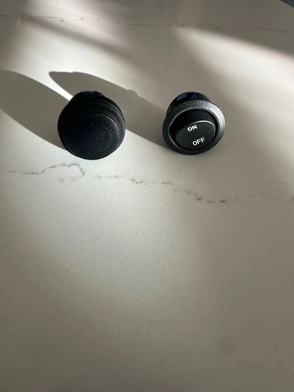

I want to add a data point to the discussion. My wife reported the passenger side RSE step did not extend on our 2021 Mojave (steps are about one year old). I tried the door a couple of times, pulled the RSE fuse in the engine compartment, and inspected all of the wiring for rodent damage or obvious wiring defects, and found none. I sent an email to RSE, Support responded within an hour and gave me the book directions, starting with "pull the fuse.., press the seat rail button". The seat rail button extended the step momentarily (about 3 seconds) and then the step would retract. When I explained what I had already done, and what I was seeing, RSE Support said it sounded like the door switch mounted to the seat rail was bad and they would send a new one.
I received the new switch within two days. My original switch was a simple push switch, no "off" or "on" indicated, and with two connections on the back. The replacement switch was a switch very similar to, or the same, as the RSE power switch under the dash, with "off" and "on" indicated. I thought they sent the wrong switch but I installed it anyway, and the system worked properly. When I sent another email to RSE, Support told me that this was the new replacement switch model. Photo has the original RSE switch on the left, RSE

replacement on the right.
As noted several times earlier in this thread, RSE's product support is fantastic!
Back in February/March 2023, the switch on the right is what both of my sets came with for the under dash switch - even though the docs still showed the older style dash switch.
(talking about the switch that mounts under the left side of the dash next to the OBD port - I don't have a "seat rail"??? switch, no doors off kit, etc. I don't even know what a seat rail switch is LOL)
