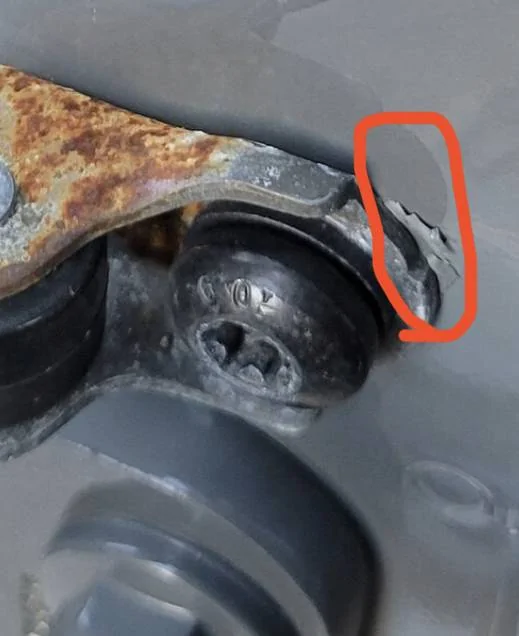

If you zoom in real close it also looks like your paint is cracked and flaking off. This will be a much bigger issue if the body under the pint is starting to rust.
I would be elevating this and include pictures. Thts going to need bodyshop work and repainting IMO

jeep is gonna blame this on the customer over tightening the bolt, and claim he did it after removing the doors.

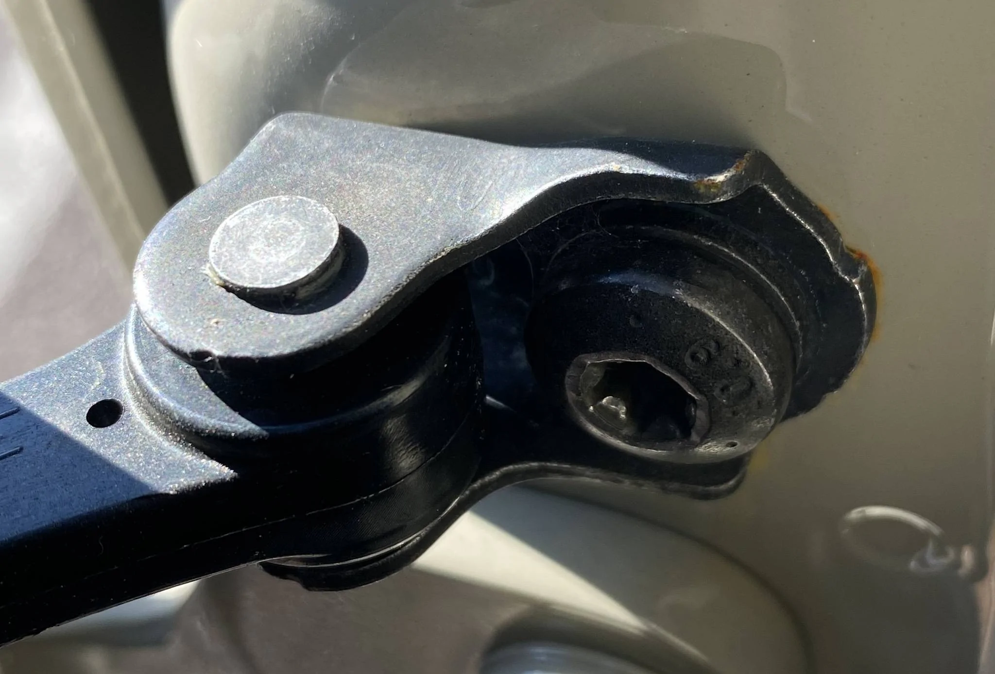

This is the door check on the 2022 JTU I picked up in early December. Looks like it's already starting to develop some rust. Pulling these off and giving them a clean and the rattle can treatment will be spring project to put on my list.

The finish on that bracket sucks, too. Look how thin that is.
If I catch mine looking like that, the bracket will come off, it will be prepped and plated in black zinc, and a plastic insulator put between the bracket and body.
(either that or I'll powder coat them in satin black or flat black)

Doors off or on should not matter. You get crud in those areas from winter slop and splashing and such. I have to wash the door edges and door jambs every time I clean the truck. Stuff ends up in there. Heck, 40 years ago parts between the door and body were finished better than these. They are STILL outdoor parts exposed to soap and water when washing.

They need a better method for disconnecting that that doesn't involve a bolt. Maybe a pin in the arm (but then if you let it go back into the door - oops)
I would hope that thing doesn't scuff that easily. They just don't have a good finish on those at all.
