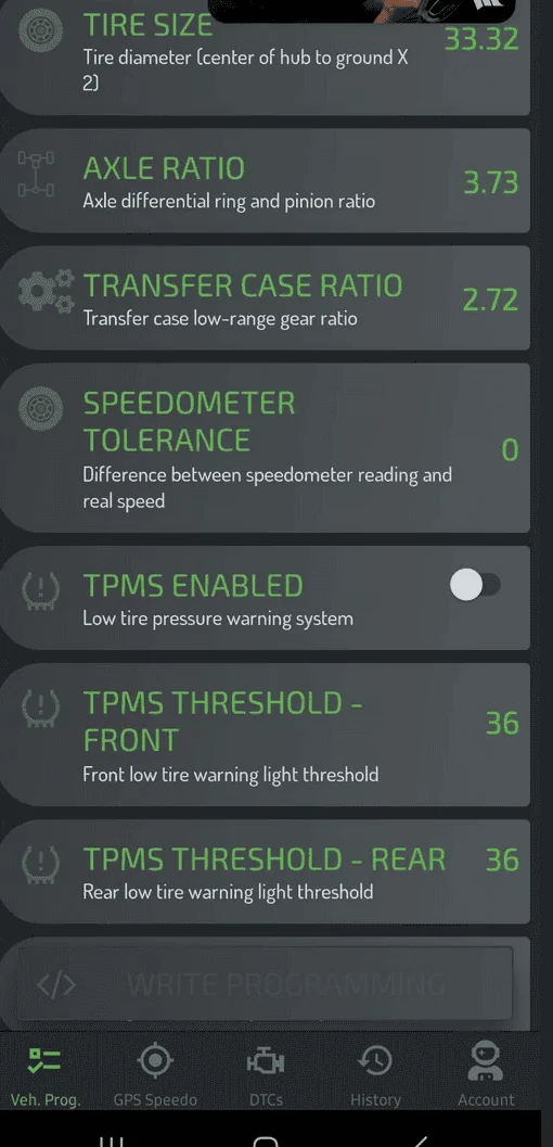

So posting a update on this, Since i said i would do a follow up !
* The previous owner did indeed toggle the TPMS settings off along with various other things*
I also did re-calibrate my tire size as well. It seems they had much larger tires on then what i had on as stock.
I do have one question though.... TPMS Threshhold should be at 25% of what my max fill is so it would be around 29? or I could just leave it at 36 ? Id think dropping it down within legal range of 25% of max fill would trigger it right ?
Also with that being said thank you everyone for your input and help on this topic ! Have a great new years !
