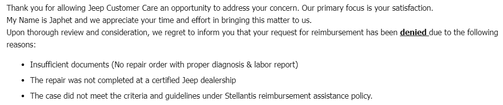

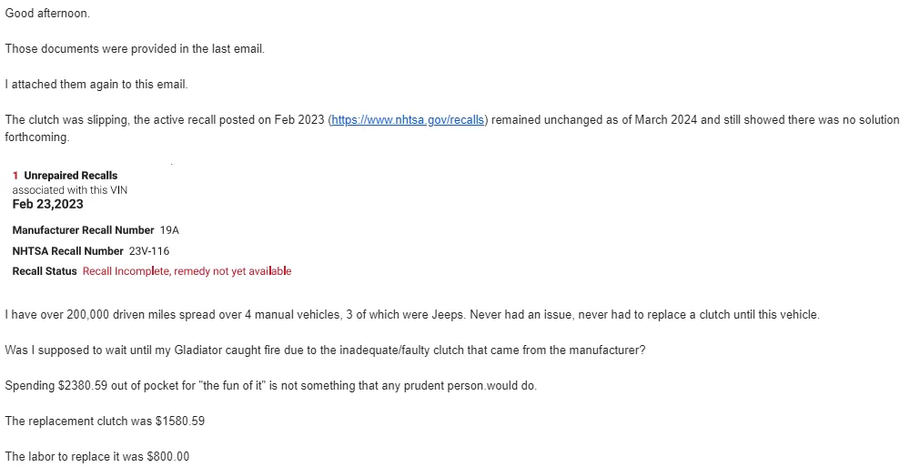

Good luck with yours. Here's the relevant emails from my exchange when I got my notice.
Jeep Gladiator Jeep going in monday for Recall 19A clutch replacement Screenshot 2024-06-10 130456
Jeep Gladiator Jeep going in monday for Recall 19A clutch replacement Screenshot 2024-06-10 130209
