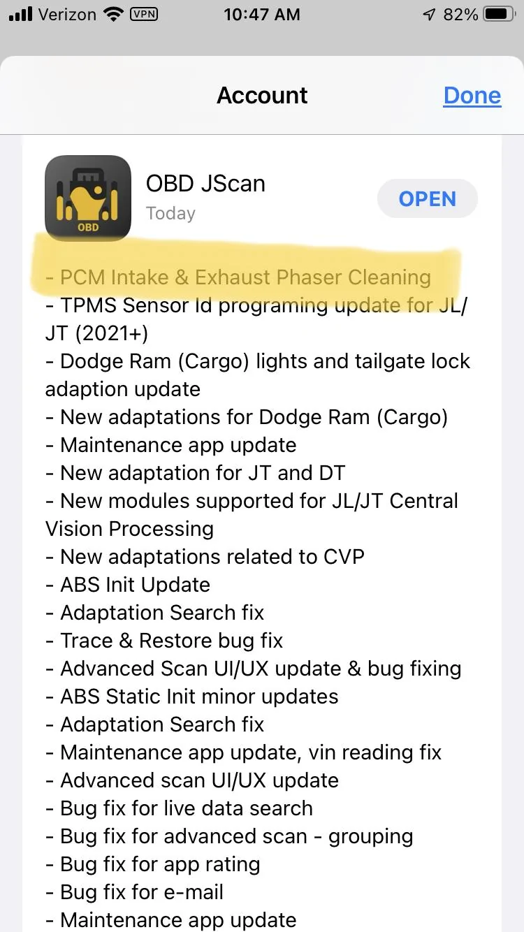

Can anyone explain the highlighted part to me?
maybe its the fact that I haven’t slept in 24+ hrs but my googlefu is weak today and im not finding details.

I did this function on my 2020 Gladiator with a Thinktool Pros scan tool. Not something I would recommend doing unless you suspect an actual problem with the VVT system. It is two tests, one for intake and the other for the exhaust phasers. Both test will make it sound like your top end is coming apart before it comes out of a completed test.

DAVECS1 has explained it somewhere.
It thrashes (note the h in that word LOL) the phasers back and forth hard to clean them, takes them from extreme to extreme, an exercise.
I also wouldn't do it without cause.
Ty
yea, I don’t intend to. I just need to keep reading to understand why someone would do it. The link @Gvsukids provided had a lot of good info in it. Just a heavy read for my tired fried brain.
