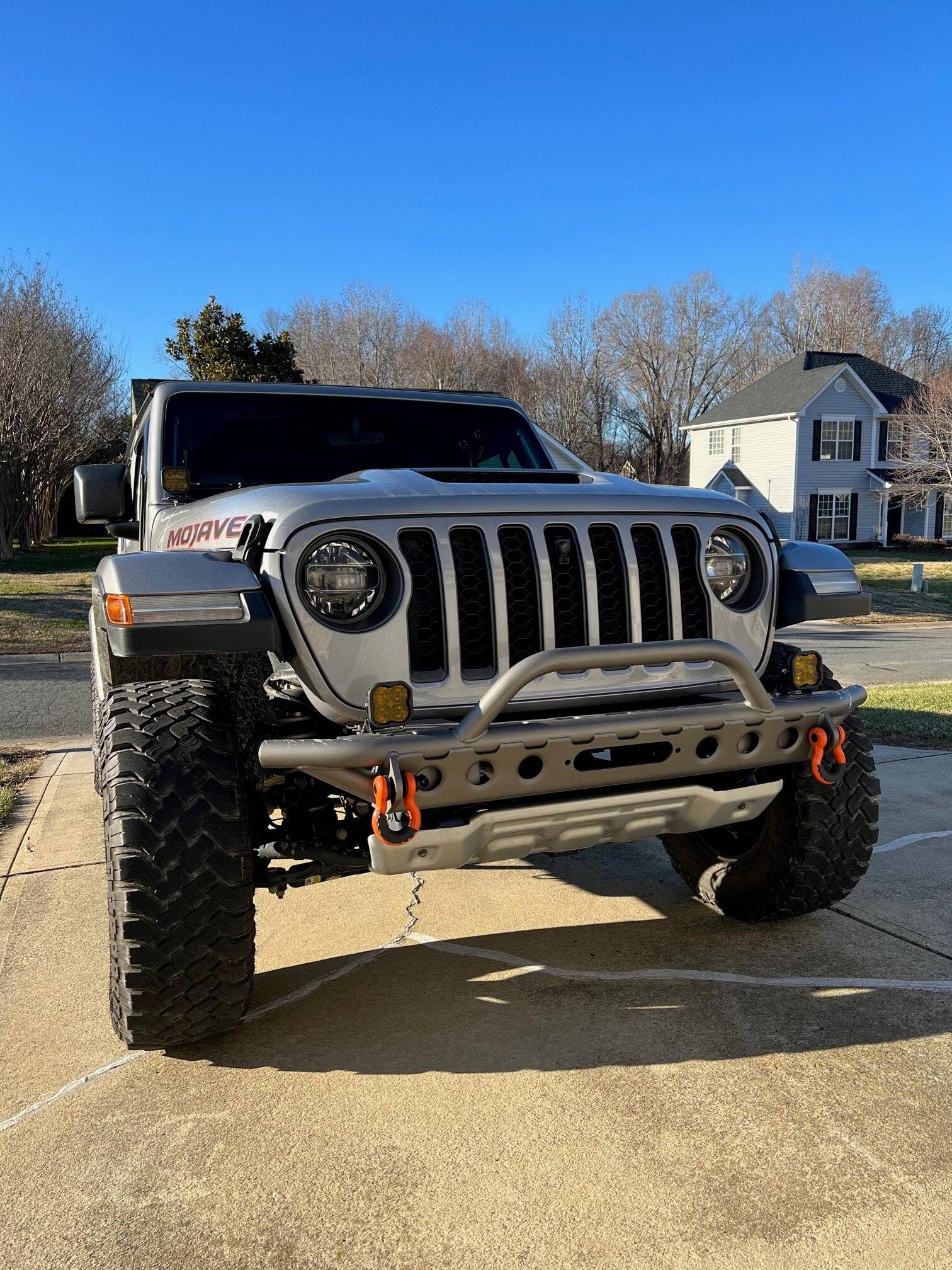

Did Barnes ever mention a rear bumper for the JT?

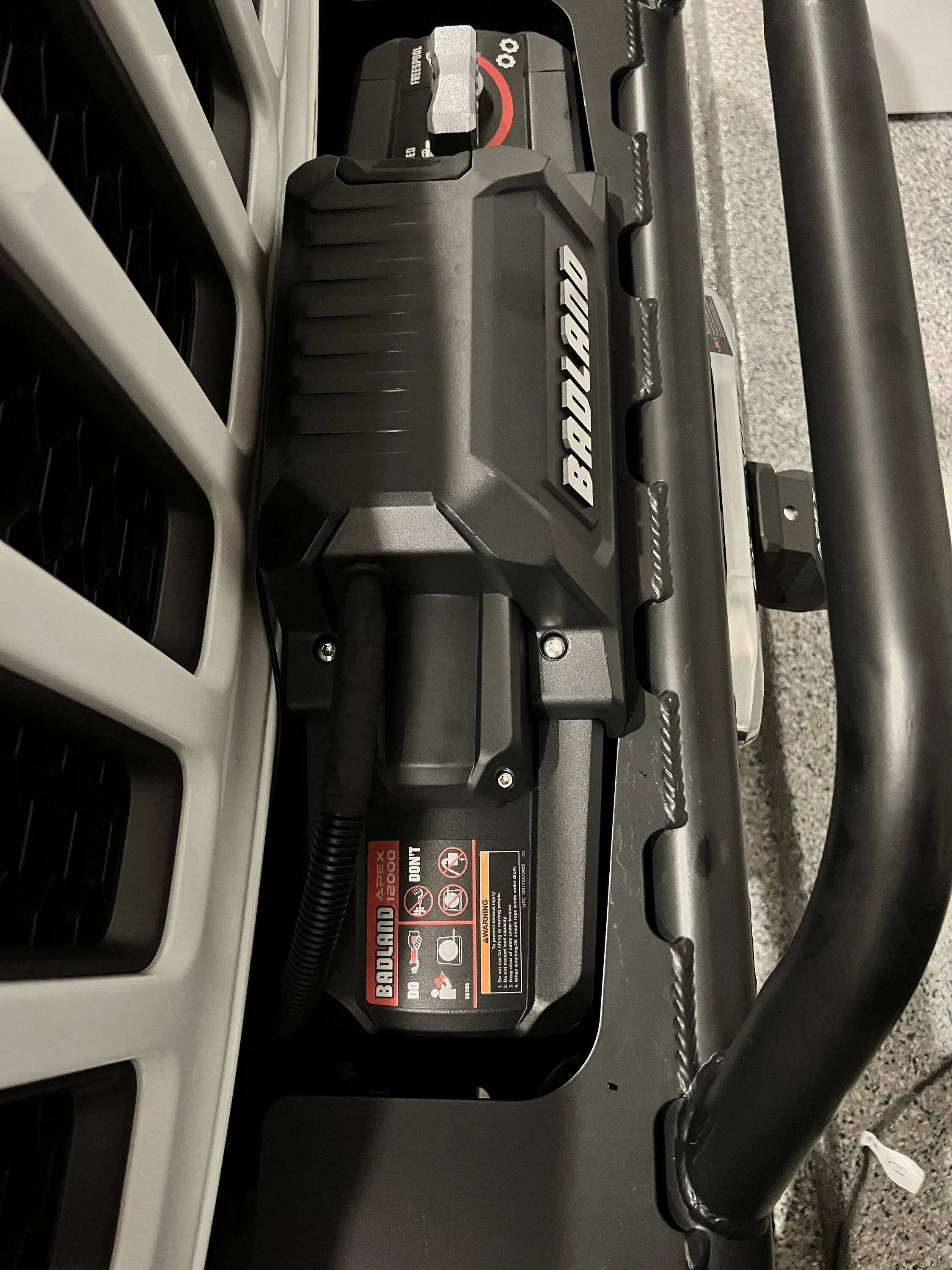

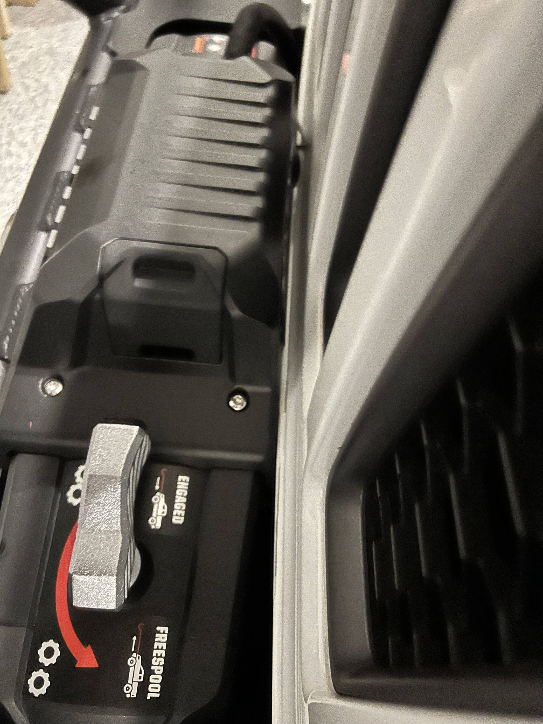

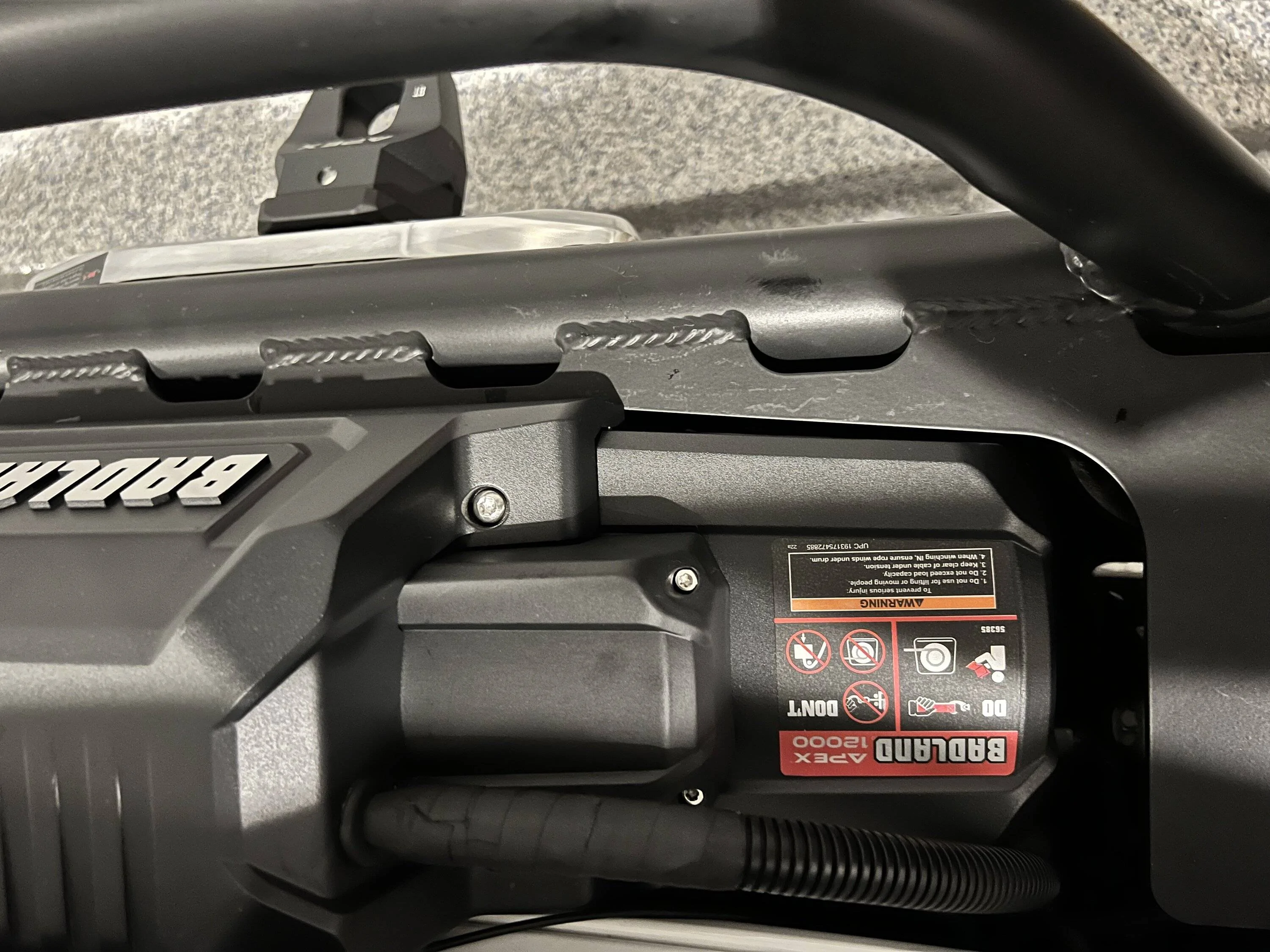

I finally finished the install of the Badland Apex 12000 winch (with synthetic line), scv707’s 1/4” plates. Long story short - it’s a real tight fit. The winch barely fits with minimal clearance. If you install the control box on top it will rub against the bottom of the front grill and you’ll need to reroute the power cable to the side of the box.
If anyone would like to see pics let me know.

I’d like to see it. Same winch I have, considering this bumper

I ended up pulling the bumper and adding 2 extra washers on each interior mounting bolt as additional spacers between the plate and the frame. This allowed the winch to get enough clearance between the grill and the winch control box. You can mount the control box elsewhere if desired. For extra protection on the bottom of grill I added some heavy duty clear 3M paint protection film. Be aware that the ground wires are a bear to install. The space is tight and if you drop the washer and nut there is a good chance it’ll fall into the wench enclosure. Overall I’m satisfied with the results after the reinstall.

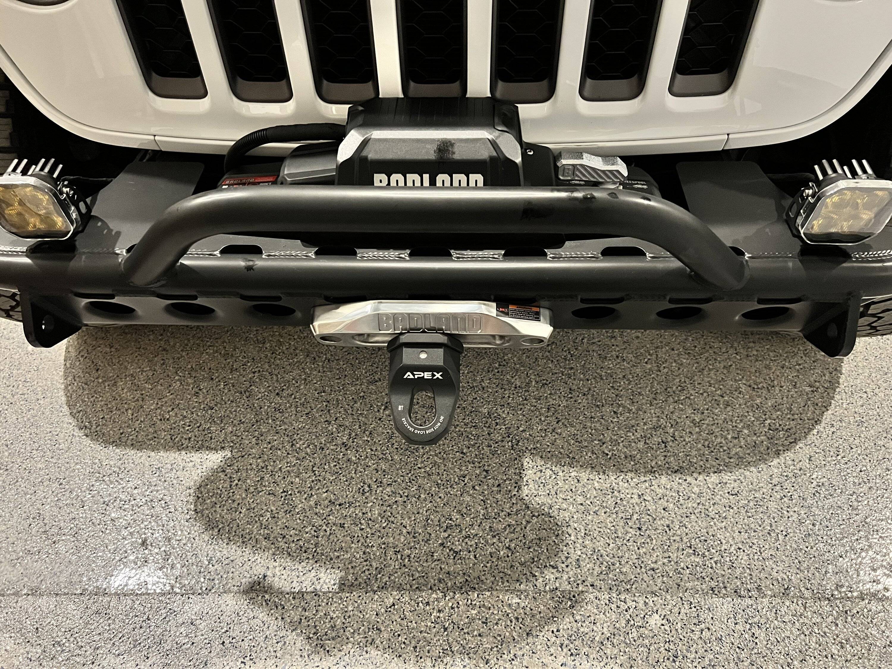

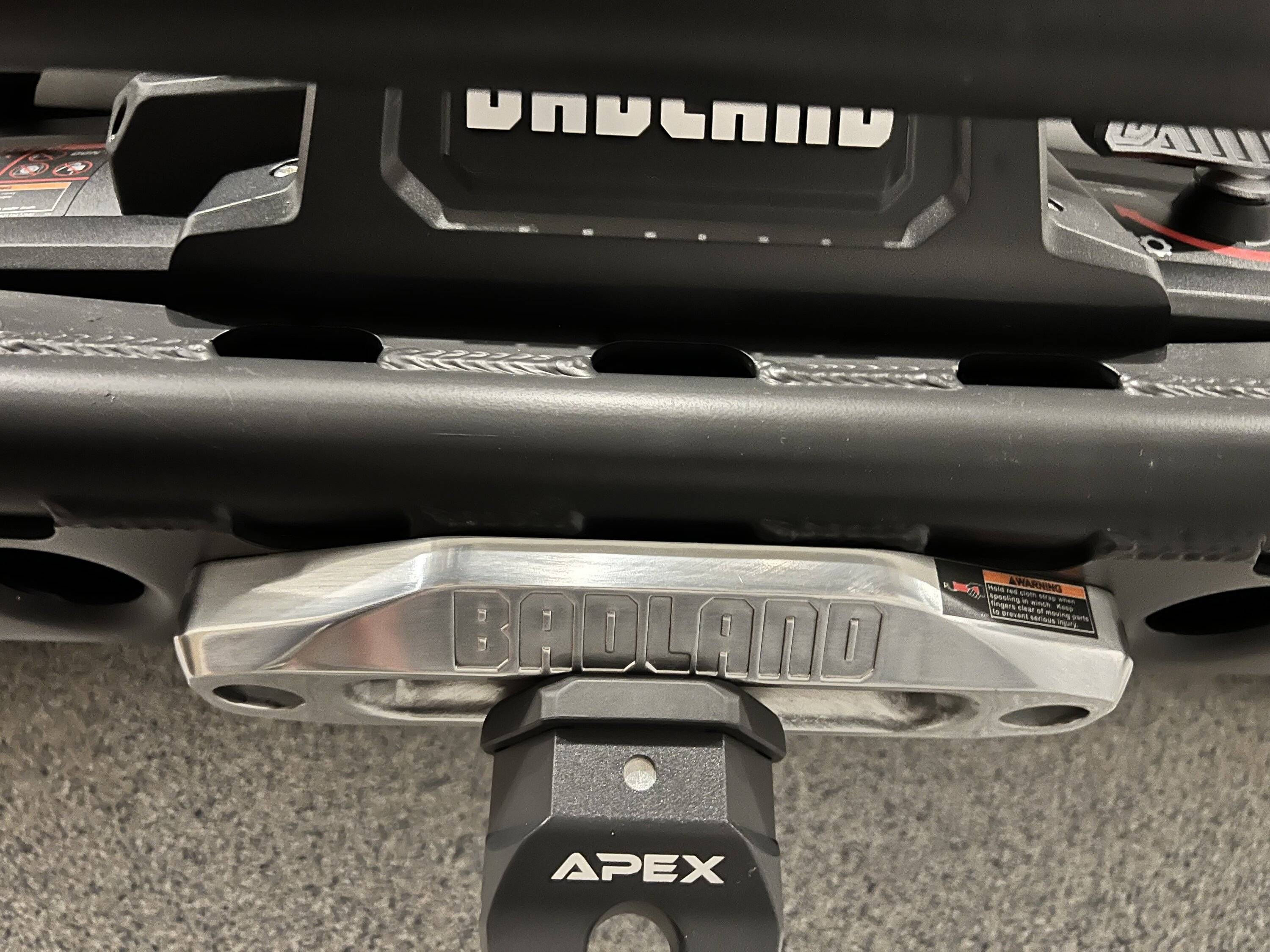

I know some hate reviving an old thread… but…
was wondering if anyone knew if a badlands 12000 will fit on this bumper. I see one badlands in the pics but can’t tell the size.

The pictures I posted are of the Badlands Apex 12000 w/ synthetic rope.
