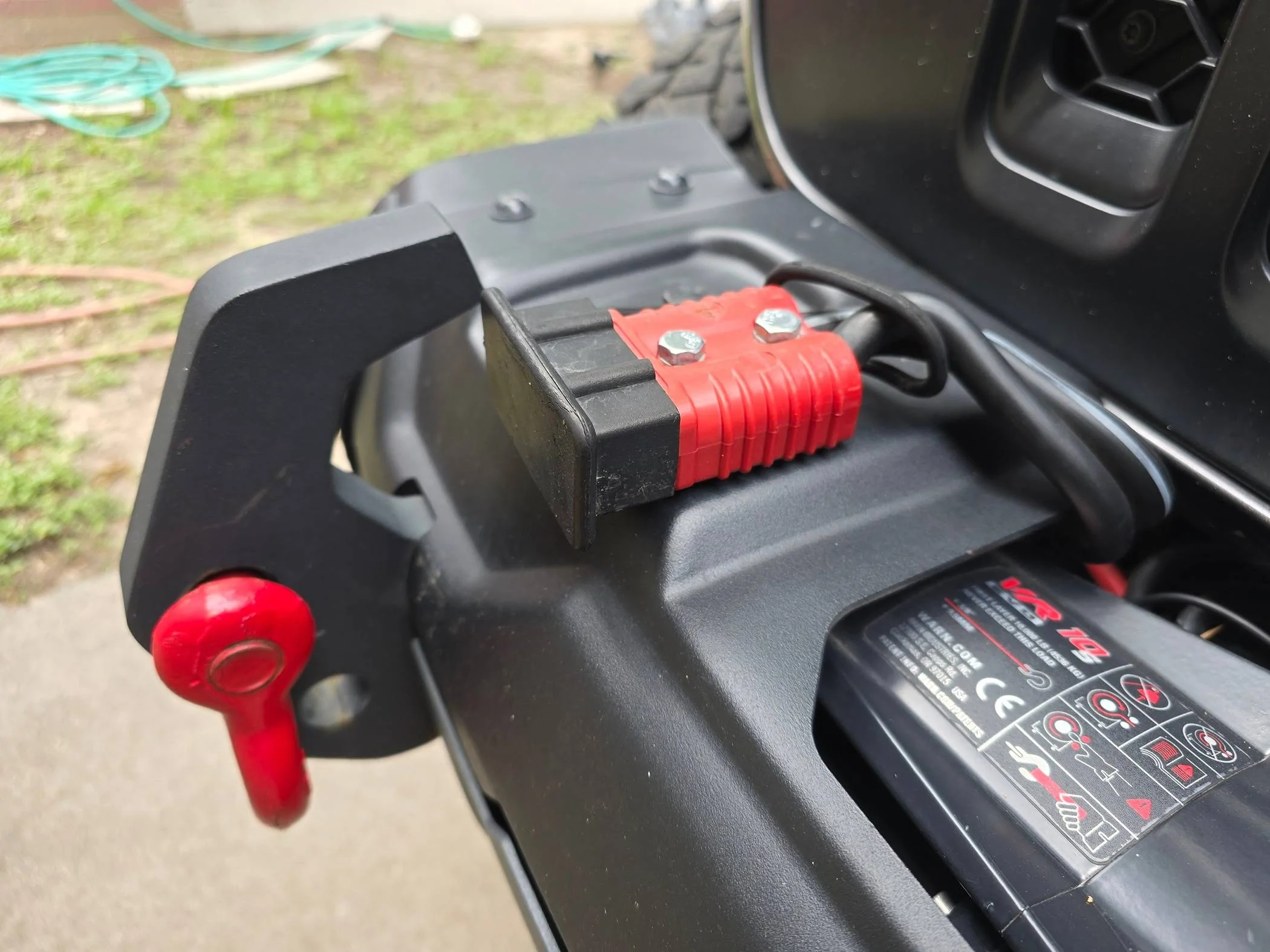

I installed a terminal that my cables plug into. I don't have to pop my hood. makes things pretty simple and quick.
Jeep Gladiator Jump starting Civics leads to depression 20240508_122825
