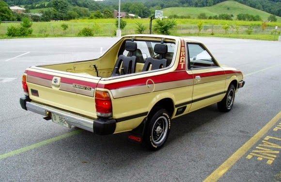

Hey! Does anyone have or plan on putting in jump seats in their Gladiator like there was in the old Subaru Brats? Any links to a set or tips on installation would be appreciated. Thanks!

How much do you hate your riders? it's not hard or complicated and could be accommodated easily with the bracket kit that teraflex sells. I did it to my JKU for the dogs. The boys fit but only for so much longer. Humans can perch but a long ride and I'd be asked to put my teeth on the curb. The BRAT seats were to get around taxes, no one including Subaru ever actually thought you'd put real live humans back there.

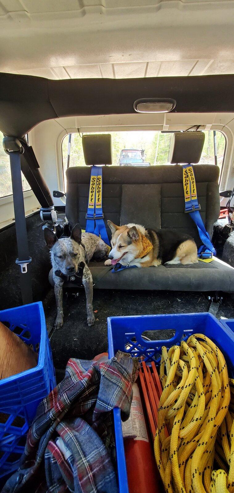

The kit is two brackets for a jku to fit a jk back seat. You drill some holes, install some rivnuts and mount you seat. Depending on how you orient the pins it can face forwards or backwards and will still fold and tumble.
https://www.google.com/url?sa=t&sou...FjAEegQIGRAC&usg=AOvVaw01K3p7iWDqaPcE1y4y8_J9
I got my harnesses from www.rallylights.com Will knew exactly what I needed when I said I want to use the factory latch points, these clip on the seat just like a car seat in the front and then have a seatbelt type latch on the back that also clips to the latch point. The girls have leash clips for the seatbelt latch and now everyone can ride "safe".
For short hops its okay but for longer hauls you have no leg room, its strictly dogs kids and groceries. I tried fitting as a joke and the joke was on me. I could make it work backwards but had to pull the tail gate, less than ideal for most situations. Were I running a technical in a boarder brush war sure... but not suburban long island.
