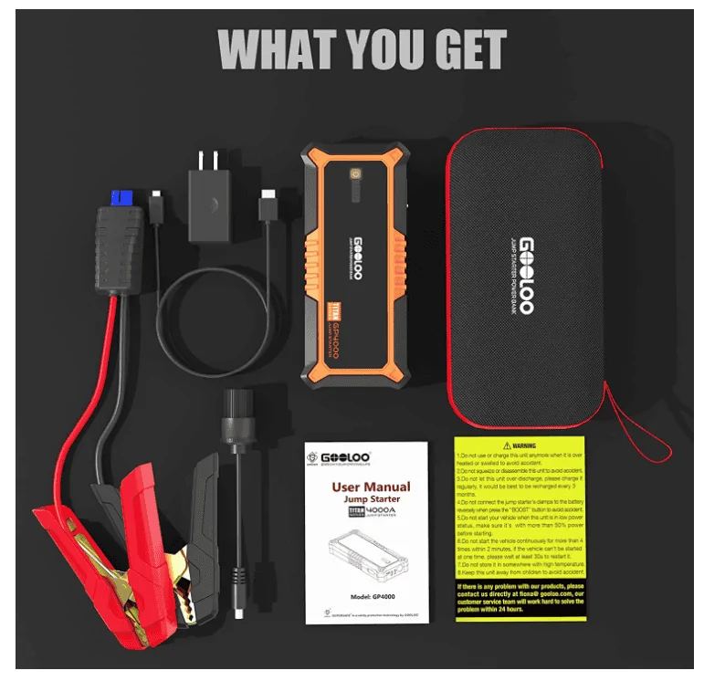

I have one of these in the "go to" box in my truck....better safe than sorry
https://www.amazon.com/GOOLOO-Super...d_rd_i=B084YQSVZ6&psc=1&ref_=pd_bap_d_rp_13_t
Only USB charging? No wall outlet charging, no 12v charging?
Seems charging a 12volt device via a 5 volt tiny USB cord through an adapter would take forever.

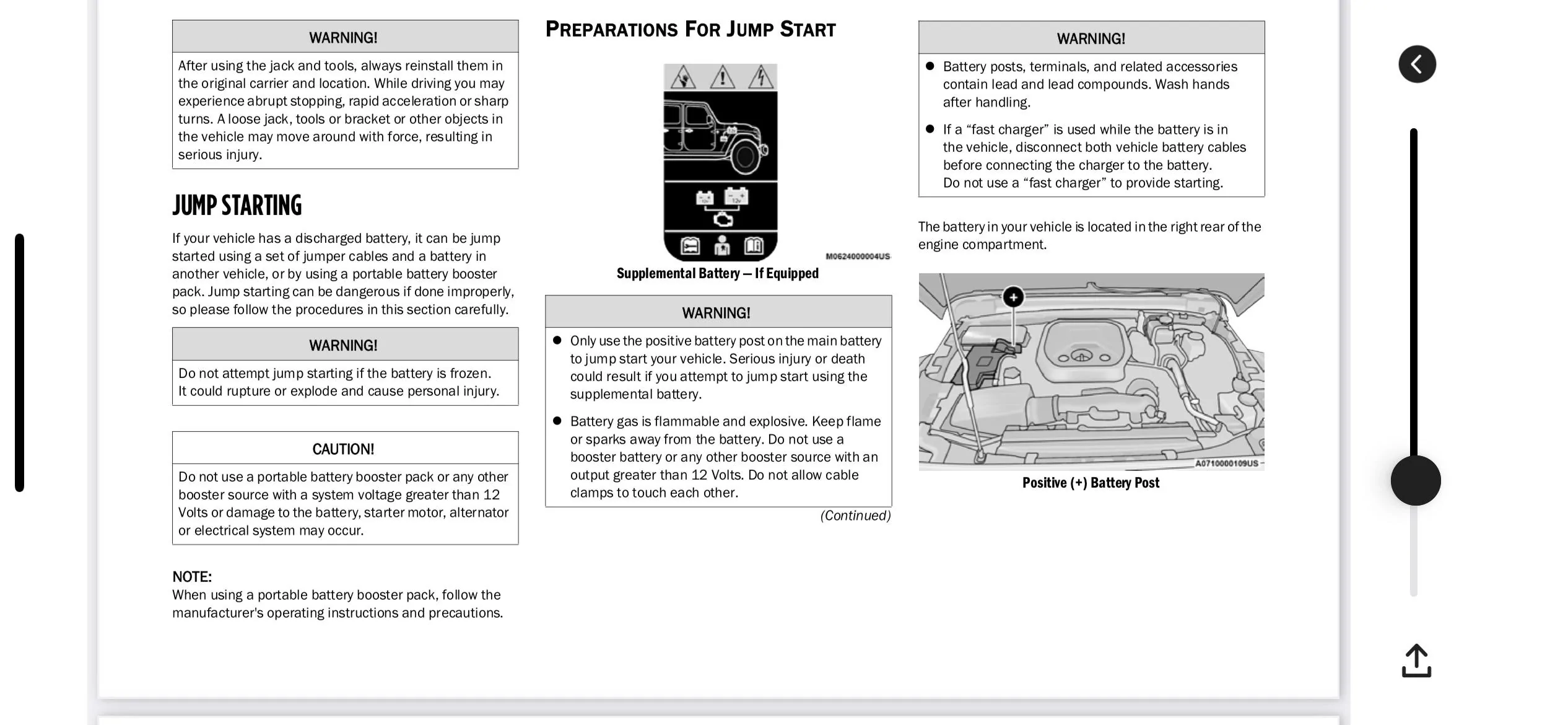

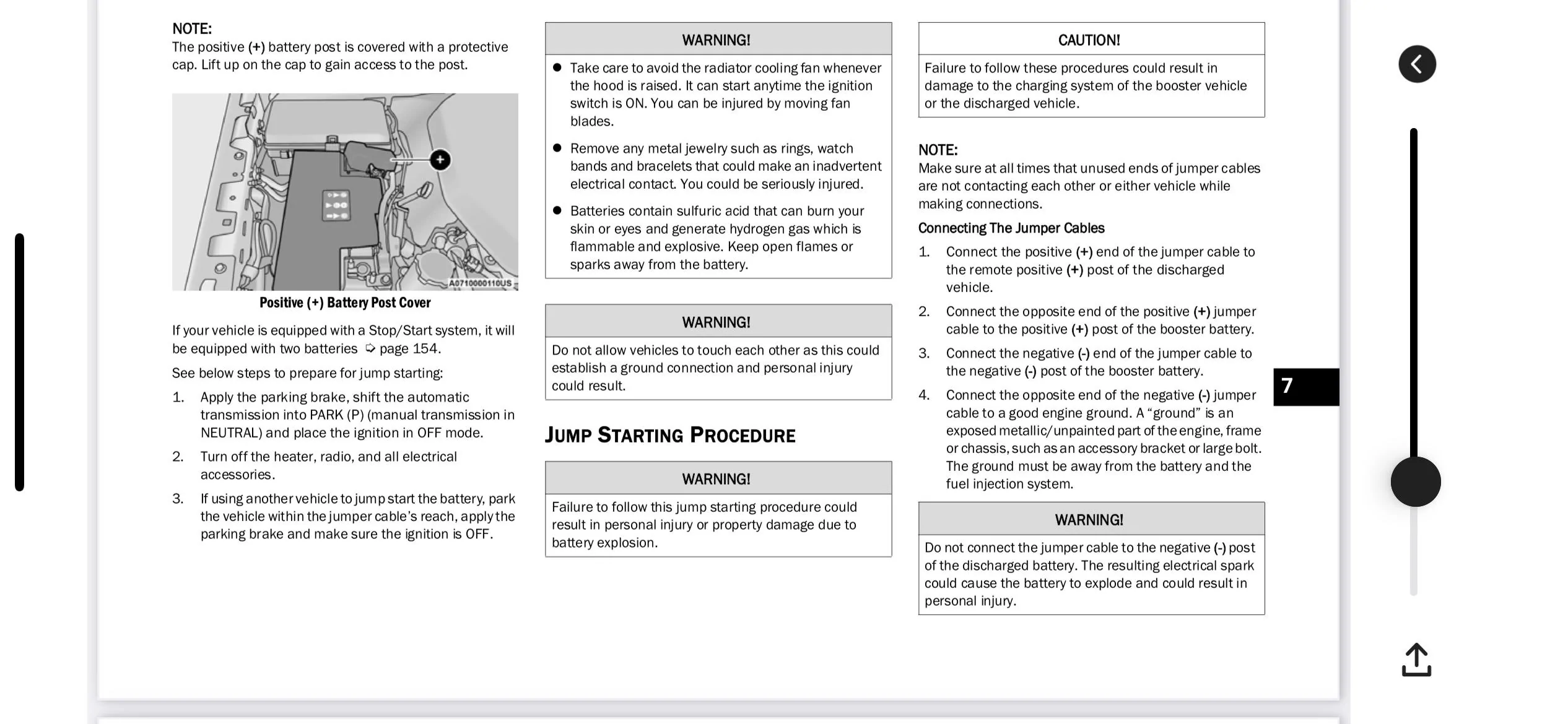

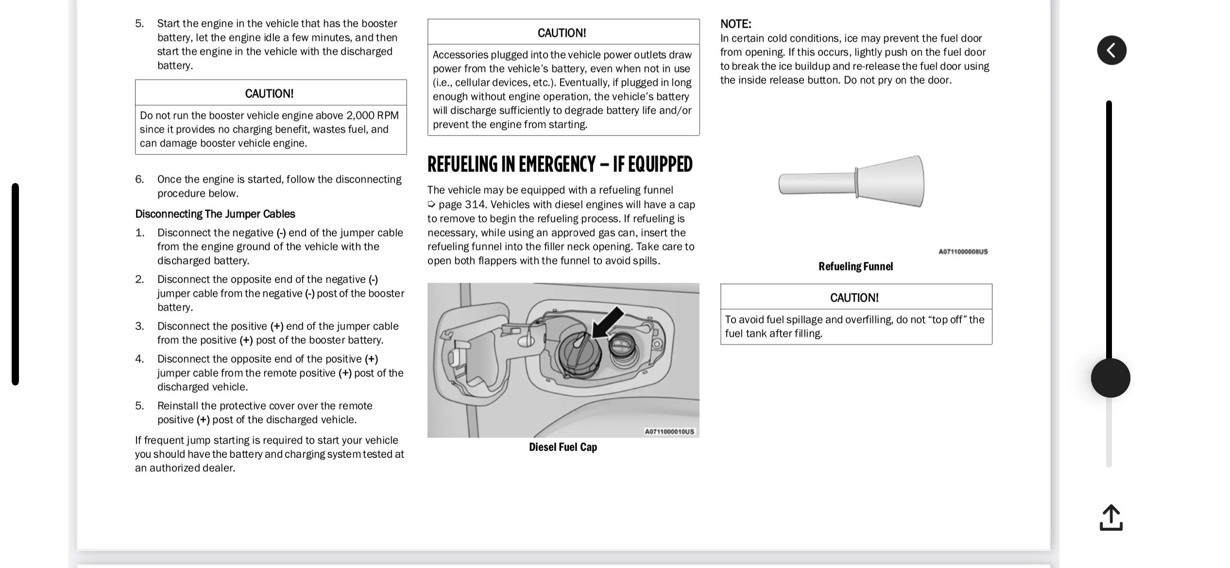

Back on the original topic, after this turned into "the best portable charge pack, my choice is obviously the best" instead of "can I jump start other vehicles with my truck"
The bottom line is you can jump start any Jeep from another vehicle, and you can jump start any other vehicle from your Jeep.
(Well, you won't be jump starting that big Peterbilt diesel tractor or your local farmers JD combine from your Jeep, but that's getting silly, now)

The description says USB C for fast charging. It's like the one on my noco gbx 155. Very fast compared to the old USB micro. Don't even need the fast charge adapter anymore.
