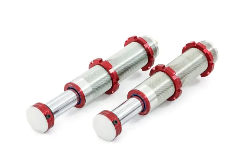

Which hydraulic bump stop do you use in the front and did it take a long time to set it properly.

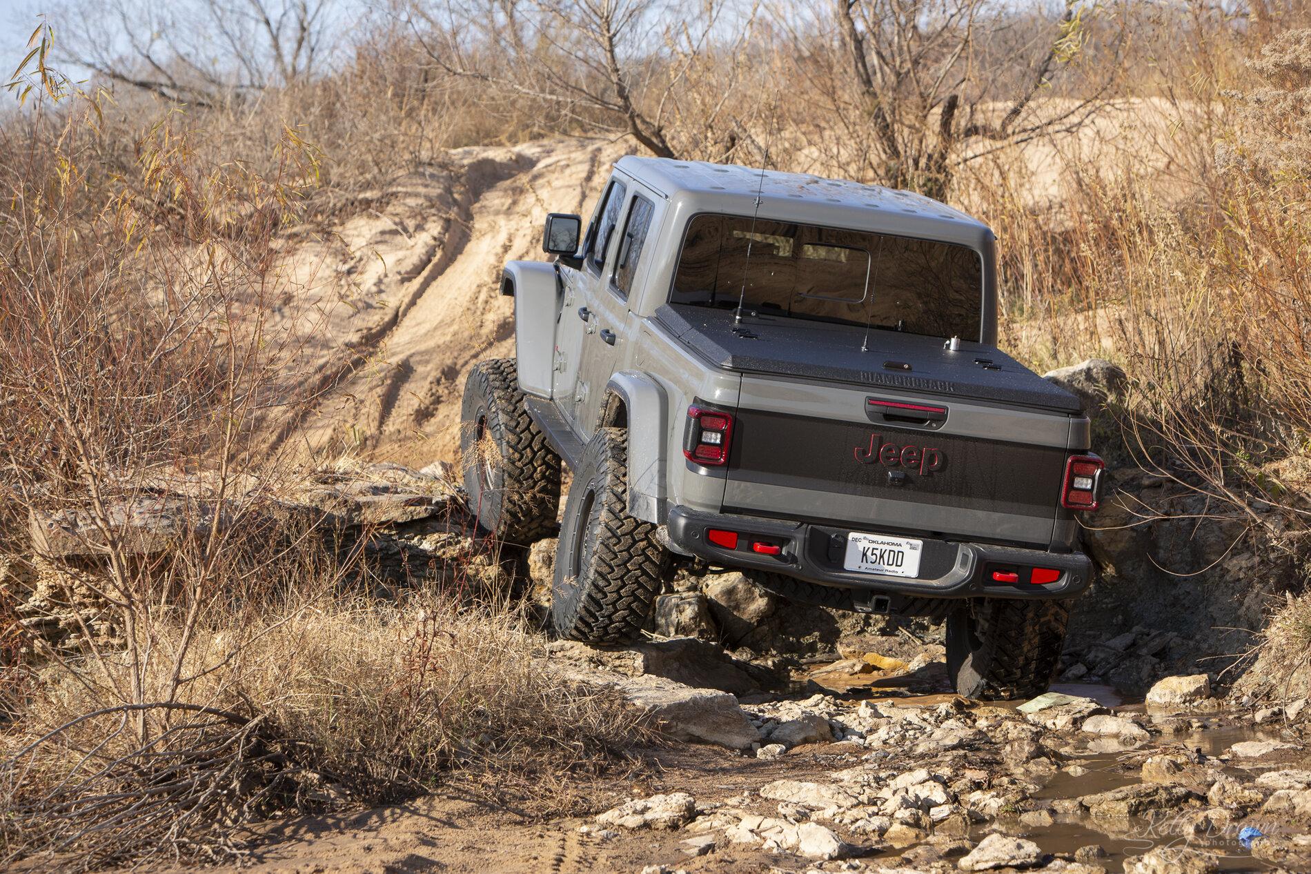

Only issue I have with the suspension so far is if some dirt gets in the rear spring seat it gets squeaky. Have to jack it up and pressure wash it out. Also it flexes so much I can easily rub my stubby front bumper, it is an impressive amount of flex from this system.

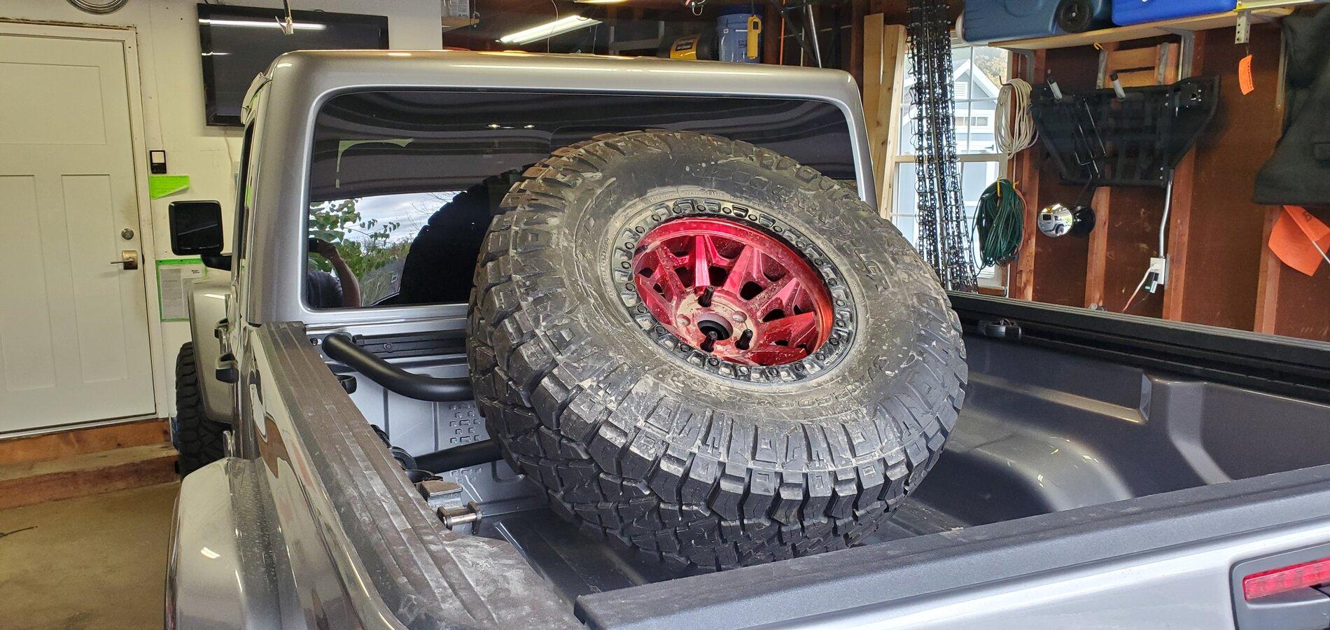

Do you have a pick with the 37 in the spare well minus the track bar? If you ditched the trackbar, and got an aftermarket bumper that ditches the hitch assembly but doesn't tuck too much inboard I almost wonder if a 40 would sneak in under there.
I fit my 37 in the tire well. Helps that the track bar is gone. I have to really push it in there. I have Nitto Ridge Grapplers that run a little small. Some others can't fit a 37" spare.
I did get a bed mount for my spare when I go wheeling. Don't want to tear it up underneath.
I went with the Rough Country hydraulic bump stops. I haven't had a chance to tune on them at all so they're just a tad bit harder than I would like. I need to soften them up just a bit but I need to get the Nitrogen recharge kit with gauges to do that. I'll use the same kit with the shocks so not a big deal.
Jeep Gladiator Just Finished Rock Krawler Pro-X lift and new wheels and tires- Added offroad videos RoughCountryBumpSto
When you're working over big bumps they're very very nice and work amazing well. On the street they do what they're supposed to but the initial contact where the axle plate connects with the bump stop (about 3 inches of travel) you get a bit of a clunk. I didn't expect that but it makes sense. I just wish instead of a hard nylon end cap you see in the picture it had a softer more transitional contact point, it would eliminate that clunk on initial contact. Outside of that they work very well.
I'm not experiencing any squeaks or rubbing yet. We'll see as time goes on.
For me my Nitto Trail Grappler 37's were about 1/4 inch or so from the trackbar. It was a VERY tight fit as those run pretty true to size. Obviously without the trackbar there's a lot more room in that direction but the tire still has to kind of fit between the frame. I don't think a 40 would fit under there under any circumstance very well and you'd be dragging it on everything as they're usually wider than 12.50. I don't mind dragging my 37 spare across stuff. Doesn't seem to hurt it at all.

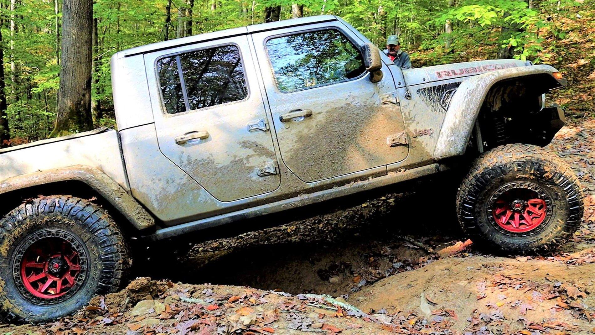

I had it pretty flexed when it was rubbing the bumper. The stubby bumper hangs just a bit out from the grill. Lugs of the tire catches it at pretty good compression/flex on other side.
I don't want to drag the spare, could ruin it and I bought 5 wheels so I do 5 wheel rotations to get more life out of the tires.
Nice. That looks really sloppy and messy lol. Sadly, nobody is taking pictures when I'm out doing things. I'm usually the one that's taking the pictures. I literally have one lousy picture of me doing anything in mine and it was something fairly lame. lol

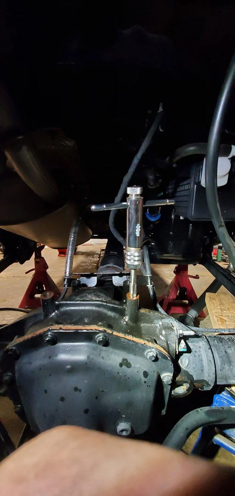

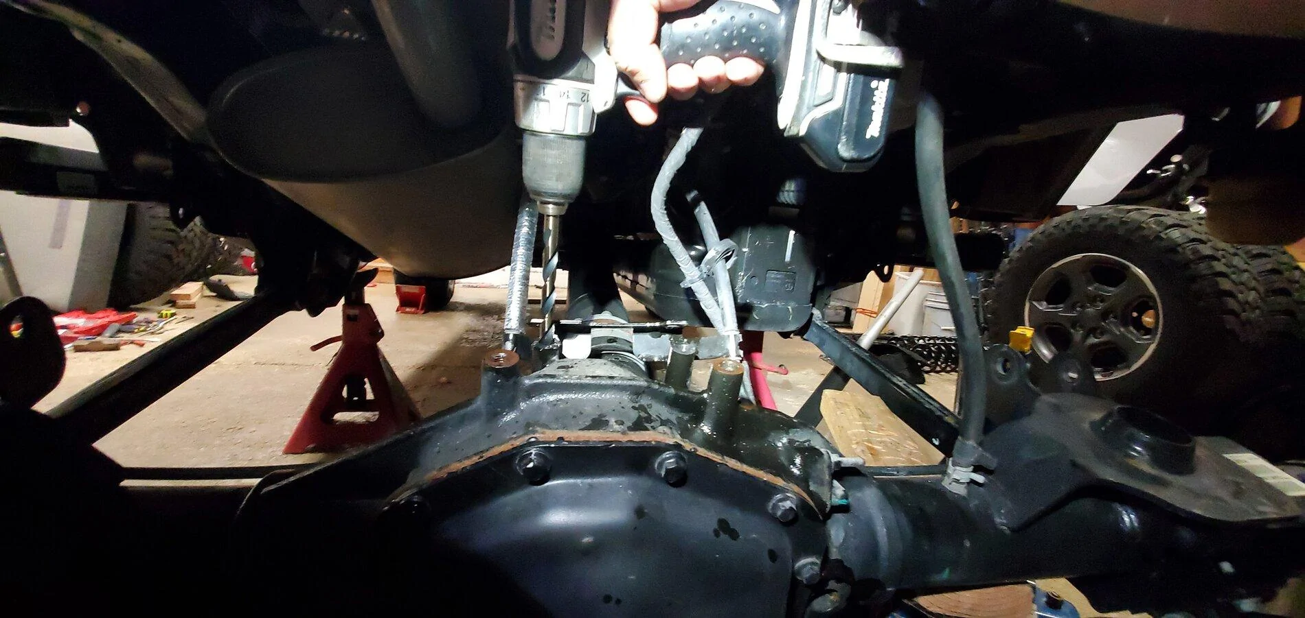

Nice thread you have here @fosgate your rig is looking sweet. I just ordered the Pro-X stage 1 yesterday. I am very excited. Did you have to remove the rear axel in order to drill and tap the holes?
fosgate
fosgate
Sep 1, 2020
76
144
Illinois
Nice thread you have here @fosgate your rig is looking sweet. I just ordered the Pro-X stage 1 yesterday. i am very excited. Did you have to remove the rear axel in order to drill and tap the holes?
No. I I just removed the spare, droop the read down to the ground and crawl under. Lots of room. Quick tip, leave the spare tire holder loose and place to the side or you will keep hitting it with your head.
If you droop the axle enough it is pretty spacious. The front two you have to work over the diff but it wasn't bad. Just have someone to pass you tools because once you are in there it is a pain to come back and forth. They provide the correct drill bit and tap. You need drill/tap lubricant, tap T handle and an air line to blow the shavings out.
Probably the task I was most worried about doing and it was actually pretty easy.
Photos of me working on it from the spare tire well.
Yah thats the part I am most worried about also. Glad to hear that it was not to difficult and went well for you. thanks for the tip :like:
