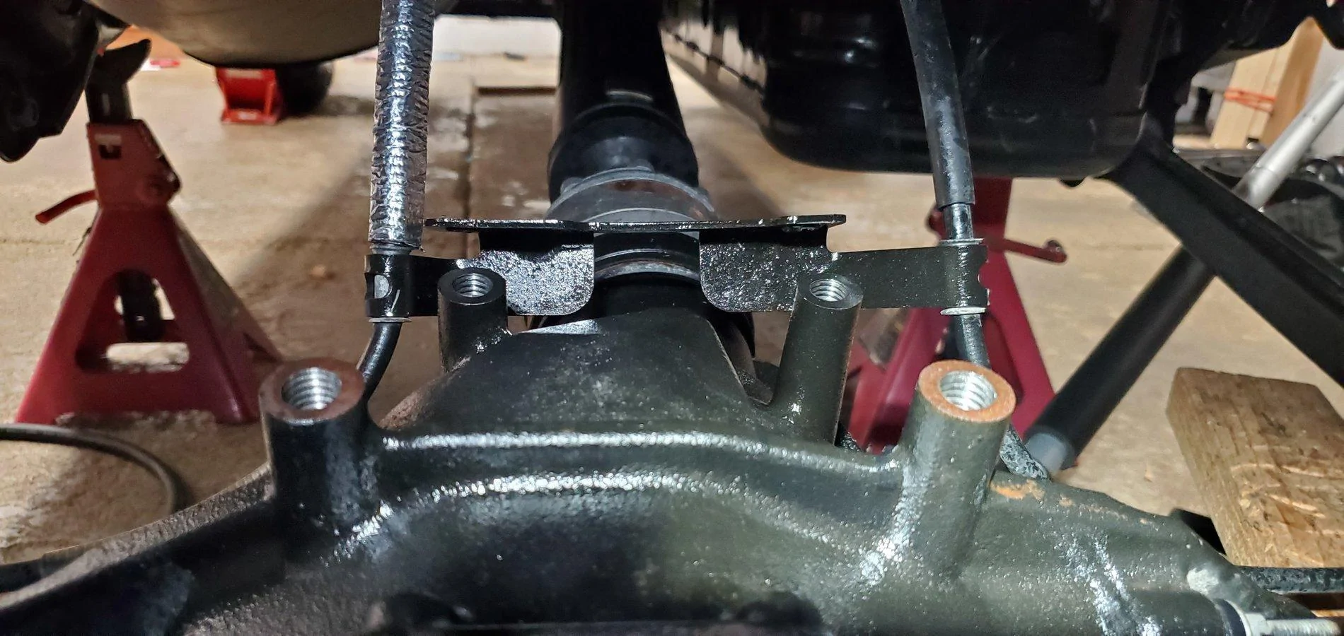

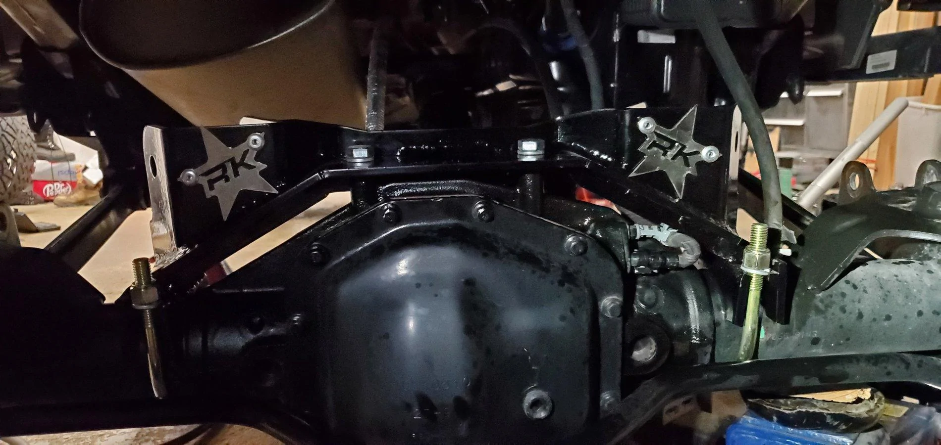

Just got it back from alignment shop. The Rock Krawler kit is amazing, needed almost no adjustments. Just a couple Toe adjustments for the wheels. The setup of their measurements to set the adjustable components to is amazing, drove straight right away and alignment confirms that. Also got the rear 4 link truss welded for extra security.

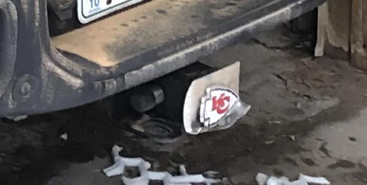

My wife loves them too. Haha. Would nicely compliment the tow receiver damage.

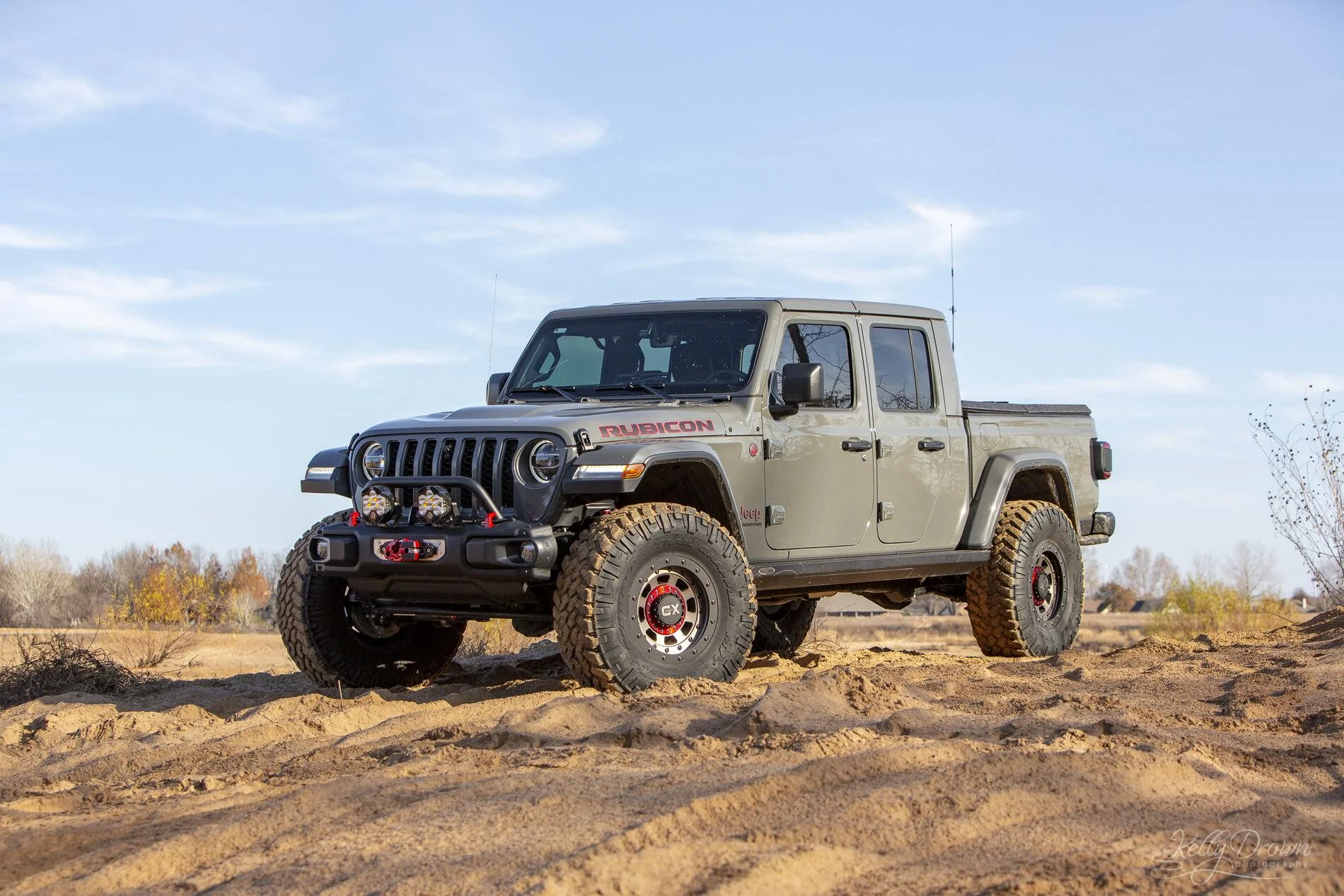

I have had my Gladiator since august of 2019 and I love it. Finally got all the pieces to my lift kit and wheels in. The lift kit and new wheels make it look like a totally different truck and it is awesome. I went with a Rock Krawler 3" Pro-X no limits lift with 37" Nitto Ridge Grapplers and Fuel Covert 17" wheels (not Covid's, nice catch EstoJTR). I did the lift myself with some technical assistance from a friend. I started a Friday evening and was done Sunday night. This thing is a beast now!
