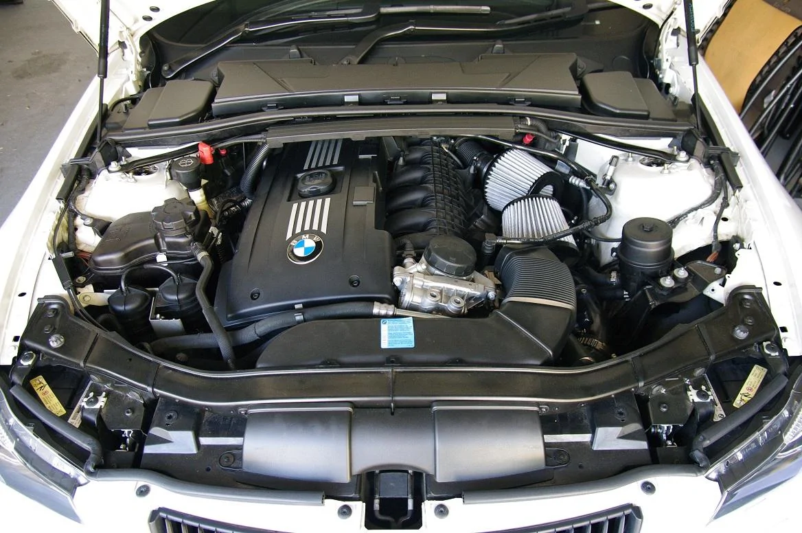

I think we can all agree no matter which way you fall on the fence, the cleaner the filter, the better the airflow. Keep it clean, replace the dry or clean/oil often and you'll be better off.
And please for the Love of God don't get a cone air filter that pulls hot air from the middle of the engine bay.....
