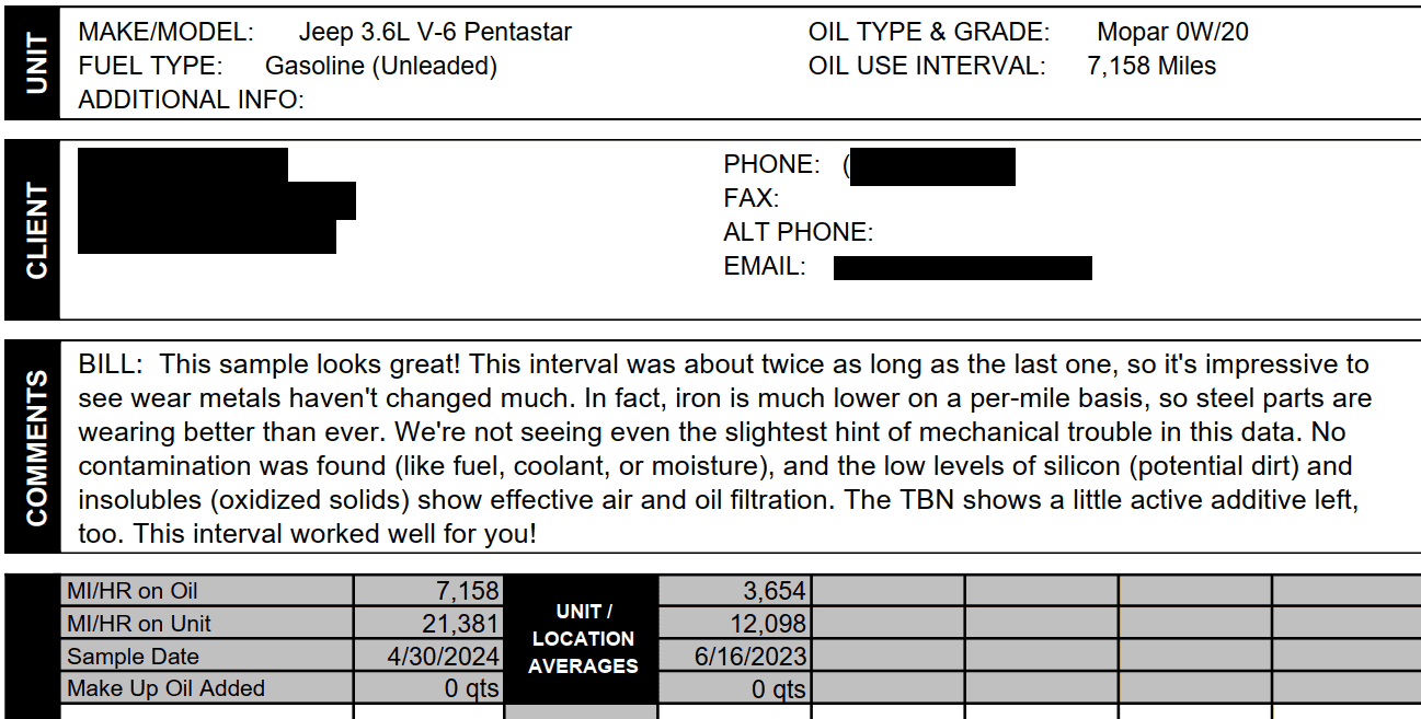

40,463
53,912
Check out below results- time after time I get this sort of result. So, why in the !#$% would I use those filters sold on name alone when the stock filters do a great job?? I don't get the draw to the likes of K&N and so on.
Stock air filter (I keep things checked and make sure filter seals are in place properly), stock MOPAR oil filter, and, gasp, I hesitate to even say it - the recommenced oil.
"This sample looks great!" from the lab.
Why would I mess with such great results?
Jeep Gladiator K & N Oil Filter Screenshot 2024-06-04 225458
(Thanks for not talking about K&N air filters, otherwise I might have to post my test results graphs)
