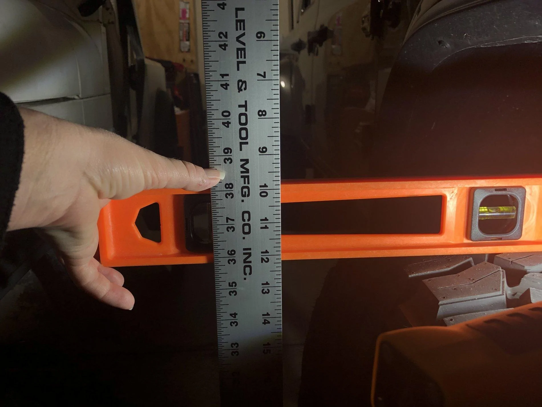

@FLUndertacker if you feel up to it and have time to check real world height once mounted with the 37s, I would appreciate it. I have 35x12.50r17 ridge grapplers on 17x9 and they measure just over 33 inches. Tires are great but I am disappointed in size.
35 7/8” real world on 9.5” wheel. I believe Nitto claimed 36.1”. Sorry for the crappy phono but it was dark when I got home. I will verify over the weekend I was on the highest point of the tire and correct if necessary.

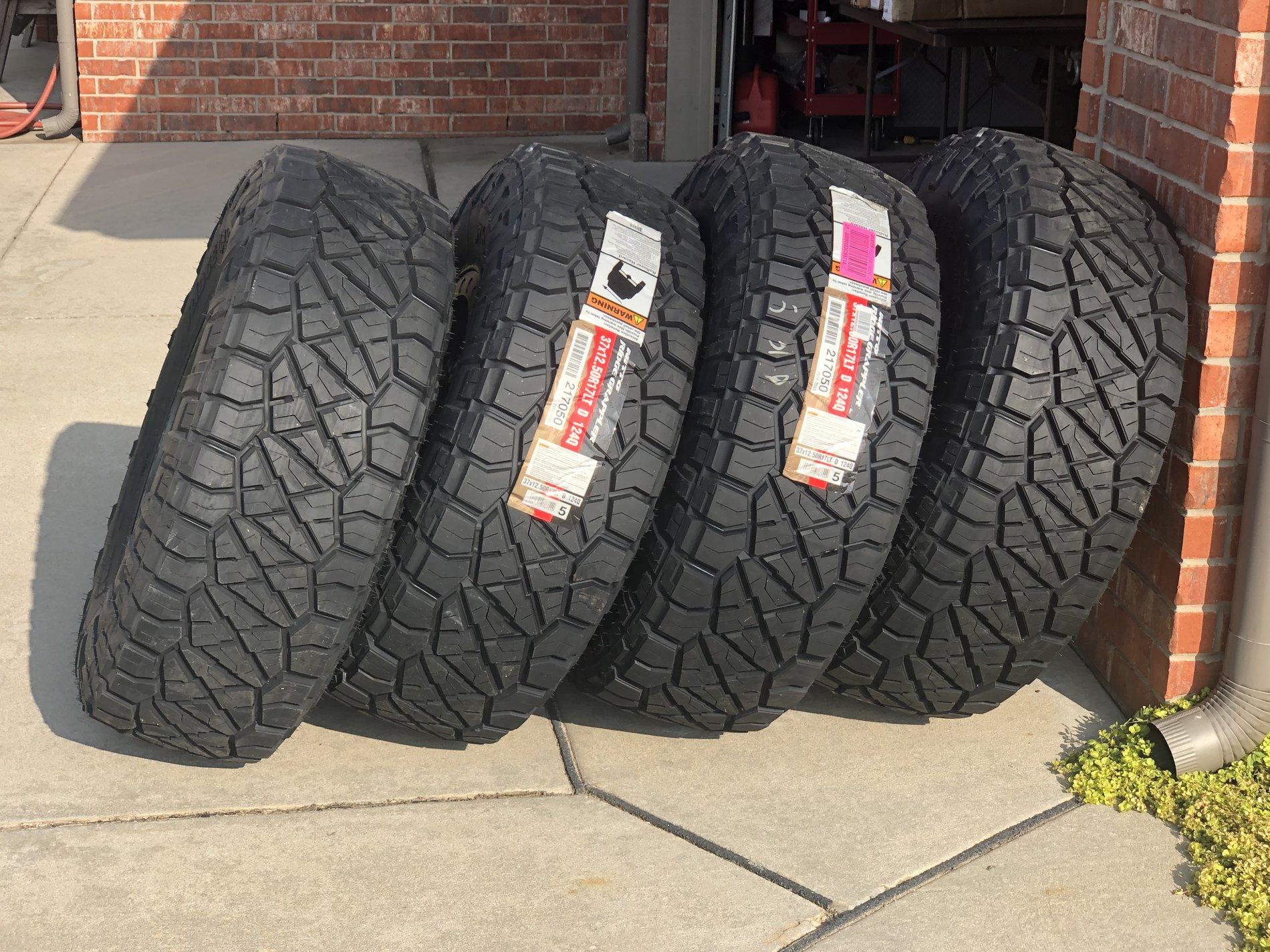

Jeep Gladiator Kanati Trail Hogs, Patagonia MT, and Nitto Ridge Grapplers F352B34E-4089-481C-A25A-9BD7DD65C062
Appreciate you taking the time to do that!
