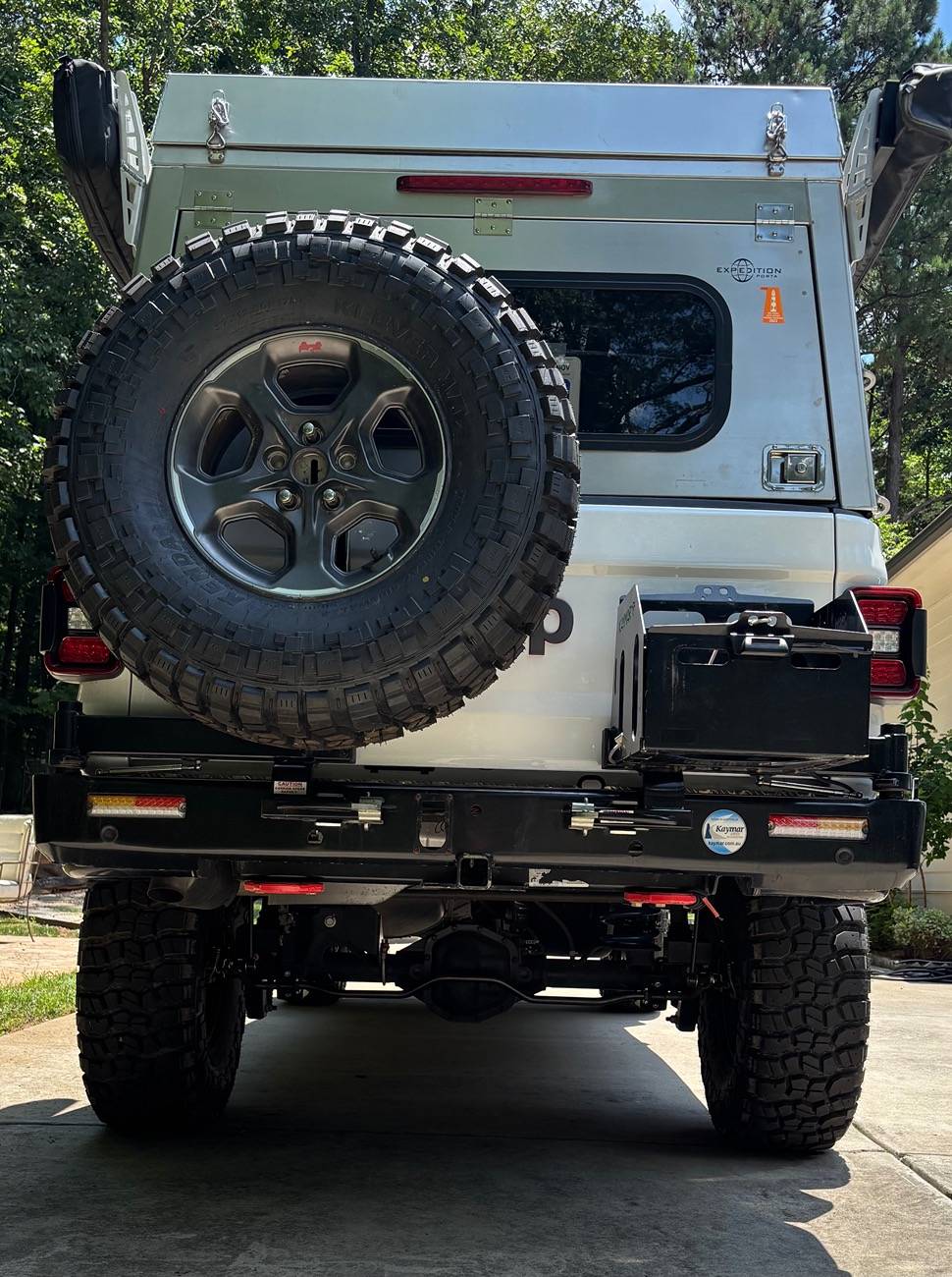

My Gladiator is a 2020 model year. I’m attempting to connect extra lights on my (new to me) Kaymar rear bumper. It has a pair of combo lights, each with a stop / turn / reverse / running light circuit on a separate standalone wire. So, 1 wire for each bulb plus a ground wire - a total of 5 wires each light.
I’m tapping into the OEM Jeep wiring harness that runs to the 6 pin / 4 pin trailer plug-in wiring connector on the rear bumper.
I’ve referenced multiple wiring diagrams and schematics to decode this trailer plug wiring harness. Hopefully I’ve done that properly. Right now I have wires plugged in as follows:

At this point, none of the bulbs in either of the bumper lights are working. Ughhh…
To confirm everything, I tested each wire connection and bulb within each light by plugging each standalone wire directly to the red trailer harness wire for test purposes. Each wire and circuit works as intended, so my connections and bulbs are good.
What am I overlooking and/or not connecting for these lights to not be working? No brake, turn-signal, running, or reverse lights come on (the OEM taillights work fine).
The Kaymar online instruction PDF goes into great detail if you don’t have a trailer light wiring harness. And if you have trailer light harness, it just says “connect them up”. Lol.
The photo below shows the two rectangular lights in the bumper and shows why I’m bothering to hook them up because the swing out arms are covering up both tail lights to some extent.

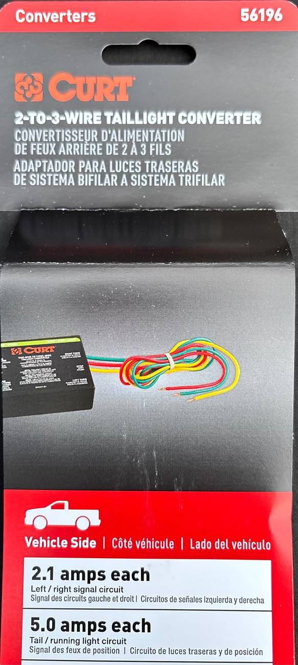

You are going to have issues trying to run a separate amber turn signal because the JT wiring layout uses the brake light as a signal light by pulsing the brake light when the turn signal is on.
Curt makes an 'adapter' for trailers that use a separate turn signal:
https://www.curtmfg.com/part/56196

it might be possible - but then, the adapters like the Curt don't work for LED lighting........

Thank you! It’s likely my Jeep’s LED taillights are the issue.
The adapter that @jac04 linked to…when you look it up on Amazon…in the reviews it shows someone with a similar Kaymar swing out bumper on a LandCruiser that was having the same issue getting the bumper lights to work. Bingo!
Ordered one of these adapters that splits the turn/stop signal into two wires. Fingers crossed this solves it!

PROBLEM SOLVED!!! All the lights are now working properly.
There were two issues:
1) Incorrect electrical signals. The Jeep brake and turn signal are carried by 1 wire on each side. Per the advice of @jac04, I used the Curt Converter #56196 to split the brake/turn signal wire into two separate output wires.
Jeep Gladiator Kaymar Bumper Extra Rear Lights via Trailer Wiring Harness??? IMG_4777
This part solved the problem as the auxiliary brake lights and turn indicators weren’t getting the correct electrical signals. HUGE thank you to @jac04!
2) Wrong diameter T-connectors. Once the Curt Converter was installed only some of the lights worked, but when I bumped the wires the several lights blinked on or off. So, I knew it was the T connectors since I’d already tested the blades on the wires that were being spliced into the Jeep harness. Apparently, I used T connectors one size too large. Duh.
