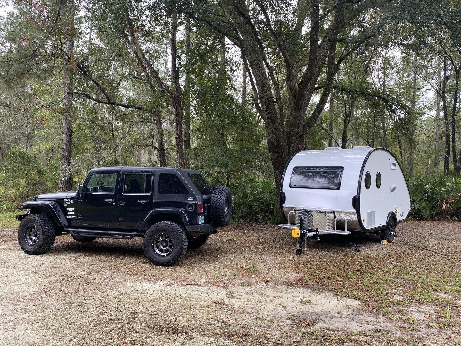

We have a small camper. It's an 18' teardrop, T@B 400 Boondock. It has two 6 volt AGM batteries, 1200 watt inverter, and 190 watt solar panel.
I have heard not to drive with propane on. Is that really a risk? That would solve the fridge problem if it's not anything to worry about.
We store it in the warehouse at my business so it's plugged in all the time. The fridge and food will be cold before we hit the road.
This is the camper, btw. We took it on one local trip behind the Wrangler before the Gladiator arrived. Brake controller will go in the Gladiator next week. Looking forward to taking it out.

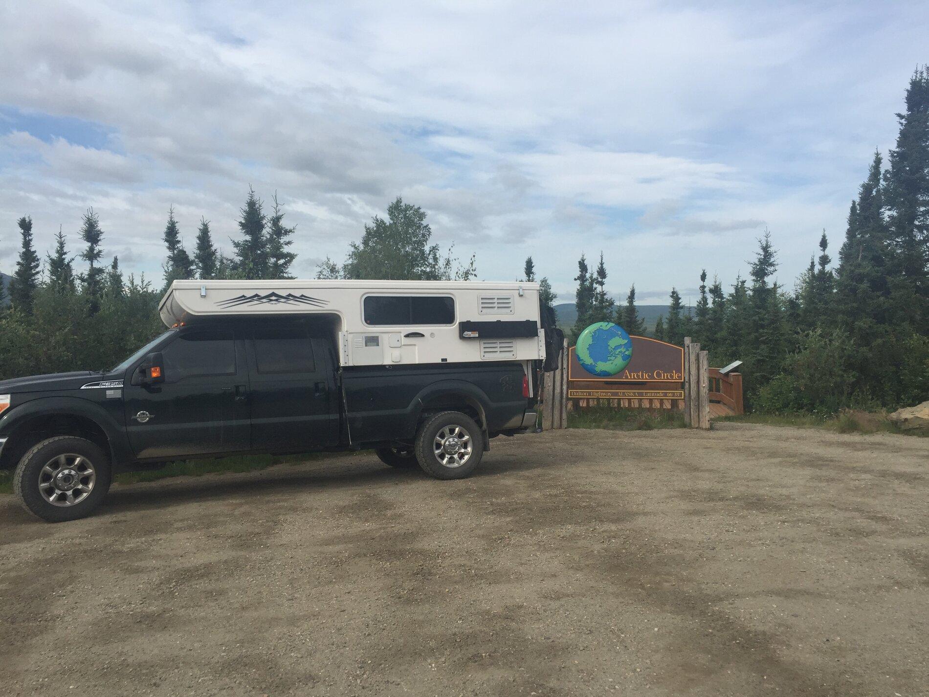

We have a Hallmark Expedition truck camper that I haul around in my F-350 and go on some very long trips. We had the option of a 3 way or 2 way (110 & 12 volt) and opted for the 2 way fridge and we are very glad we did.
‘The fridge is much more efficient and the truck plug will easily keep up with it’s demands while we are driving. I’ve recently upgraded to 2, 100 amp Lithium Phosphate BattleBorn batteries to extend my capacity with the 2, 100 amp Renogy solar panels and it has been bullet proof. We rarely stay at developed campgrounds.
Jeep Gladiator Large alternator in tow package question 5EDFDC9B-E4FE-4A10-8D42-E15674DC31FC

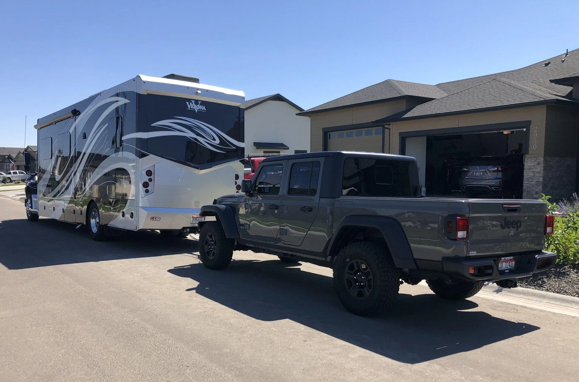

For me, I use a coach and the Jeep gets towed so the gladiator for me won’t need to tow or keep batteries charged up
Again, understanding the limits of your batteries, turning things off when not in use, the freezer packs as mentioned help a ton and are good for you travel cooler instead of ice. I bet with (2) 6 volts golf cart batteries in that trailer you would never worry again. The big 5th wheels and coaches are energy pigs so we are constantly monitoring things. The new 5 panel renergy set up I have is doing pretty good on keeping batteries charged without using the gen. They have a portable/ ground set up as well that works good for smaller trailers and you can set it in the sun if your under a tree canopy
coffee pots and microwave we always run the gen as they draw batteries down to much
Jeep Gladiator Large alternator in tow package question DA0939B7-0B04-4C39-8DE3-CF8A9CC1D9AB
