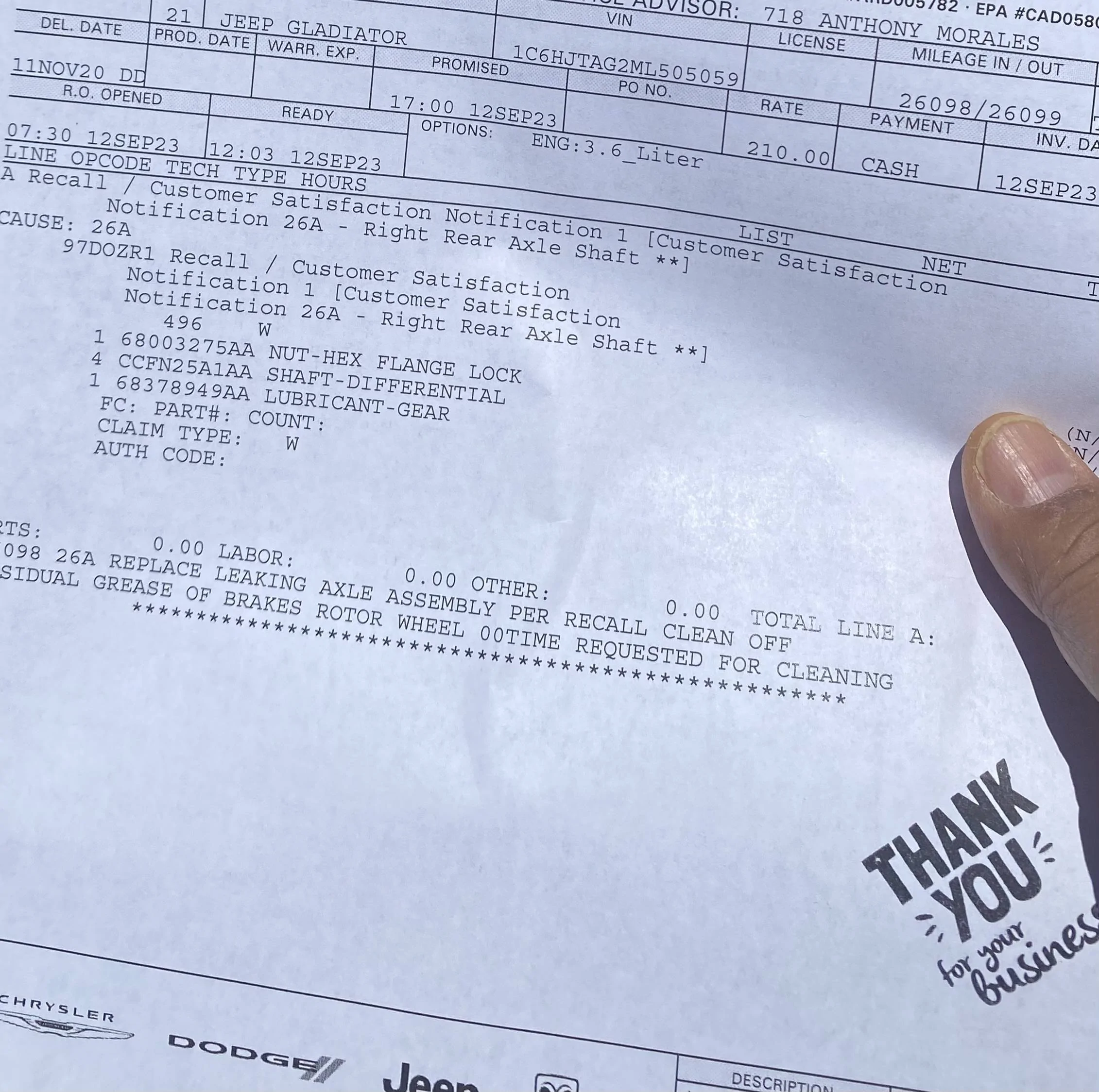

Just got mine done today. Took 3 hrs. I did an oil change 2 weeks ago and they inspected and ordered the part. Dropped it this morning and they called me before lunch. They change the axle shaft.

Did you get a recall notice? My delivery date and VIN aren't far off of yours. All I got was a new seal.

Yes! I did got a recall notice in the mail. That's why I got them to check if its leaking when I had my oil change. I checked myself and its leaking a little. I thought they will just do the seal but just realized after that they change the shaft.
