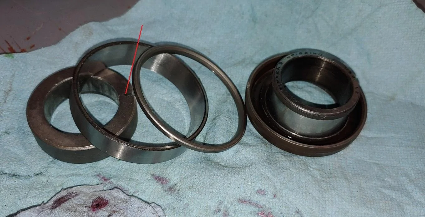

Interesting and short video of a DIYer changing the seal, bearing and retainer on an earlier D44. Sure seems like any self respecting service department mechanic would be able to tackle this job. I wouldn't be afraid to do it if I had a press. At least I know what I'm in for after my JT is out of warranty.
40,461
53,902
POC (piece of cake). I've done dozens, maybe hundreds, of axle bearings, seals, whatever. Most recently in the Dana under my 04 WJ
You don't need a press.
You carefully cut the retainer with a torch (now I use a Dremel with a wheel), and do similar with the bearing.
A long piece of pipe acts like a slide-hammer to install the new bearing and retainer.
I got so good with a torch I could cut bearings off and not scar the axle, I could cut exhaust pipes and not even turn the other pipe too hot, not even nick it with the torch.
Red line points to where I split the retainer, I knocked the cage off then split the bearing itself, everything pretty much fell off. That ring is part of the bearing cut that literally BROKE off!
I have a press and use a press to remove the bearings on some axles and cut them off others.
