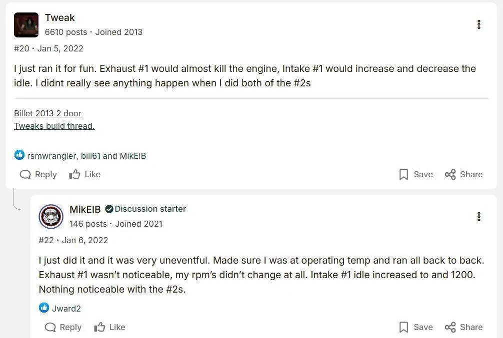

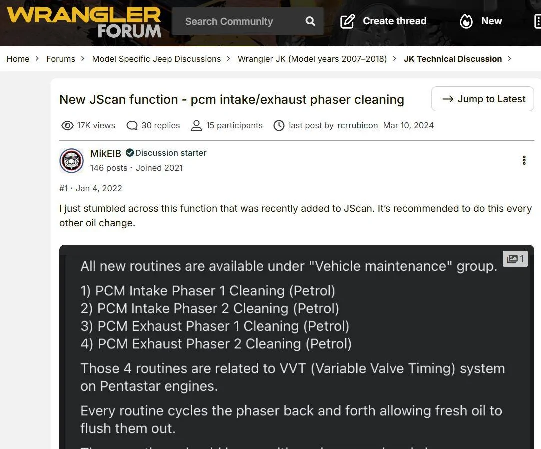

That's odd because on the JSCAN FB pages, Jeep owners talk of doing this sort of thing all the time and it's in their documentation.
The transmission module relearn doesn't need any license - I've found posts where people have done that after some large changes or issues with harsh or poor shifting.
there's a lot you can do without a "license". It's not unlike running the cooling fan through a check cycle which is how I keep my JT HVAC working and the engine cooled with the plow on, while on the highway. It's actually a test process.
All that the phaser cleaning does is run them back and forth, forcing oil in and out.
I ran across the JSCAN module reset functions, as well as the TCM relearn while scouting out other things like increasing idle speed while winching, that sort of thing.
Jeep Gladiator Left in drive and turned engine off. 1742578520551-6l

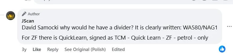

I'm not sure exactly how it works, but there's also a function in there to tell the ACC to relearn/adapt!
The only reason I'd see a need for any license is if you were leaving the firewall connected, not bypassed, and using the standard OBD port.
Jeep Gladiator Left in drive and turned engine off. 1742578972700-sq
EDIT - AlfaOBD will do the transmission control module relearn. Ran across talk of that in the Dodge forums, and other places.
