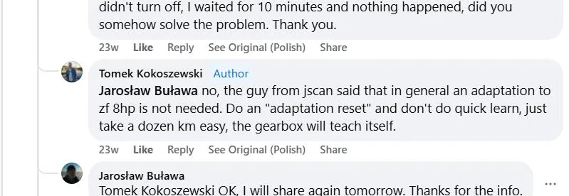

So in layman's term for Shadetree mechanical dummies like me that only have ever dealt with nuts and bolts . What exactly are those gear heads saying right there .
40,442
53,860
Don't do the quick relearn but do the adaptation reset function.
That clears out what it has "learned" and forces it to start learning again as you drive.
Apparently the quick relearn is something different (I've never used that) and you have to jump through some other hoops to make it learn.
but clearing the adaptation using the reset function is like putting in a TCM that hasn't learned how to act yet.
I've seen it in JSCAN but have never used it as my automatic actually behaves quite nicely.
What can I say that made so much more sense to me reading your response 😂
Thanks again.
Edit: I downloaded JScan and played around with the app in Demo mode till I figured out where that Adaptive Values Relearn was. No to purchase cables and VIN license when I am ready.
There was 3 of them in there a quick relearn Long version , Quick Relearn Short version , and Adaptive Values relearn for when transmission has been rebuilt it says.
Which If it is either new or slightly used out of another Gladiator I am figure the adaptive Values relearn is the proper thing to do.
