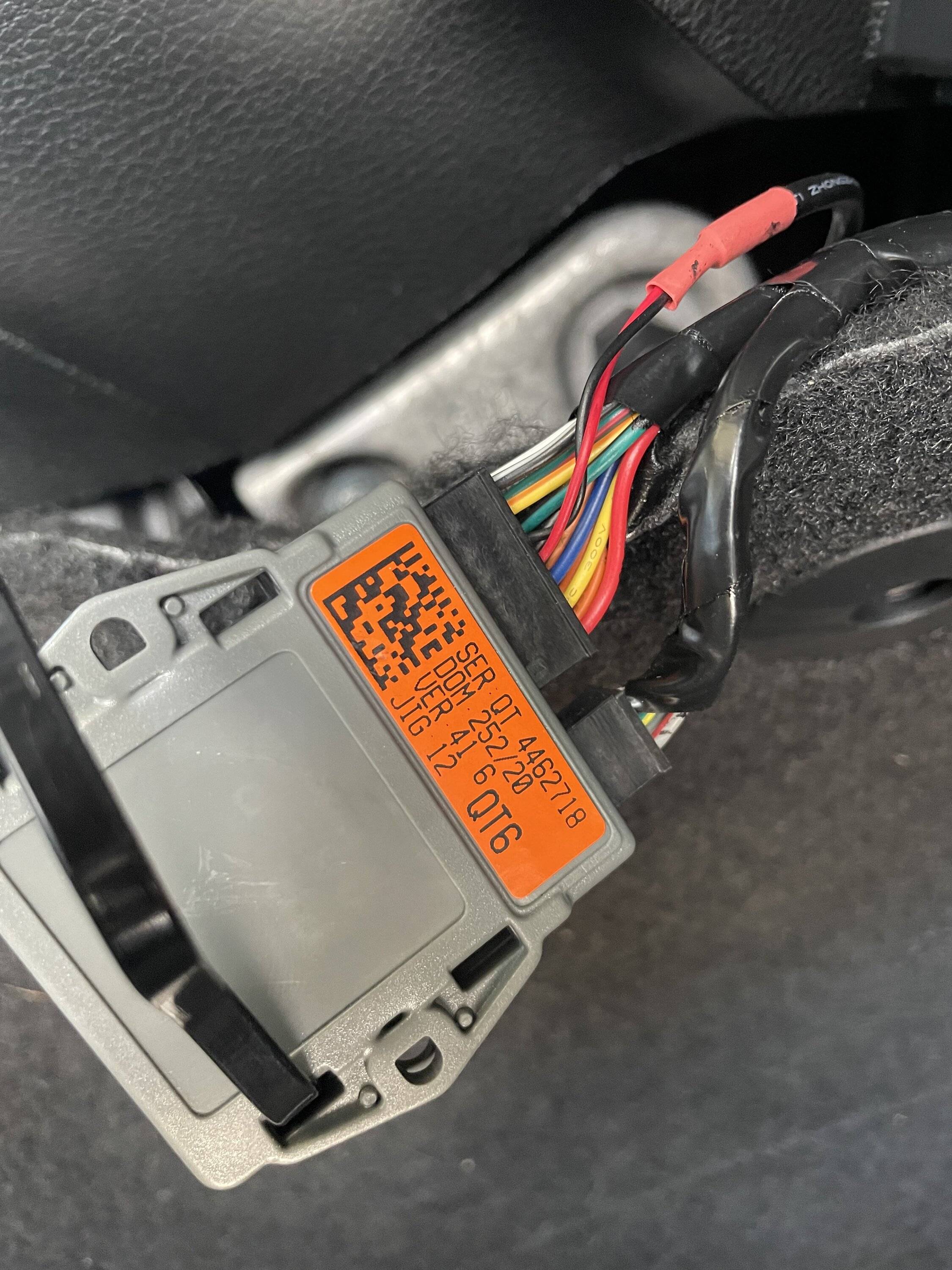

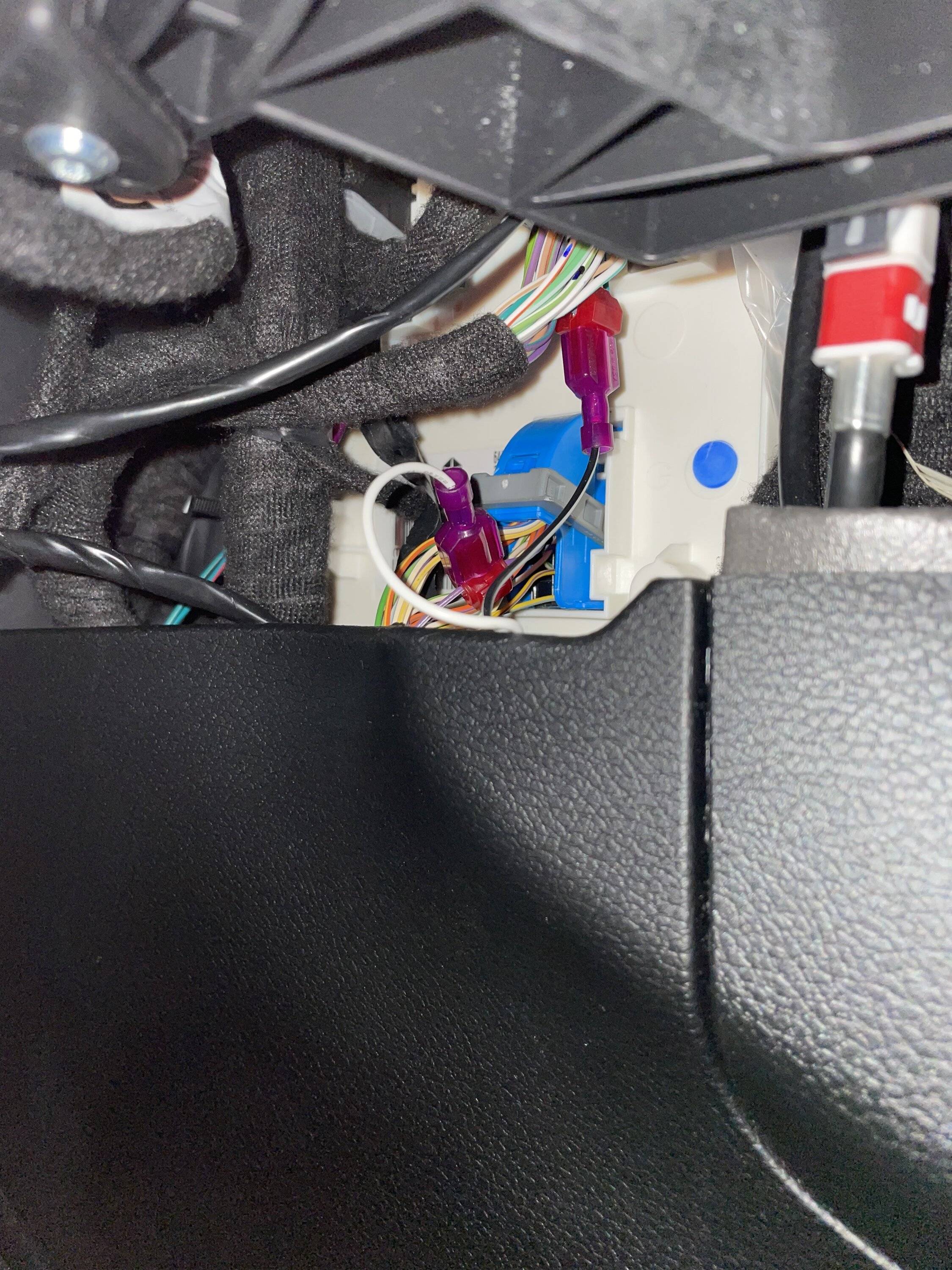

Guys after going through everything mentioned and more. I looked around and found a dealer installed security device. It's pretty crudly slapped together with electrical tape and cuts and slices in my factory wiring. So I’m not touching it. Given that it is designed to prevent starting it could absolutely be the problem. Taking it in. I’ll let you know.

Mine looks like this guys....A freaking 50k truck and they do this to it!

IT
It could just be a GPS track that taps 12v from the OBDII connector.... take pics

Man, I'd be flipping pissed if the dealer cut into the factory harness.
I'd definitely give them a call, I wouldn't touch anything else.

Oooo Ouch. that last picture?? Wire taps on the harness - not good. Lots of people do that but those are worse than junk IMO. I would be super pissed and asking why this happened on a brand new truck - unless there is high theft in the area that dealership is located.
But IMO - dealer should be liable for replacing the entire harness

Been reading that it is really common now. They are afraid of cars getting boosted off the lot. Could be the source of most of our electrical problems on our Gladiators.
I totally understand that coming from their perspective, but IMO that is not an excuse. When we are spending 50-60 or more K on these trucks, and they hammer people hard for aftermarket accessories, then this should absolutely not ever happen. I just hope you can get it covered under warranty
