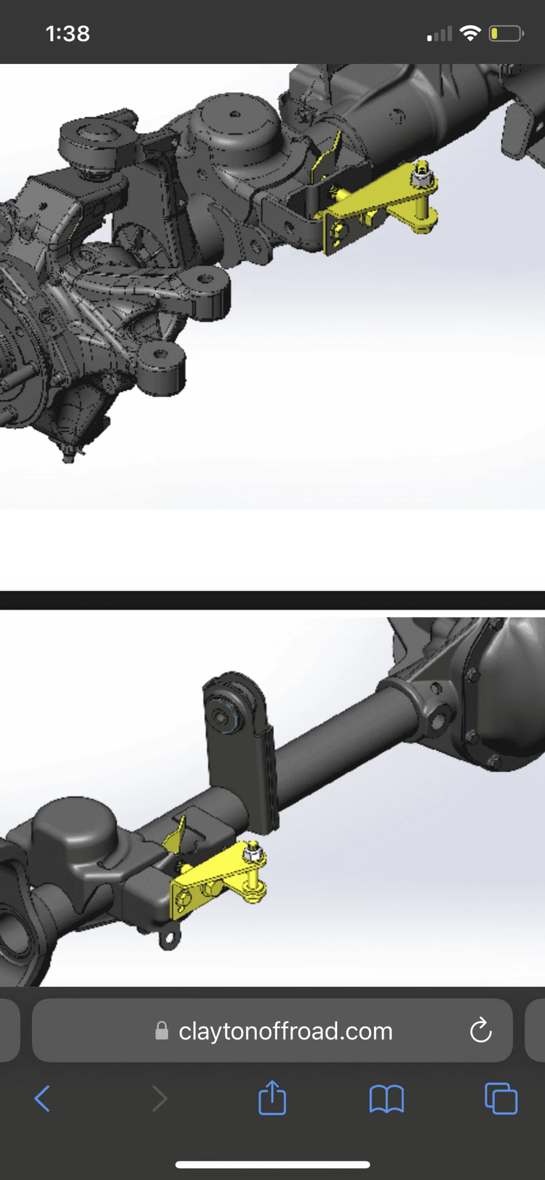

There are comparable double shear vertical mounts from Metalcloak, Clayton, and SteerSmarts. I believe all three require drilling into the axle to stabilize the bracket.

Clayton as usual has a quality mount.
Jeep Gladiator Let’s talk Steering Stabilizer Relocation Brackets F8E6681D-231F-49DB-86D8-7009137551FF
Metalcloak and Clayton raise the stabilizer mount a little above the track bar bolt, so higher than the synergy and TMR bolts would.
SteerSmarts is as usual the most expensive option. It is a vertical mount that is fairly in line with the track bar bolt and not raised. The downside is that it pushes the stabilizer closer to the differential.

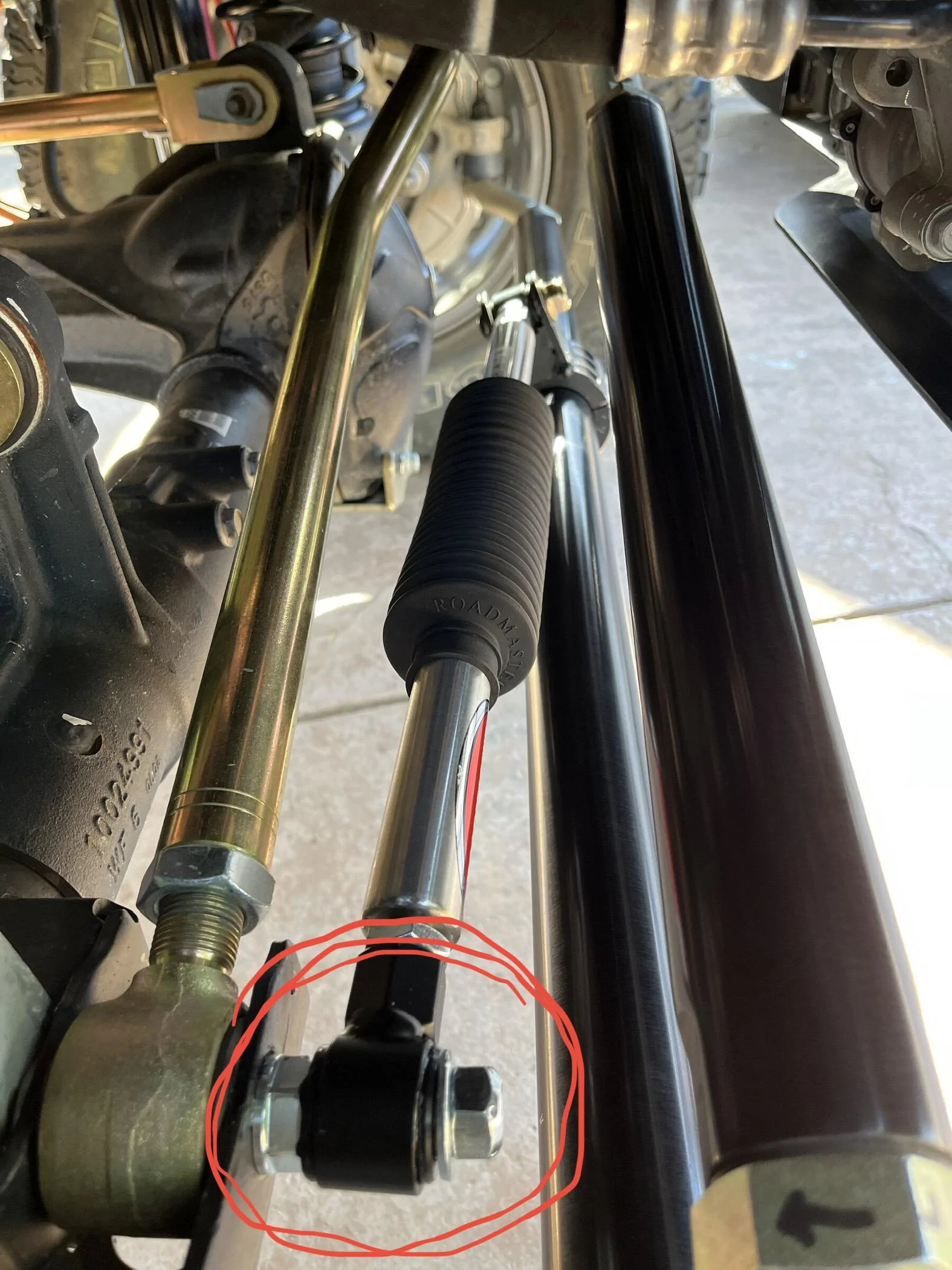

This is a pic from the ExactCenter thread:
Jeep Gladiator Let’s talk Steering Stabilizer Relocation Brackets 5B012C91-3860-406A-A32A-B1CC9048F5D5
That looks like it’s binding the SS bushing pretty good, whether that matters or not. But it seems like a vertical mount would fix this.
Another picture shows this is pretty even with the tie rod horizontally, which again probably depends on which tie rod mount is used.
Is this a long-term issue? I had my stabilizer relocated with the Clayton bracket, and a Synergy clamp that is causing the stabilizer to be at an angle that is causing the bushing to bind.
As far as I can tell, no, and I haven’t seen anyone else post pictures of stabilizer bushings failing.
