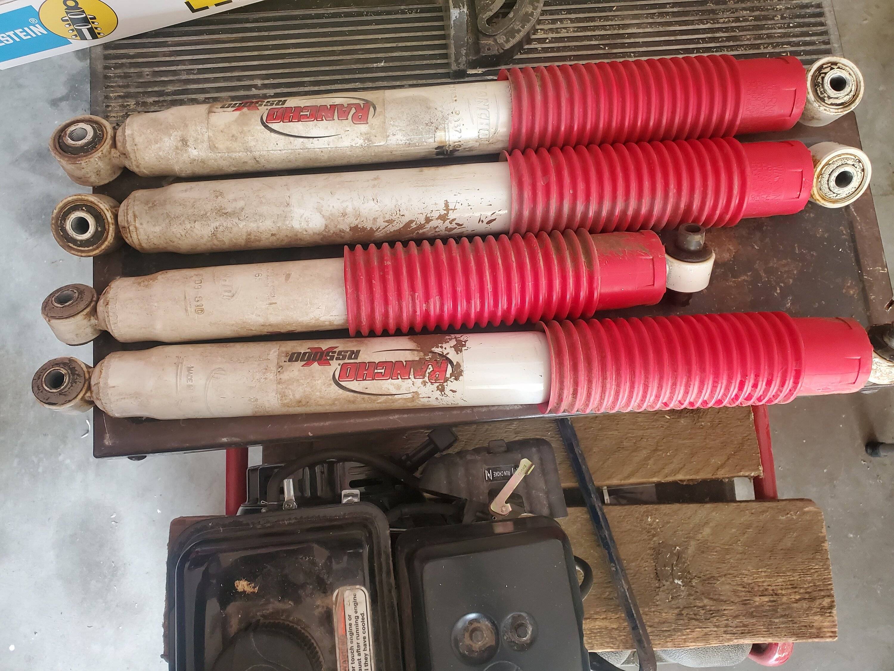

These are rs5000x with less than 7000 miles. Pretty sure anyone can tell all is not ok. Rancho I'm sure would replace it. But I replaced them with Bilstien 5100 instead. I went with the ranchos originally cause the level it kit came with them. The rancho springs drop brackets and track bar I used is nice stuff, and have no complaints.

Springs handle the weight fine, shocks just can’t handle the rebound pressures. I have heard great things about the RS9000 on the JL side of the house.
But how did they ride? Honestly look like every steel body shock after a few months. My TJ has some unknown aged Zone shocks and the paint is all but gone. But still dampen fine.

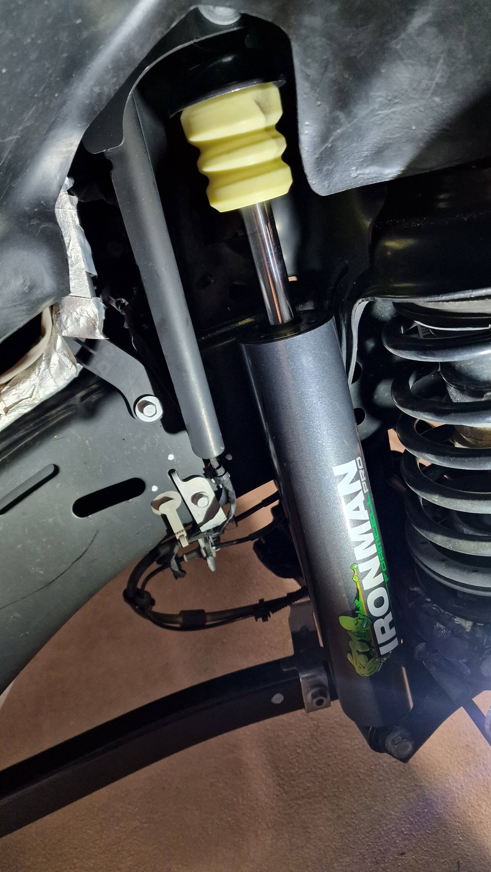

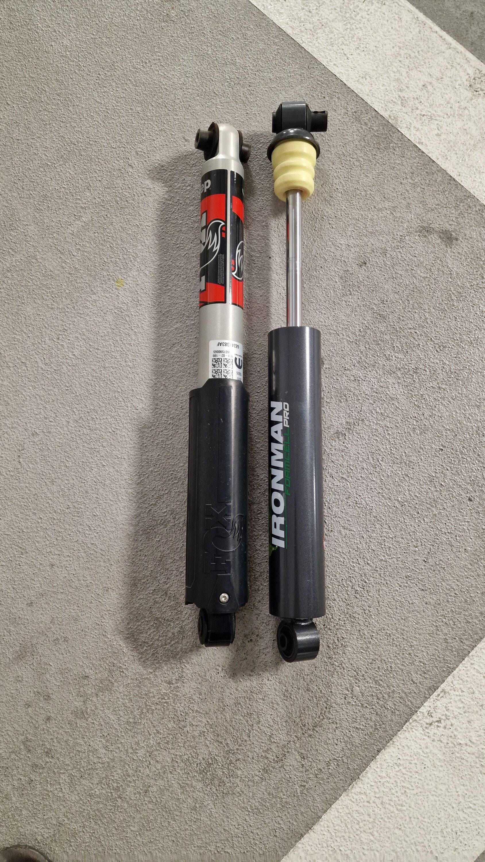

I was very disillusioned with my Rubicon 'pogo-edition' shocks and looked long and hard for a cost-effective alternative out here in the Middle East. In the end I went with the Ironman Foam Cell Pro for $730 for all 4 and fitted them myself.
The shocks are not well known but they are stocked in the US. They are hugely robust and have real weight to them. They are unpressurized and re-buildable (at home).
I love them, every aspect of suspension performance has improved from slow speed ramps (no more head waggle) to road comfort and improved cornering to rock crawling and bashing the sand dunes here. Mine are 'comfort' valving and genuinely could not be happier.
Foam Cell Pro Shocks (ironman4x4america.com)

Pollo
They felt fine at first but soft. Then something felt off, can't really explain it but felt like I had an unusual amount of bump steer and a vibration in the front right. Had the tires rebalanced and no change. Pulled the shock off and it seems to have no gas charge left in it. The shafts on the others still sprang back the one did not, and honestly they looked like crap. Changed to Bilstein 5100 and couldn't be happier.
