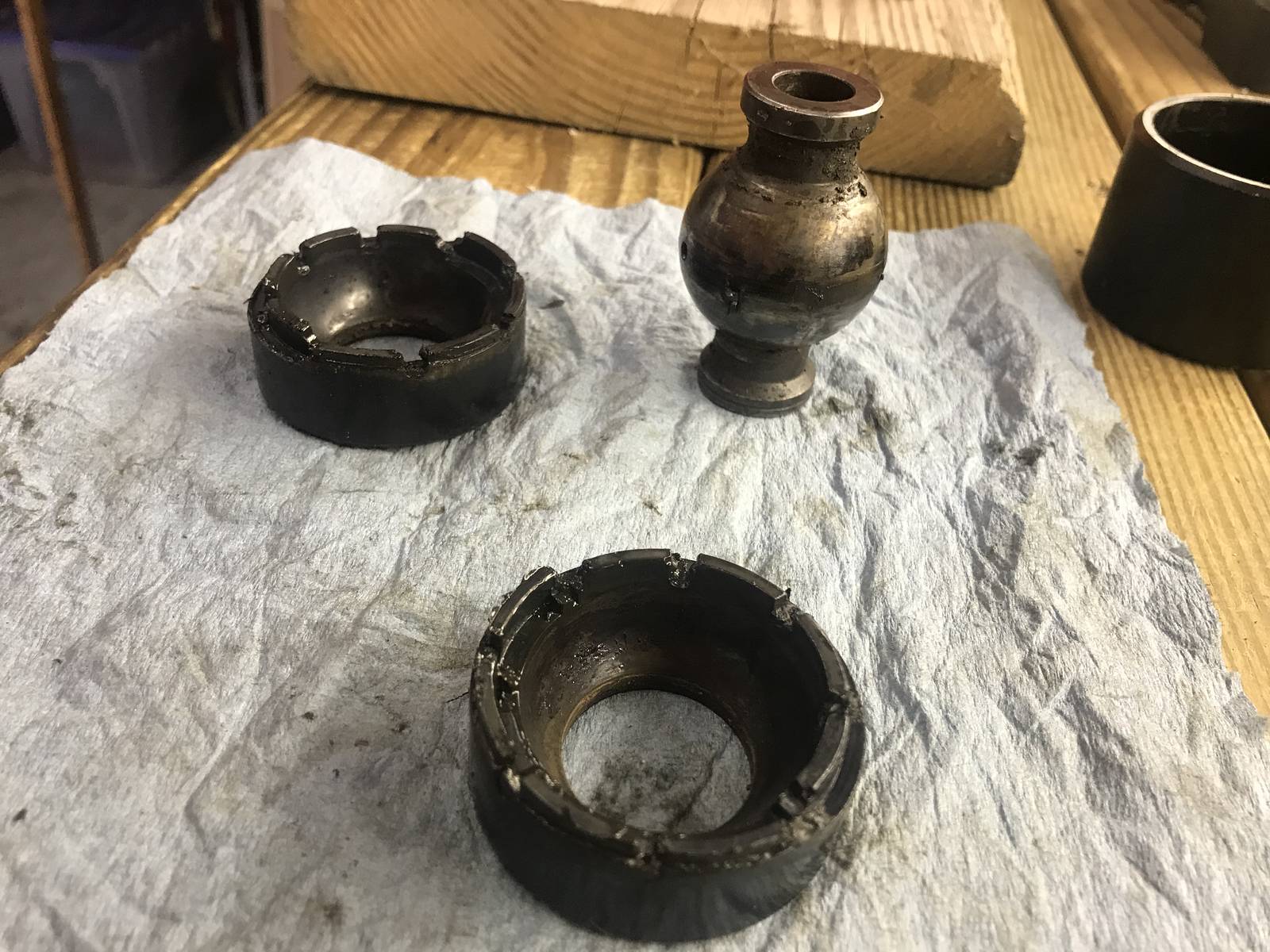

After 50k miles on my front evo track bar I had to replace its bushings, they both were loose. I switched to a Clayton’s rear bar for the bend in it and it pops every now and then. I just got replacement bushings for it.
long story short check your junk cuz after 50 k miles my bushings were shot from to quality manufactures
